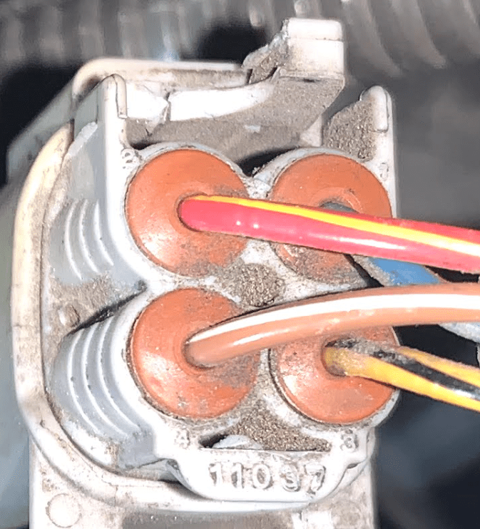

Is there anyone who knows the part number for the marked connector in the image? It is 2000 LC. Please help me to look for its PN. Thanks in advance.

Correct. 'Most' Toyota connectors will have a number on them (the suffix) and by adding the prefix number '90980' you can usually find the replacement part. This doesn't hold true for ALL connectors....but for the vast majority.

I am not sure what this connector is for, but found out its PN: 11037. So, its PN would be 90980-11037???
As you can see, it is partially broken. Actually I tried several times to pull it out, but it is kind of stuck there.
It seems I don't have to replace it urgently, but I am thinking to replace all brittle plastic connectors.
Yep - that’s the correct part number.
Interesting- where does the prefix number come from? Is this only useful for connectors or other parts on a 100 series as well? Are there other prefix numbers for other parts types?

To my knowledge, the electrical connectors are the only items with partial part numbers on them.
