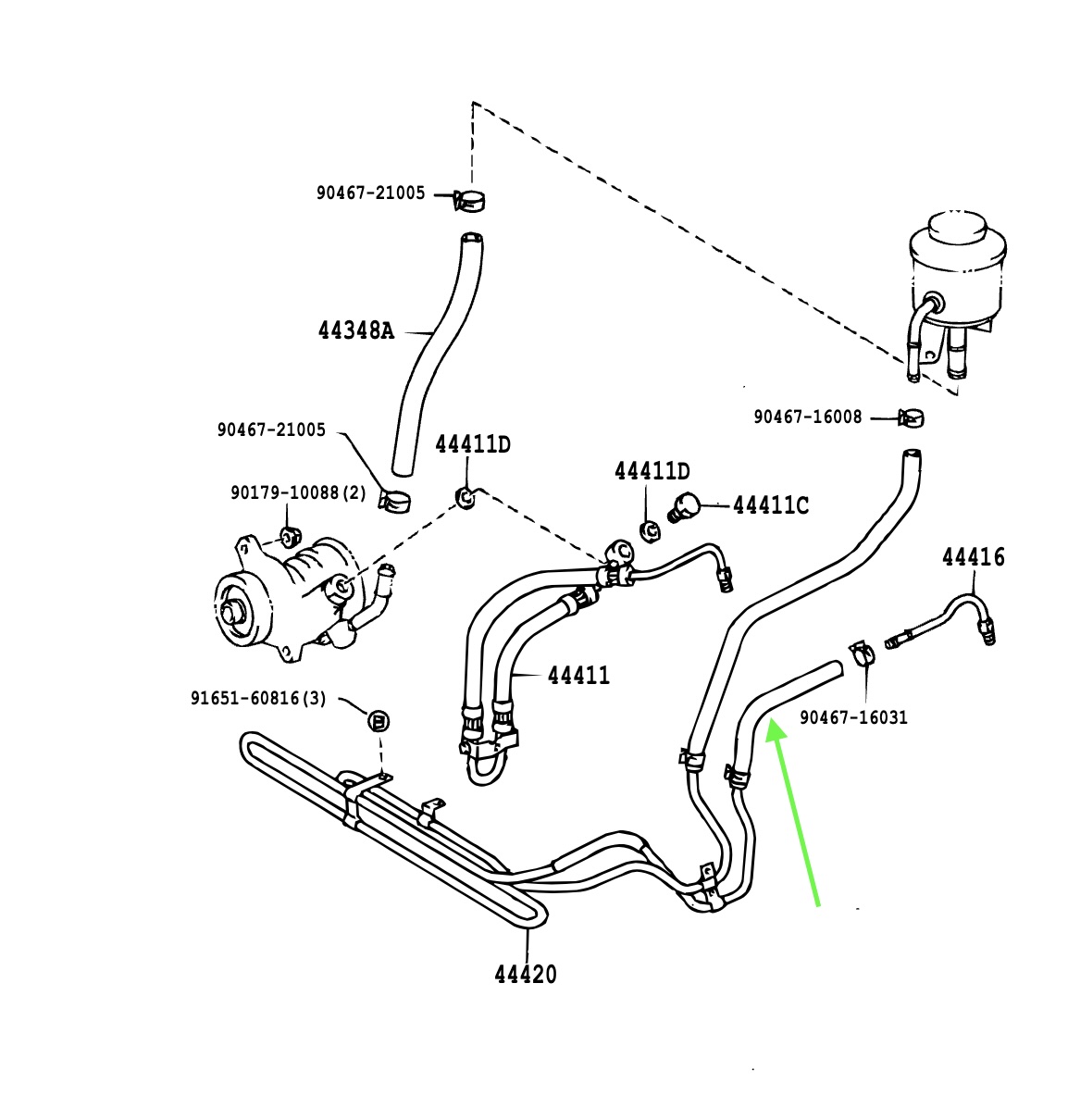

Can anyone provide a part # I can order to replace just this piece of the power steering system, and not the entire cooling portion?
See attached picture.
Thanks
Chad
Those hoses are not available anymore. Most guys buy some 3/8 hose and replace.
The 3/8 is a tight fit, I used a heat gun to heat up the end and lubed with atf and it slid on easy. You will need new clamps the OD is smaller.
