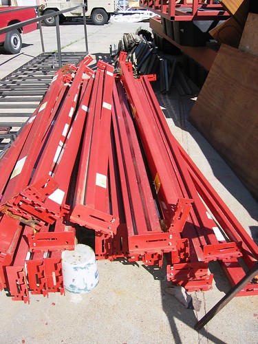

I scored some new warehouse pallet racking.
I now have 8 - 12' uprights (44" wide) and 16 - 8' horizontal beams and 12 - 4' horizontal beams. (I really want 24 - 10' beams so everything fits in my garage perfectly.)
Instead of using pallets, I planned on using 1/2 plywood for the "shelf" portion. I do not want the plywood sagging in a year or so due to the constant weight.
What do you guys use between the beams to support the 1/2" plywood?
I'm thinking about some Oak firing strips or maybe some 1"x2" .065 tubing.
Feel free to post up what you have done.

I use 2" x 6" boards laid flat space around 16" apart to put under plywood.

are you talking about across the width? Mine has little metal triangles that go in. I seem to remember 2 or 3 per shelf. you can see them in post # 3 of this thread, under the wire mesh of the orange rack.
You will love this stuff.. not any fun to move but you can stack tranny's etc on it. I think i used 3/4 ply sheets on mine. I measured the depth of the notch.
To remove those triangle braces just grab em and twist. Might call a warehouse supply that's local see if they have those, probably safer to use than planks. course could have the planks lying around already.

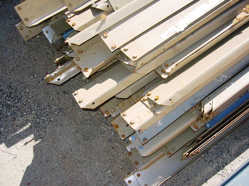

Dan - If you need/want anymore horizontals, Dave is selling these for $5 each. Let me know....

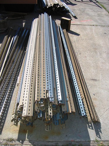

He also has a ton of these:
He's selling them for $30 each (the four uprights, 3 shelves and the fiberboard (4x8 sheets) for the shelves....he has, like, 100 of them....literally....
