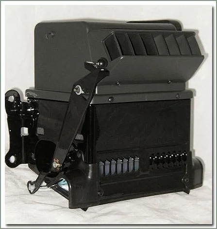

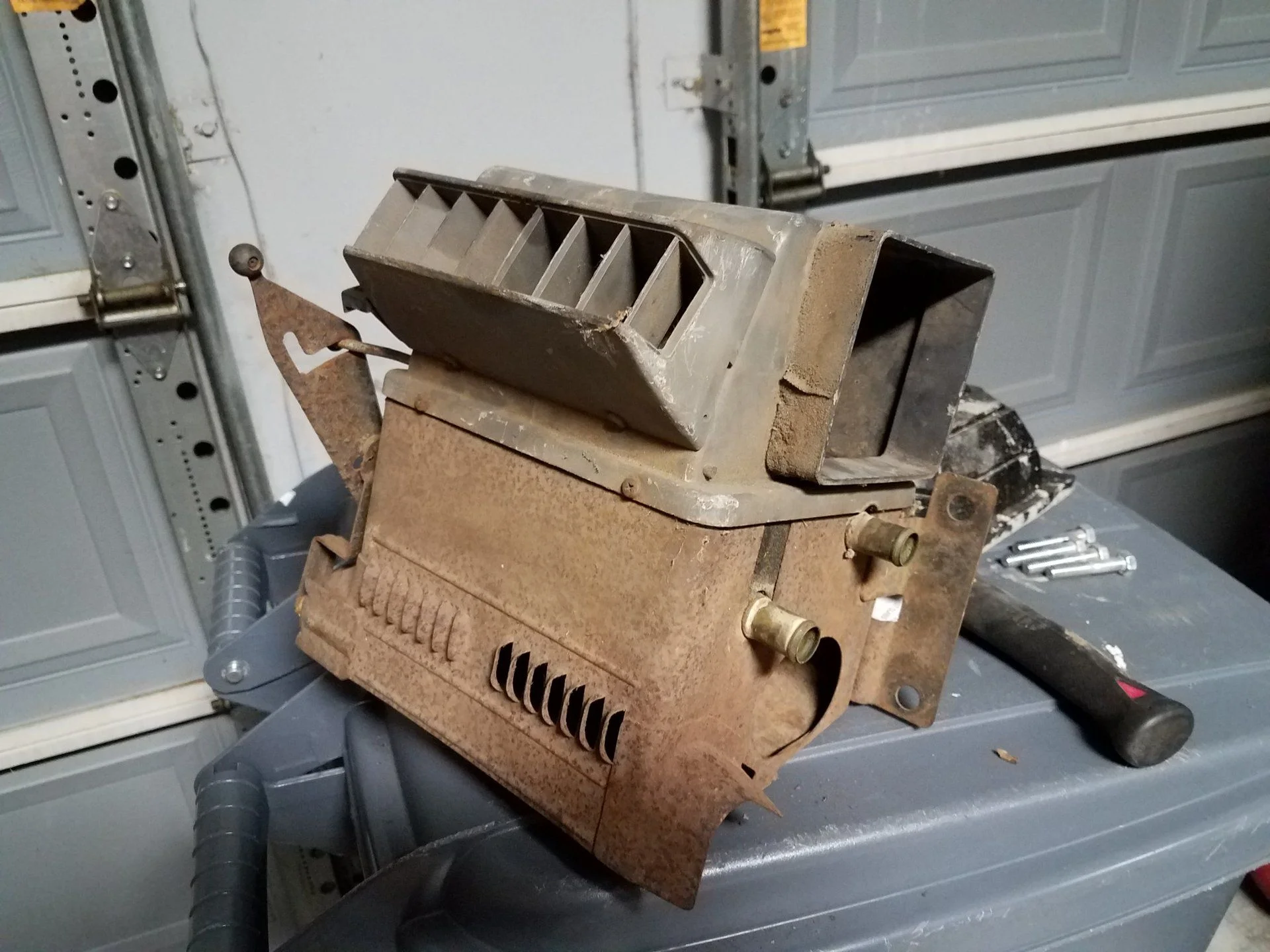

Like to have my old heater refurbished and repainted. Will show before and what i want after. I'm in the Atlanta area but would not mind shipping around the southeast if not to far

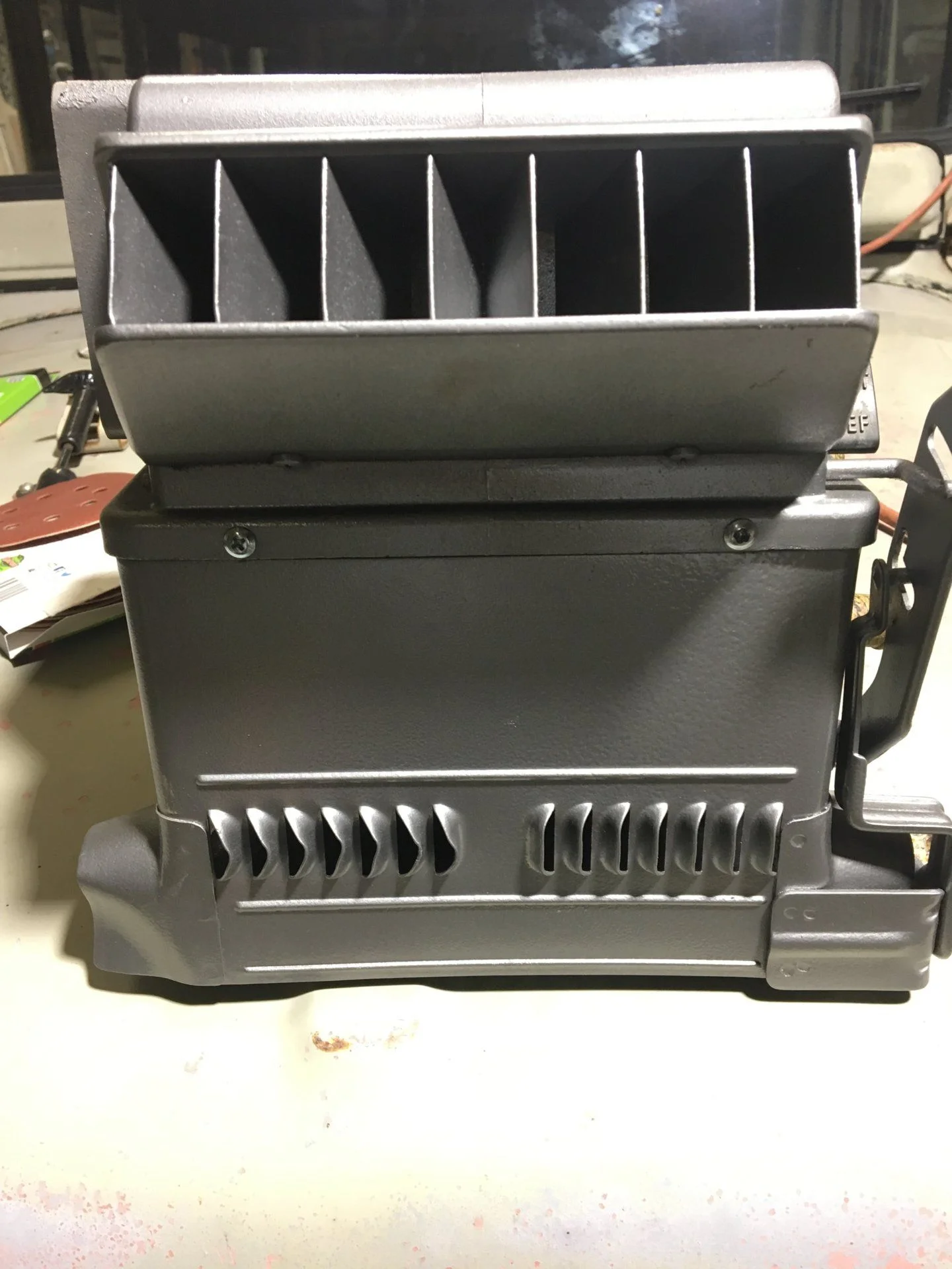

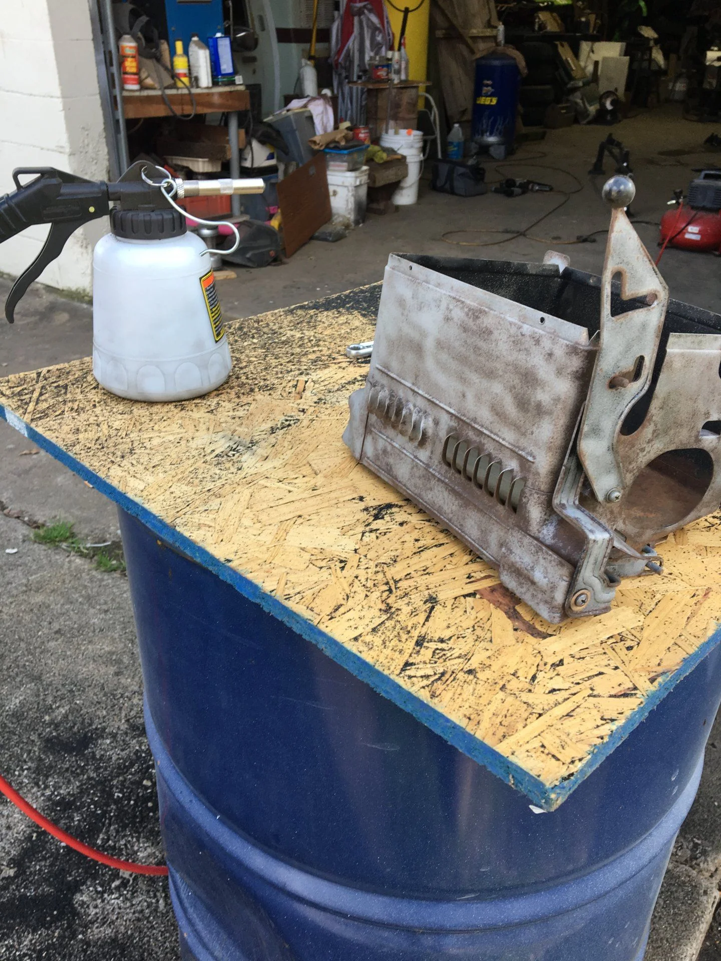

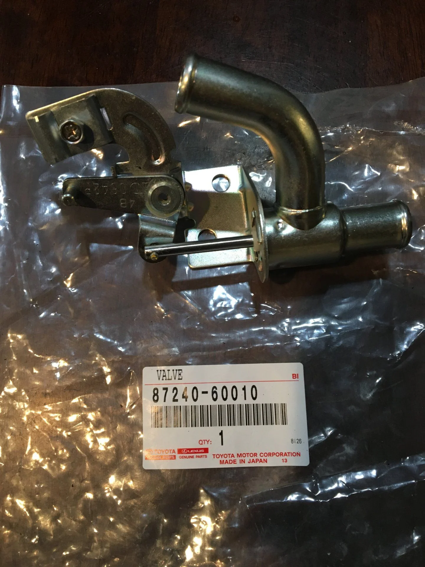

I just acid flushed my heater core then sandblasted my box and painted with rustoleum hammered finish dark galvanized. Also replaced the Heater Water Control Valve
Swimming pool acid from Lowes or Home Depot . Filled the core 3/4 full of acid and shook it for 2 min. Repeat.
Flushed with clean water until no more rusty water. Heater works like a dream now
