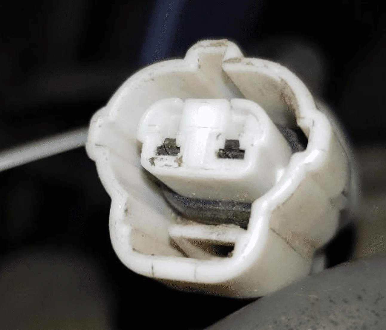

What I found was a loose connector and connector corrosion:

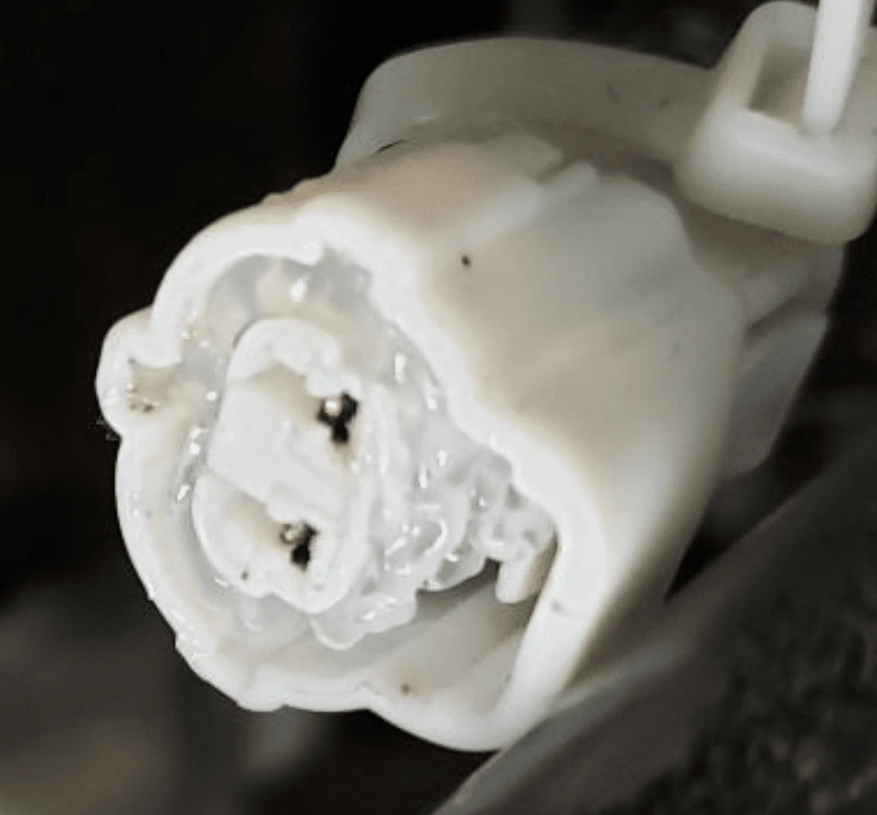

For 99 LC in the U.S., this sensor is located on the oil pipe (look above the front propeller shaft). I replaced the sensor but wanted to make sure the connector corrosion didn't happen again. I soaked the connector in PB Blaster for 30 minutes and soaked it again in contact cleaner to thoroughly remove any traces of PB Blaster. A little scrapping with a small screwdriver, and the connector contacts were much better. I added some dielectric grease to seal the connector:

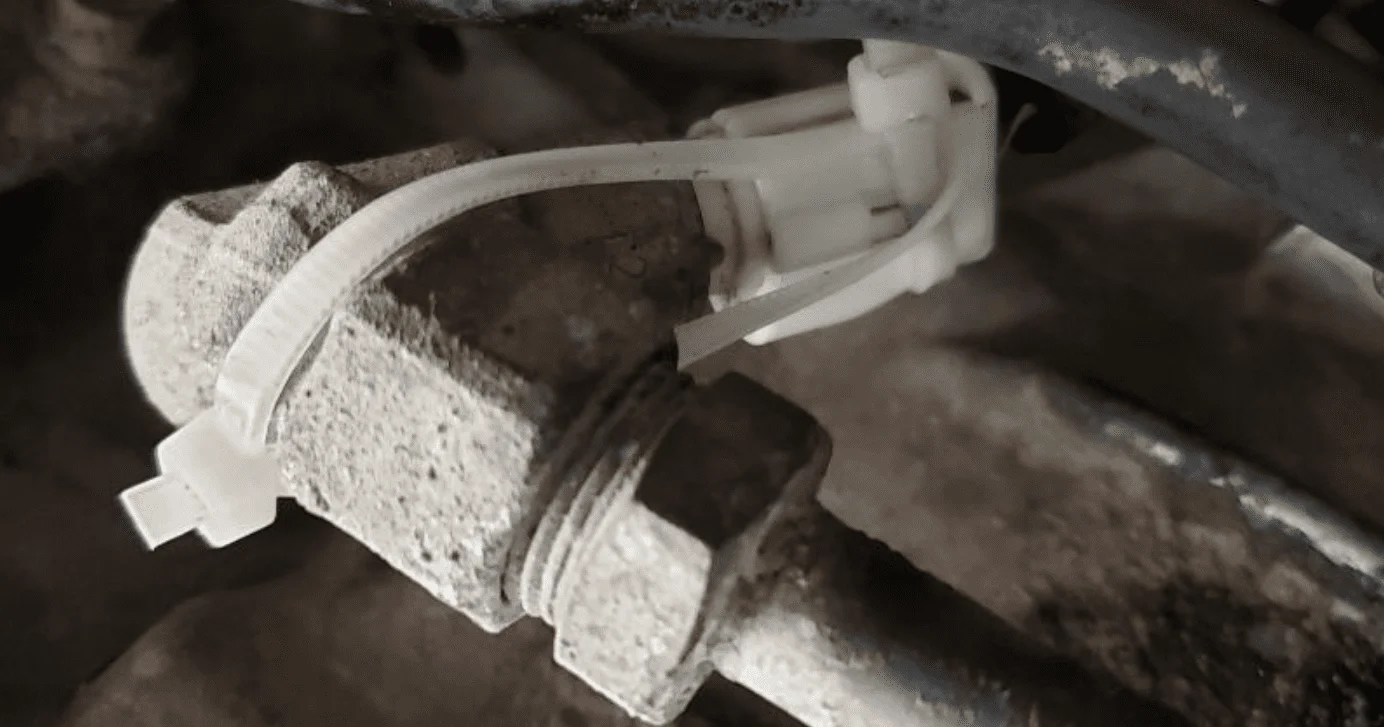

Okay, here's where my true paranoia begins to shine. Even though the connector made a nice click and everything appeared okay, I added a "belt and suspender" arrangement of wire ties to make sure this connector stays in place. Not overly tight, just enough to keep this from backing out again. This connector is in a bad place for exposure to road salt, etc., so hopefully this will keep it from repeating in the future:
