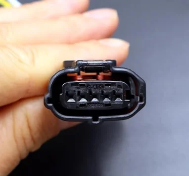

The MAF pigtail plug clip was broken. The previous owner had taped the clip to the MAF body. It worked until it didn't. However, the plug was tight, and holding it made no difference.
Searching for this issue revealed the Bank 2 O2 sensor may be at play. Since this GX is new to me with 250,000 miles, I ordered a set of new Denso O2 sensors. Those are part of my usual midlife refresh.
I will keep the post updated with progress updates.

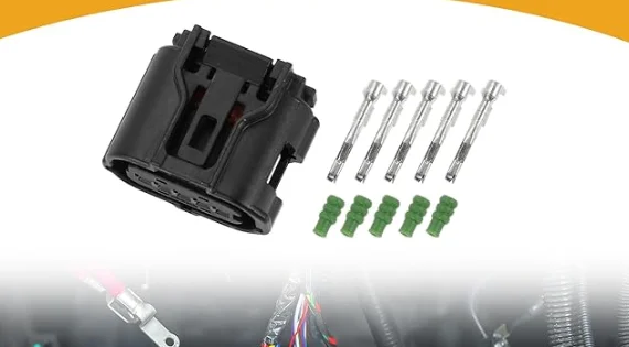

Last-minute fix items ordered. Two types of MAF plugs. One of these should work. Part No:
90980-12292 for 5-wire.​
