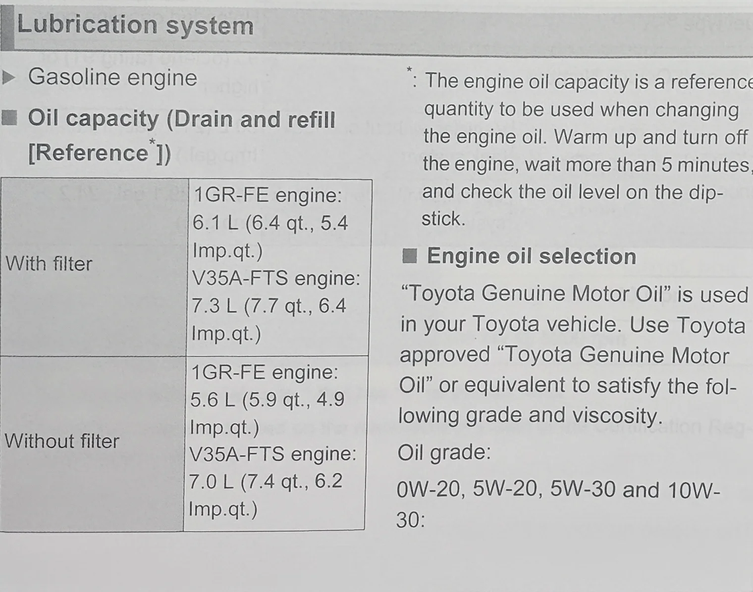

Hi all
Now that the 700h is being sold in other warm weather markets like UAE i really want to know if they require 0w-20.
5w-30 is an acceptable weight in other markets based on their owner's manuals.

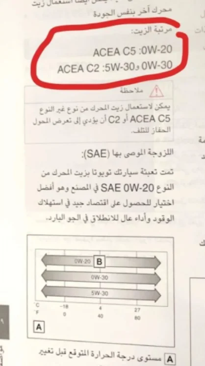

Per GCC manual, below us the recommended viscosity options:
  • 0W-20
  • 5W-30
  • 0W-30.
If you can make it work, 0w-30 mobile 1 Euro formula is about the best oil on the market and readily available.
