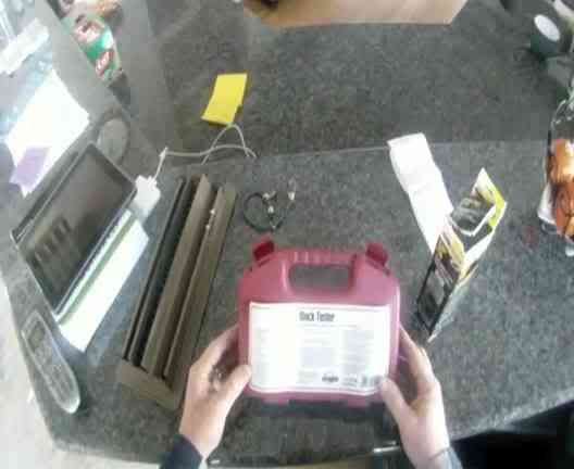

Going out to do the head/block test I found in another thread. I got the "kit" from Autozone's loaner program (with ~$30 deposit). Will post results in a few...
Thanks guys for the support.
Sorry for the delay in reporting the results of the test. I had to run to work and am playing with my video camera.
YouTube - engine block test
I performed the test twice. The first time, I didn't remove enough coolant and some must have been sucked into the tube. The may be an "F-bomb" or two during the video, sorry.
Second time, milked the bulb for almost 4 min, no contamination. The test makes a lot of sense to me, is easy to perform and cost nothing but a deposit with Autozone (got full refund when I returned the kit).
Relieved that the test was negative, back to the task at hand and further troubleshooting...

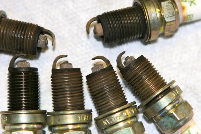

Plugs do not perform well for that 100K though. The computer compensates for their deteriation as time passes. When this happens fuel mileage and performance declines. Changing plugs is easy and a relatively cheap way to maintain your engines performance as well as fuel economy. I generally go 15-20K between plug changes.
As a follow up, here are pics of the iridium plugs that I changed in the 100 series at 100k miles. They still gap .040", so it looks like the iridium plugs do perform well for 100k. In my opinion they are worth the extra money unless you like changing plugs 3 times versus once in 100k. Also, the taper on the tip is like that new, it is not wear.
Nice pics Clint, they do appear to be in decent shape for 100k.
