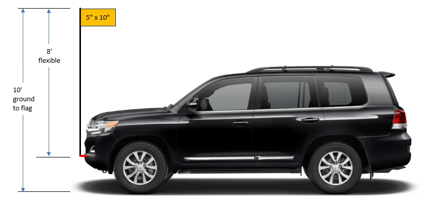

Many off road parks or recreation areas require safety flags, sometimes called whip or dune flags. Requirements vary park to park and state to state, but generally seem to require:
A) 10’ height, a portion (say 8’) of which is flexible.
B) Mounted to front most point on vehicle.

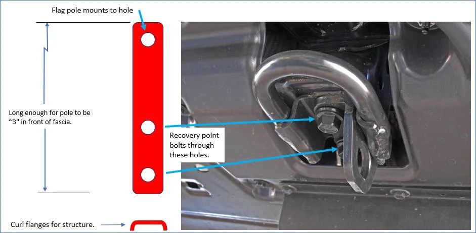

Question: for those with OEM bumpers, how are people mounting your flags? I envision some sort of bracket mounted to the recovery point bolts, like this:
However, the thought of a wimpy bracket as the first point of contact - and reducing approach angle - is a bit disconcerting.
That’s what I do. Make sure the bracket is long enough to avoid having the flag bend back into the bumper. And definitely remove when off the dunes. It’s a shin ripper.
