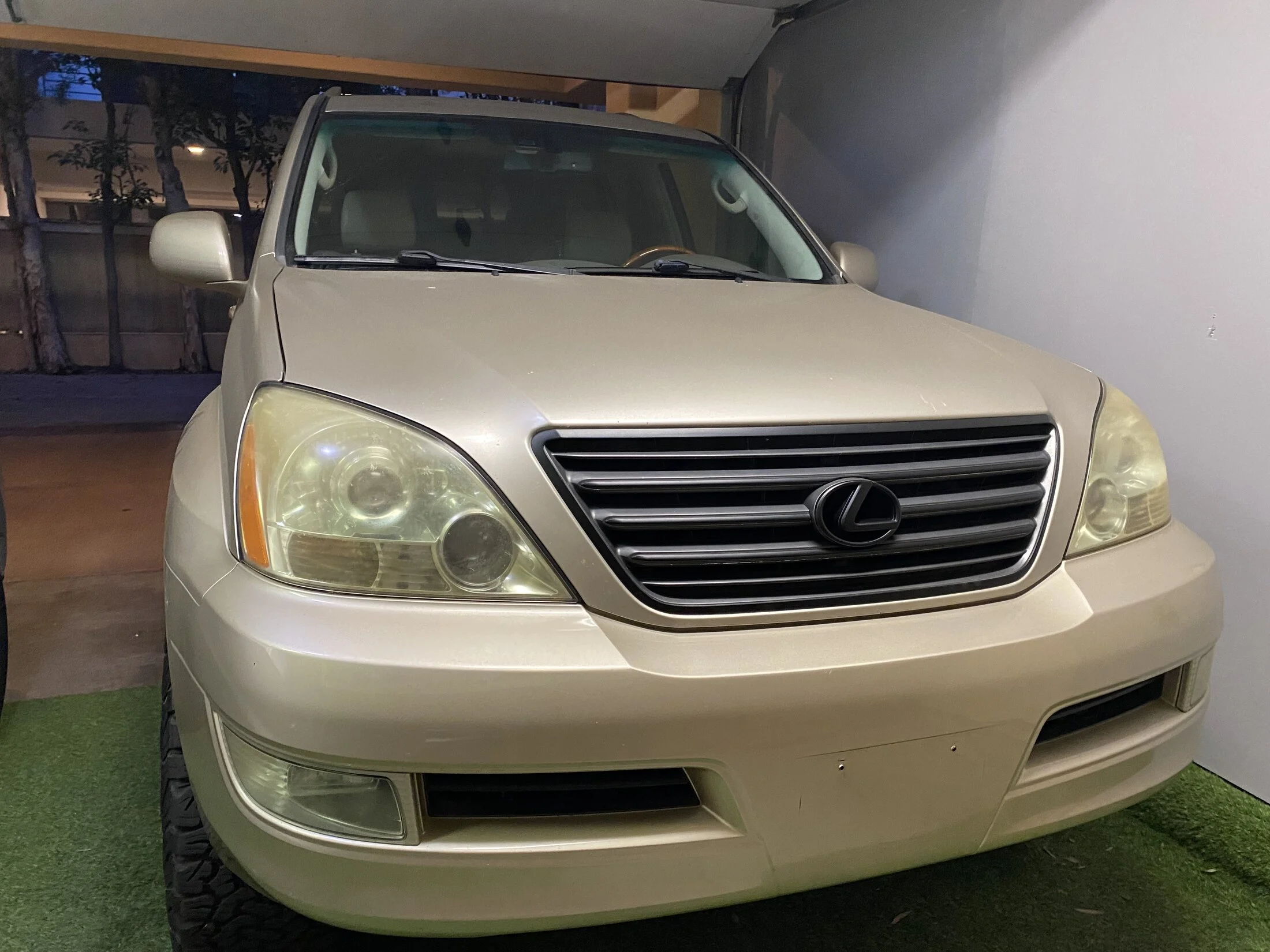

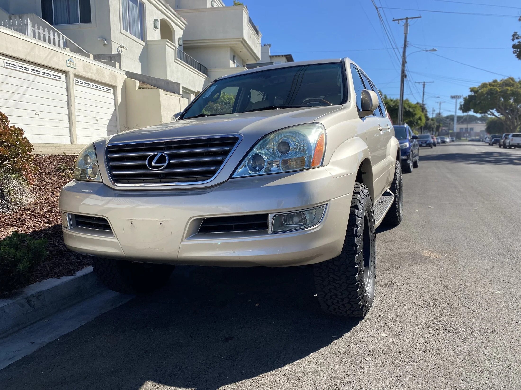

I purchased my GX in November of 2020 in full pandemic price swings. I had a very demanding job position at the time so I wanted something trail ready to start adventuring. If I went back and did things over I would certainly buy a stock rig and make my own modifications. I've actually had to go back and change things over time since they didn't suit my taste. As they say, hindsight is 20/20.

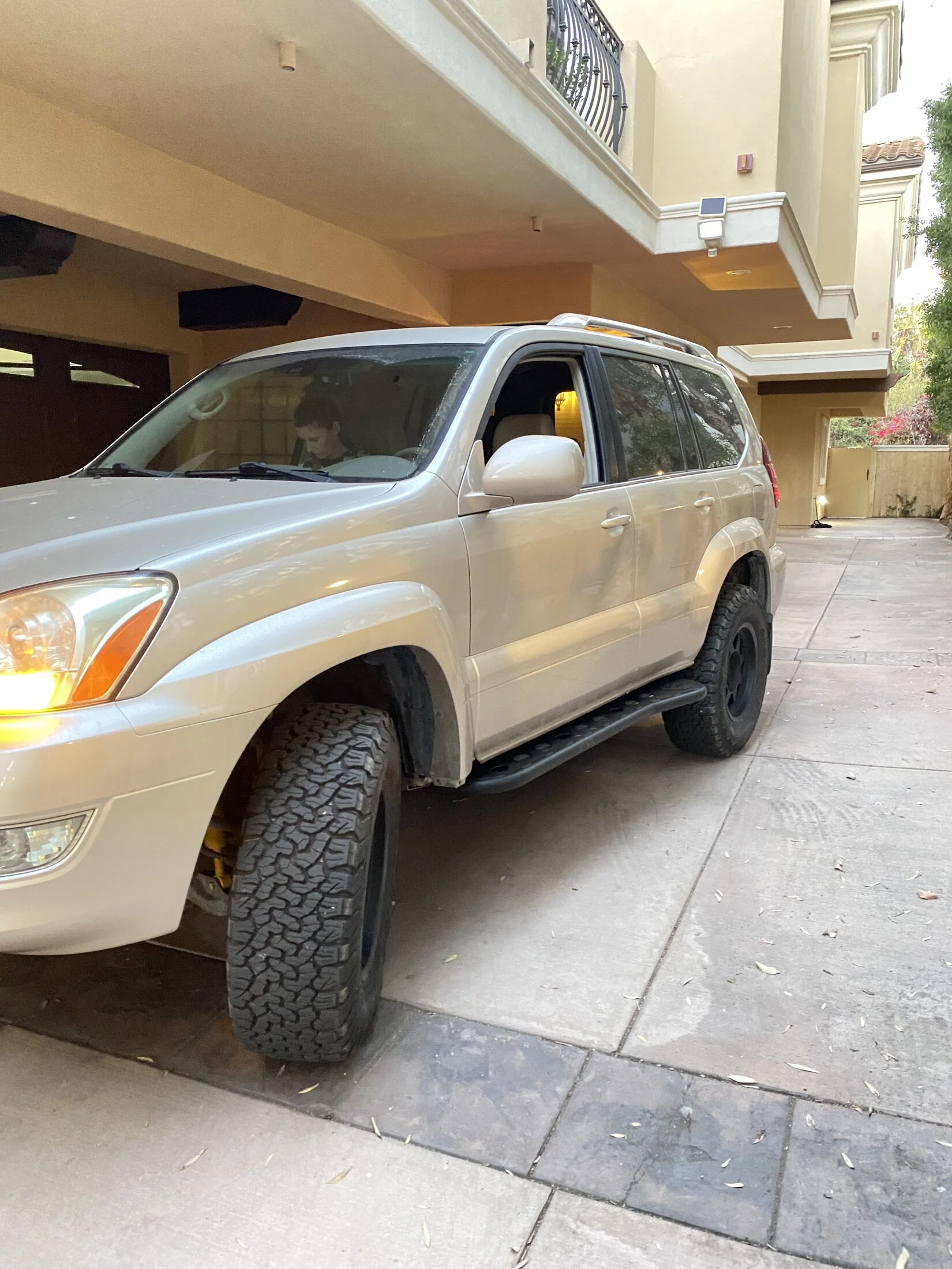

The vehicle recently received key maintenance items such as the timing belt and water pump, a fresh brake replacement, and new CVs. The vehicle also had a mild lift and recently upgraded wheels and tires.

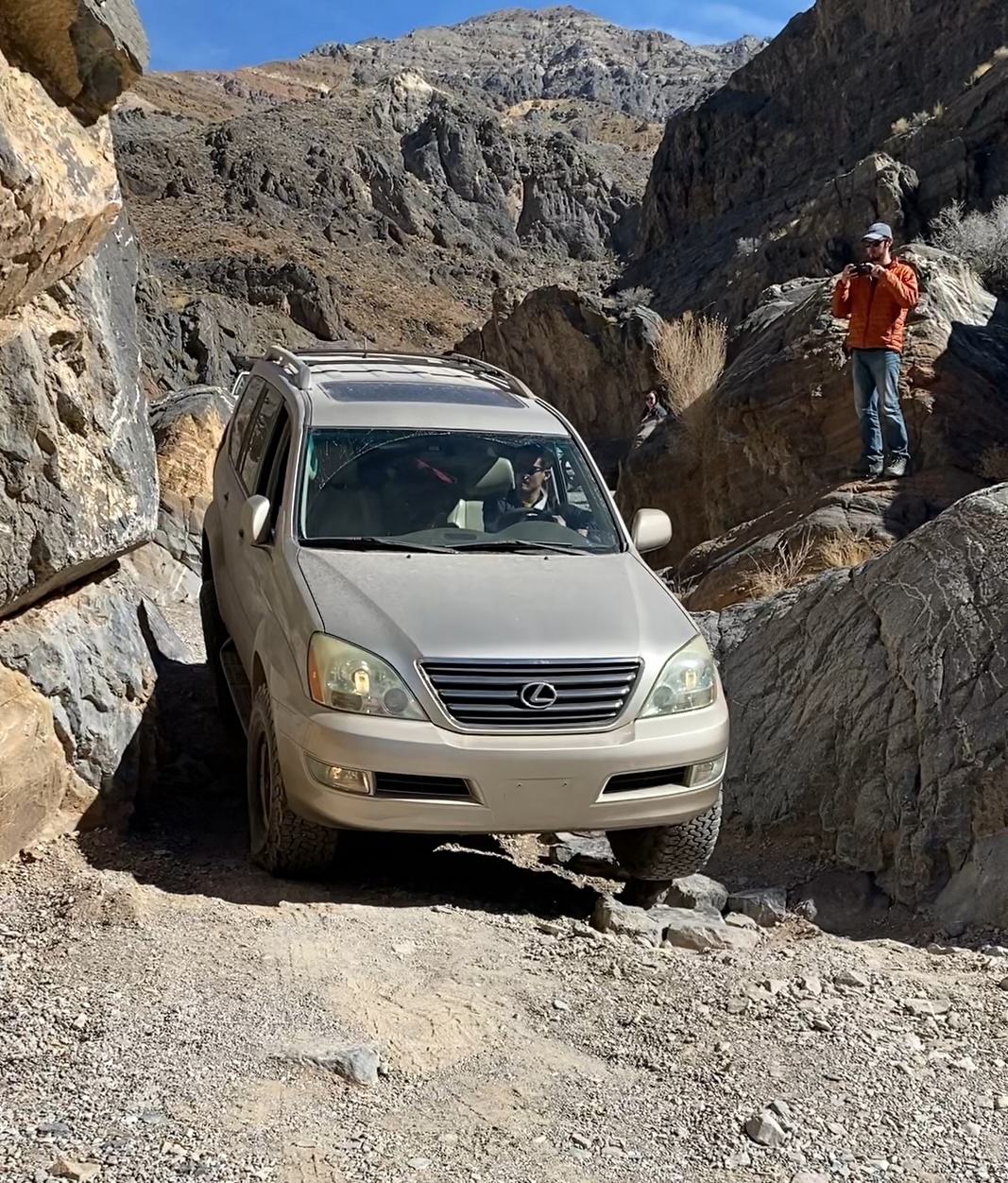

Tight Squeeze in Dedeckera Canyon

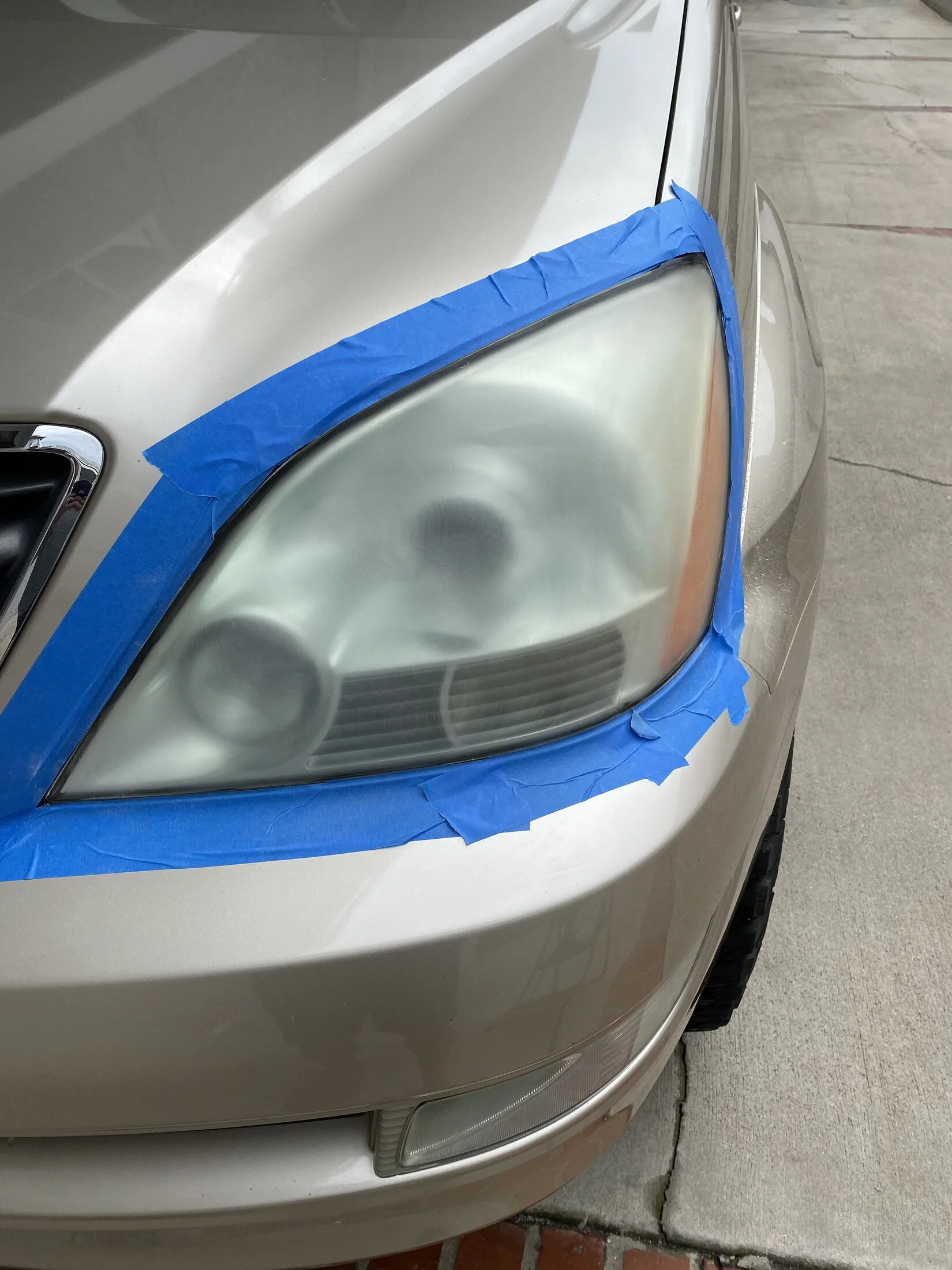

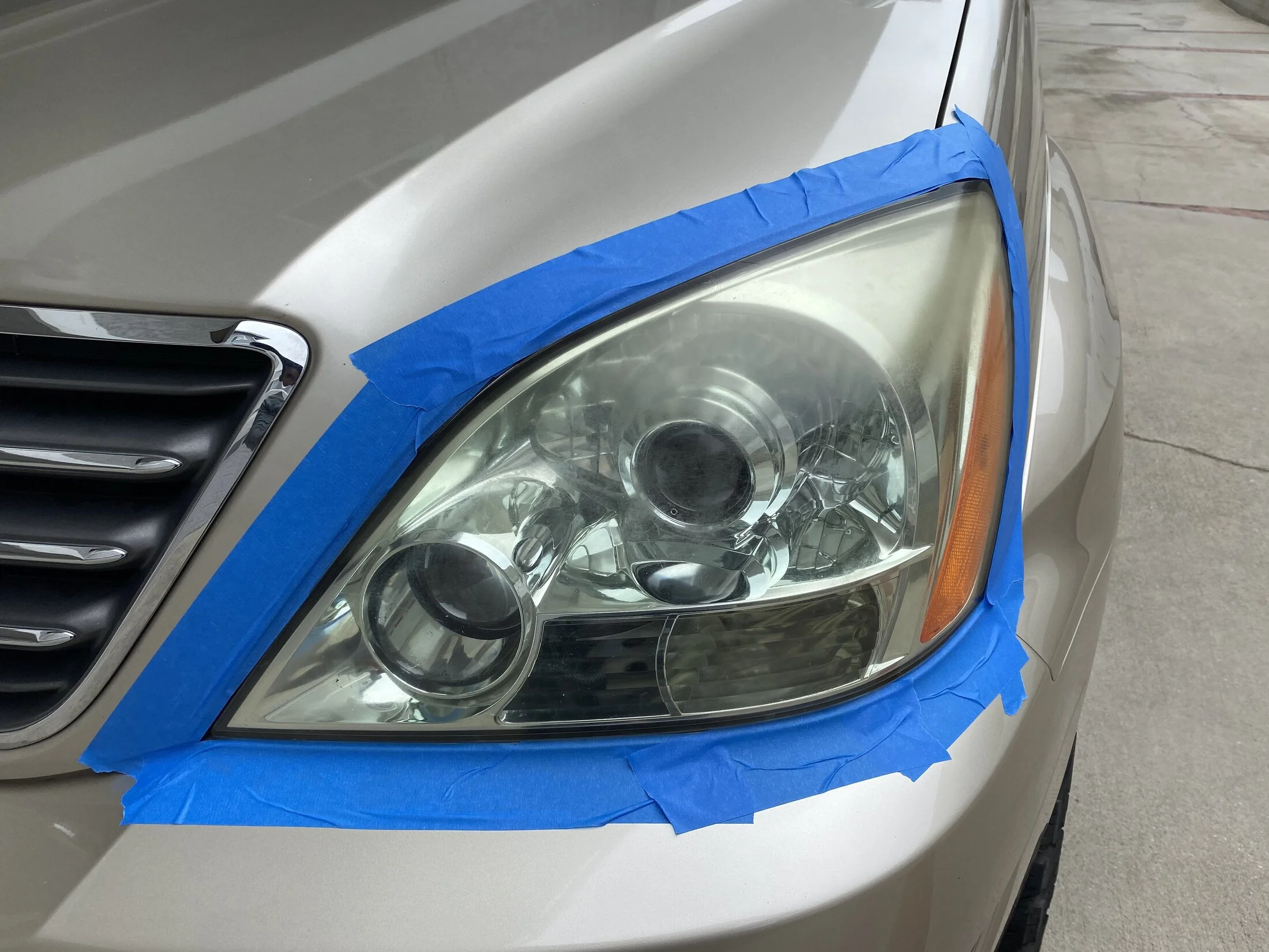

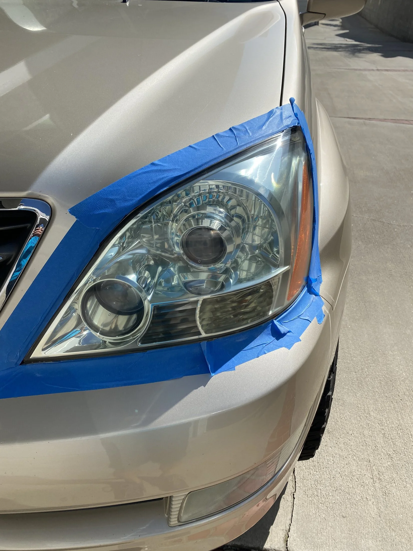

Headlight Polish, Round 1 - April 2021
A buddy of mine had a lightly used Turtlewax headlight polish kit that he was finished with, so I figured it couldn't hurt to spend an afternoon improving the clarity of the original headlight lenses.
The kit comes with varying grits of sandpaper that could be attached to a rotary head and a polishing pad for the final polish step. Overall, the end result was pretty impressive for roughly two hours of my time. This probably could have gone faster, but I was using a portable drill with only one battery. I could get about 15 minutes of sanding or polishing before a recharge was needed. Oh well, more breaks for cold beverages.
I didn't add any UV protection to the light after the polish aside from my typical protective detail spray that goes on after each wash, so we'll see how long this holds up.
The before quality wasn't terrible, but there was noticeable oxidation on the upper section of the light.
Really committed at this point
End result

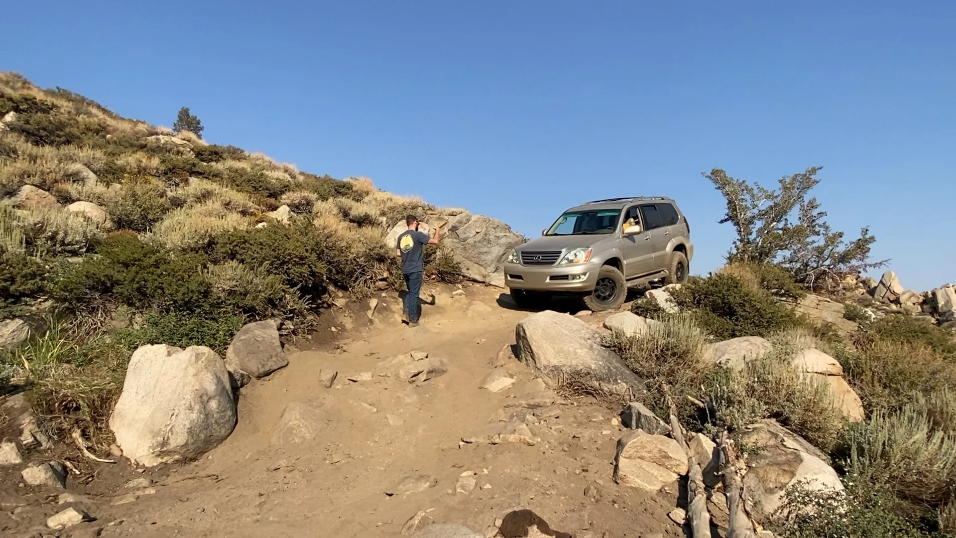

Fun parts of the terrain
Climb to the top of Coyote Ridge at ~11k feet. The little taco really utilized his steel skid plates on this trip.

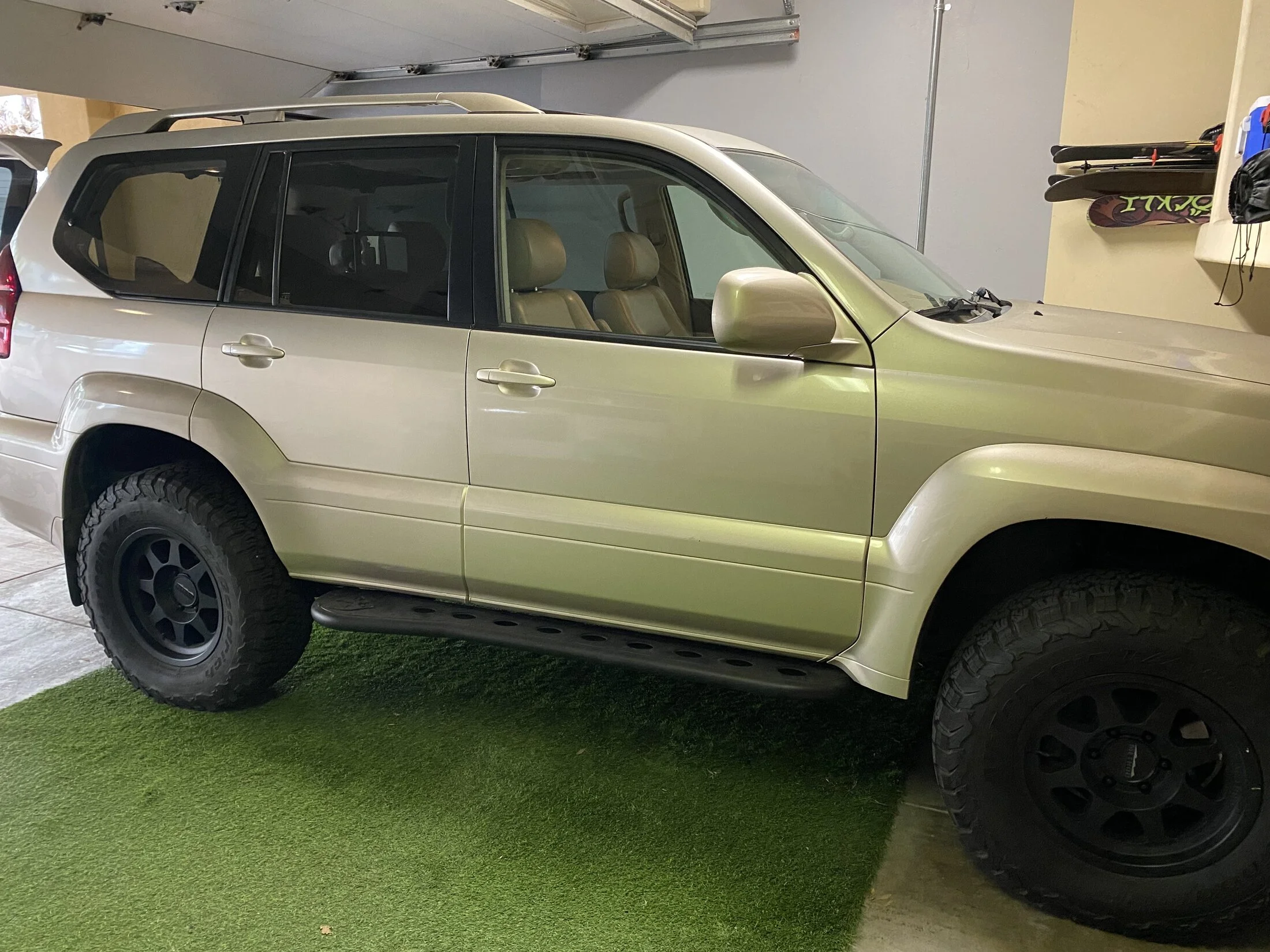

Rock Sliders - Nov 2021
After my last few trips where I just barely cleared some larger rocks underneath the side steps, I figure it's time to pull the trigger on some rock sliders. I wanted something that could function well as a step but still protect the door sills, so after lots of research I purchased a set from RSG offroad with the full top plate.
The process for removing the OEM side steps is well documented online, and was pretty quick and easy. I saved the original wiring harness for the lights so I can rig up something new in the future. I still need to go back and trim/replace the piece directly behind the front tire, but that can wait for another day.

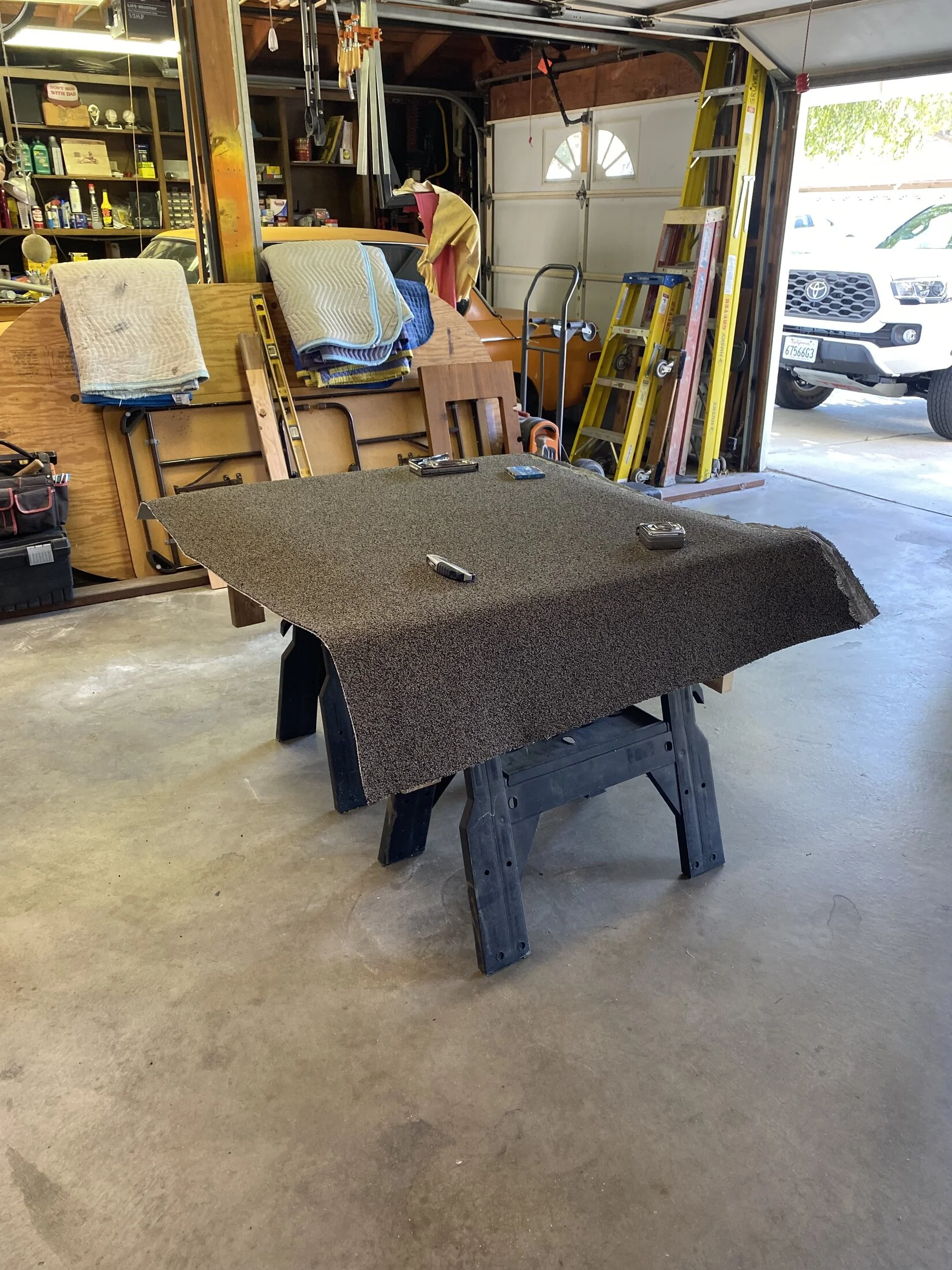

Rear Storage Shelf - August 2022
Upgrades and modifications to the GX have been non-existent throughout most of 2022. I'm expecting my first child soon so prep work for family has rightfully taken priority. However, as the birthdate approaches, I'm realizing that the location of my spare tire behind the second row limits my ability to carry larger items like strollers efficiently. I've been getting by with this spare tire location up until now, but it hasn't always been great on longer trips with coolers, gear boxes, and other bags precariously packed around an above the tire.

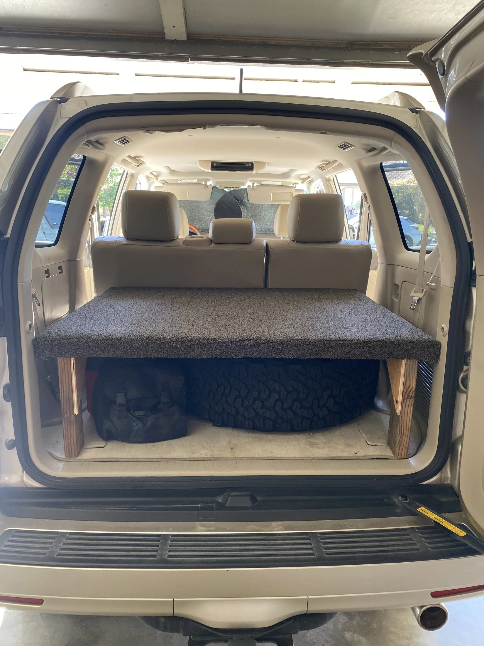

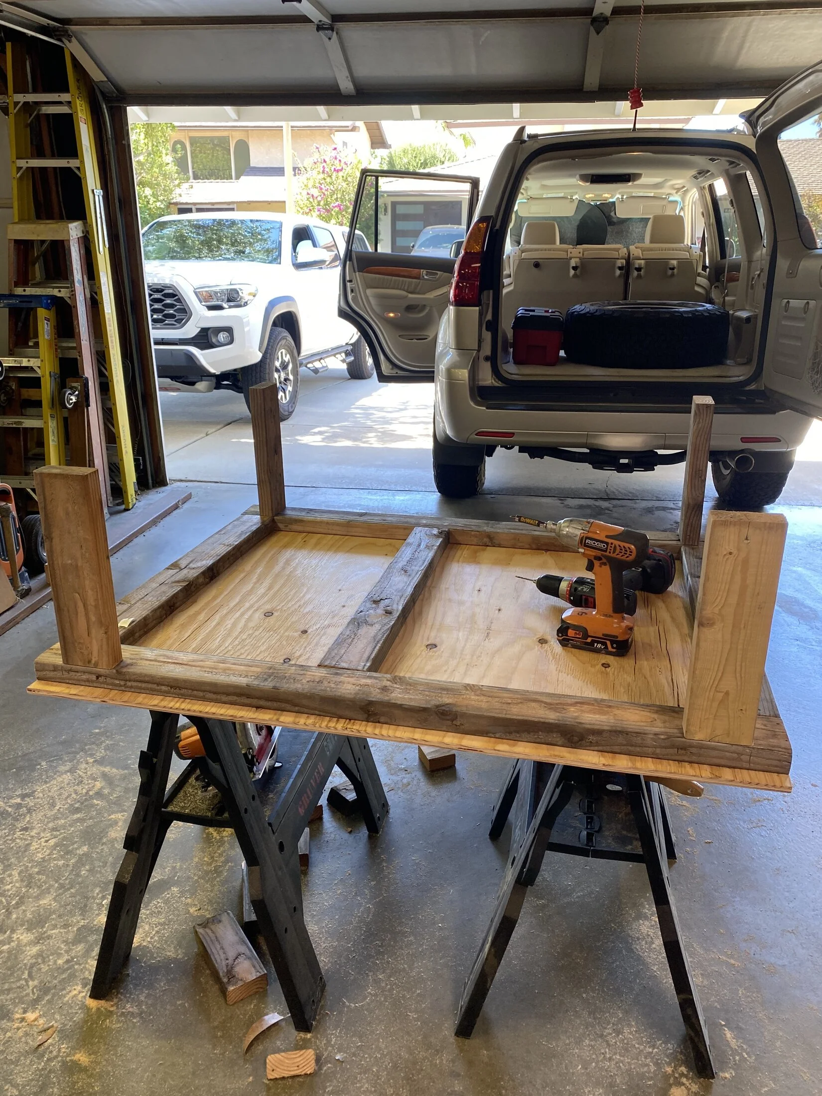

I'm limited on time, so my dad and I decided to quickly build a storage platform. My dad had some extra lumber lying around from a past project and was able to snag a few yards of unused industrial carpet from an office remodel, so my all in cost is practically zero for this.
We started mid-day on a Sunday afternoon and finished up within a few hours, so the finished product is basically "good enough" but not great. I figure for the price of gas to drive to and back from my dad's house (roughly 90 miles round trip) this is a great outcome for now.
We sized the shelf height so I could 1) clear the spare tire 2) fit my standard camping box and/or cooler below the shelf (I can fit two boxes side by side) and 3) fit two rows of camping boxes stacked above the shelf. So if I ever move the tire out of the cabin I'll be able to hold quite a bit of gear back here with my current camping boxes.

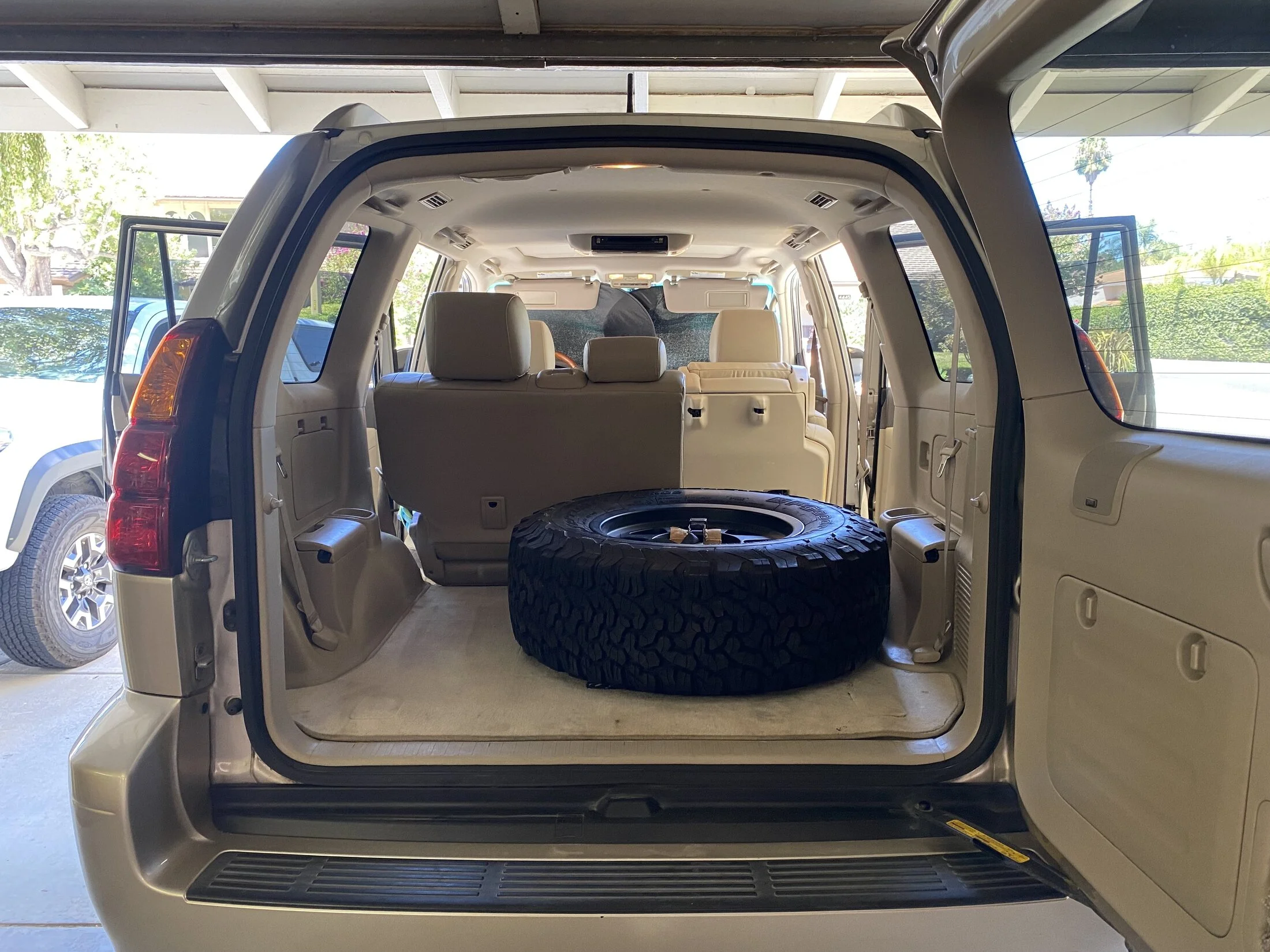

Here's what I've been living with since I bought the car. Hasn't been ideal but I have gotten by on all past adventures.
Not much math or science going into this, but it passes the "feels strong enough" test. The center support is offset to clear the tire.
Carpet going down with some glue and some large staples.
Viola! A finished storage shelf. A little bulky, but I'm happy to use left over material.

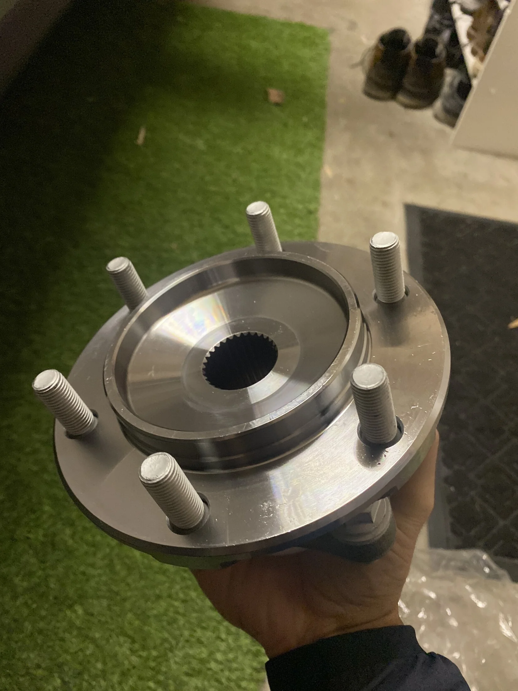

Front Wheel Bearing Replacement - November 2022
I started getting a minor shake in the steering wheel at highway speeds a few weeks back and it quickly escalated to the point that I'm not comfortable driving above city speeds anymore. A quick diagnosis revealed the left front wheel bearing was going back, so after some deliberation I picked up a set online from 1A auto and swapped them out over a weekend. It's unclear if these are Japanese bearings or some cheaper bearing, but for <$200 shipped I figured I would give them a shot. After the swap the steering wheel shimmy was completely eliminated, so hopefully the bearings hold up for at least a few years.
Mileage at the time of replacement was ~121k and I'm pretty sure the old units were original.
I also took a few minutes to fill in the missing side step piece just behind the front wheel. I meant to get this cleaned up after installing my sliders about a year ago, but didn't care enough until now. It's a pretty easy process to dissect them and get the front plastic bit reinstalled, and it really does clean up the side of the vehicle.

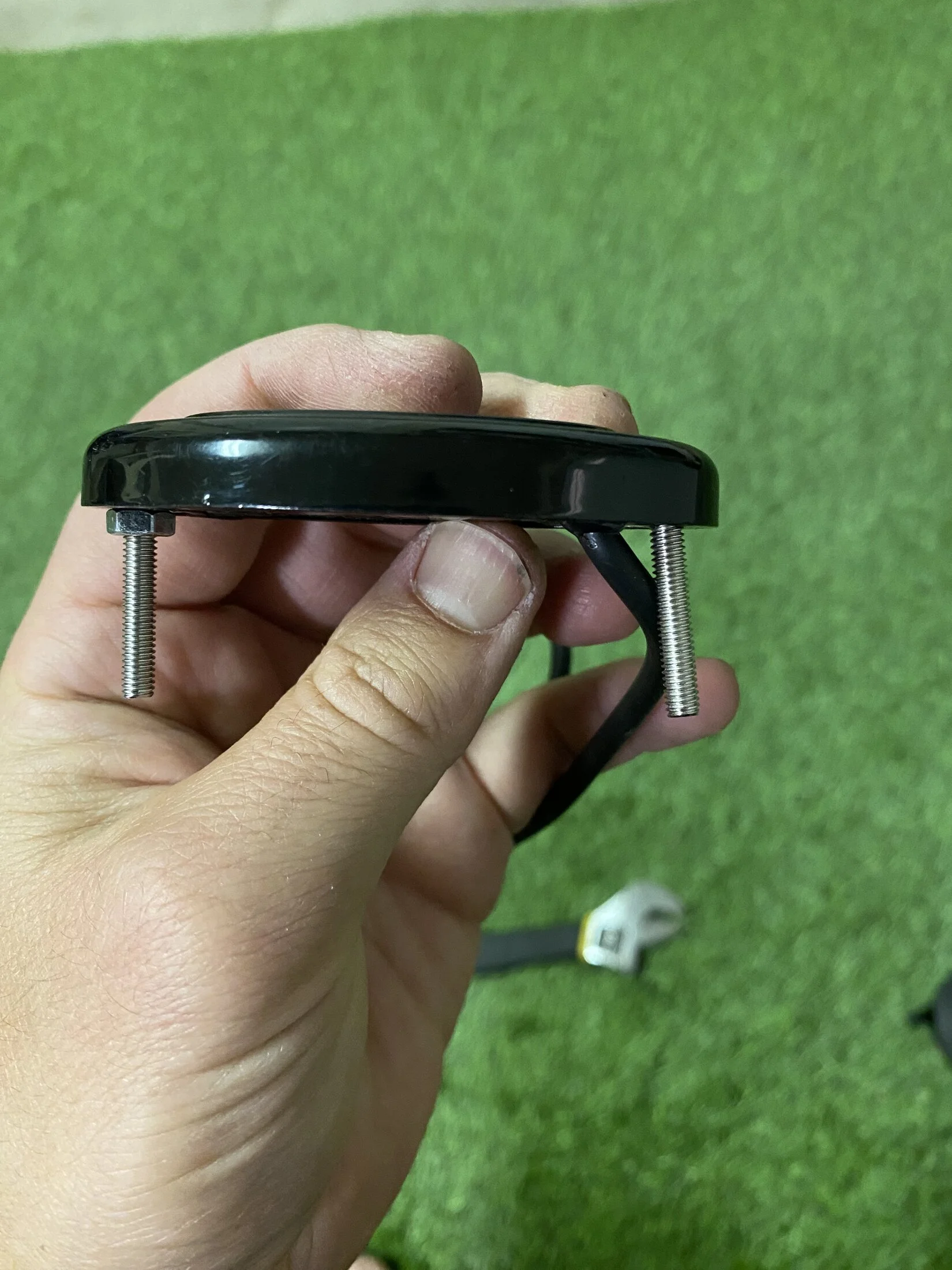

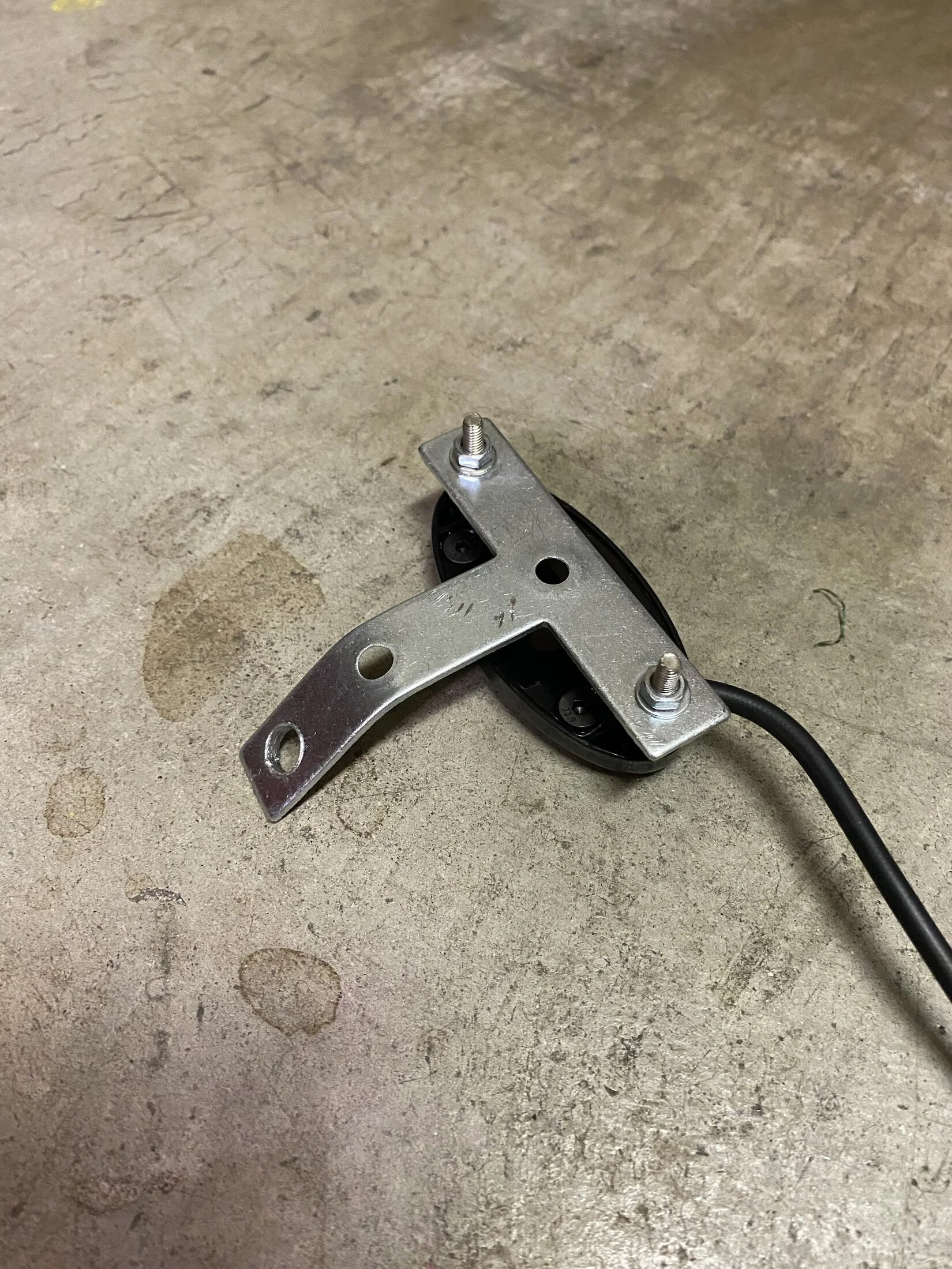

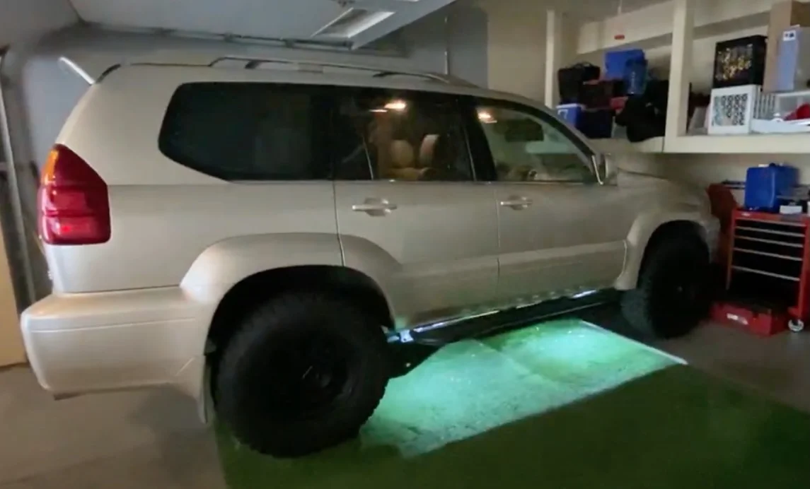

Side Step Lights - June 2023
When I removed the stock running boards to add rock sliders a while back, I kept the original wiring harness and connectors intact for the OEM side step lights. I finally got around to wiring up some aftermarket LED rock lights purchased from Amazon to add to the OEM+ look of the vehicle.
Wiring up the lights was super easy with the original plugs. Simply spice into the stock wiring from the running board light and plug the new LED lights in.
I took inspiration for the mounting brackets from a few online examples, and found some T framing brackets at my local hardware store. I was able to find a set with a similar bolt pattern to the Amazon rock lights and with some simple hand tools was able to mount these up to the stock running board holes on the body.
All in all it cost me <$50 and a few hours of tinkering for a nice floodlight when the doors are open.

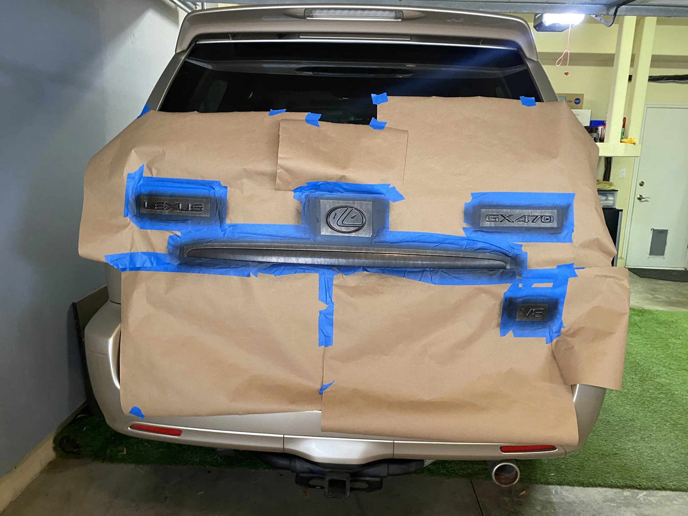

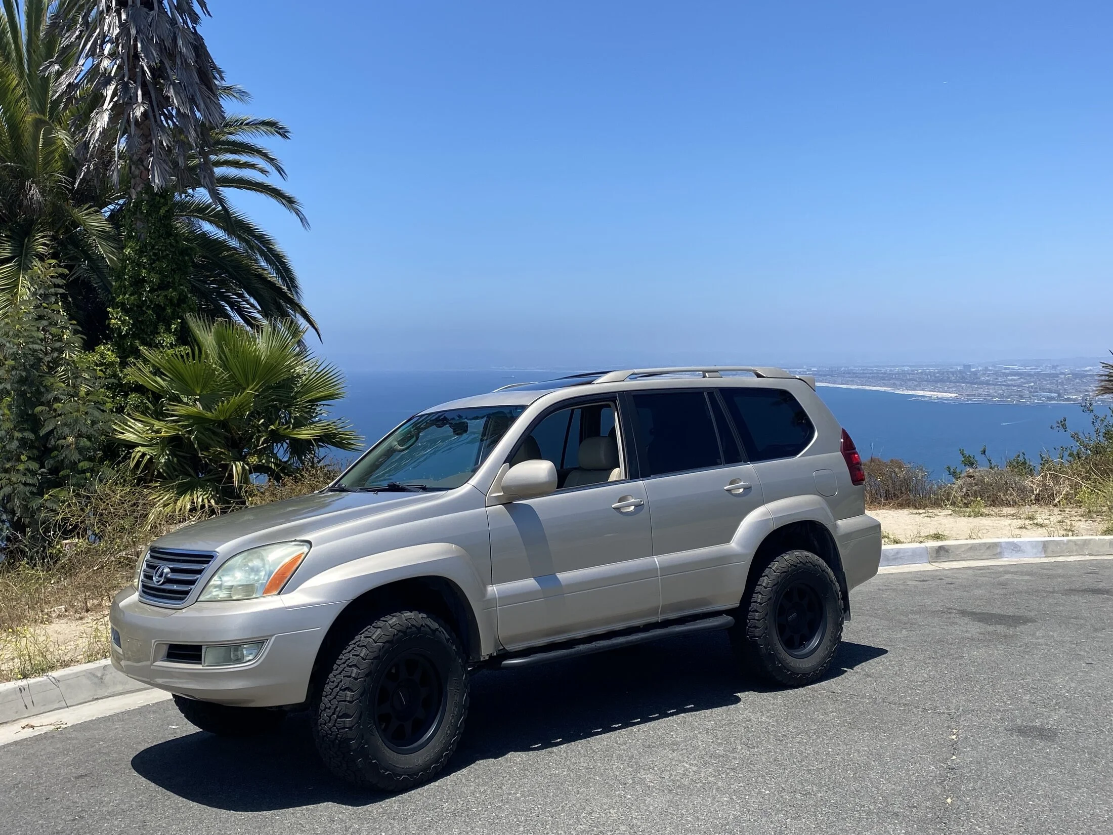

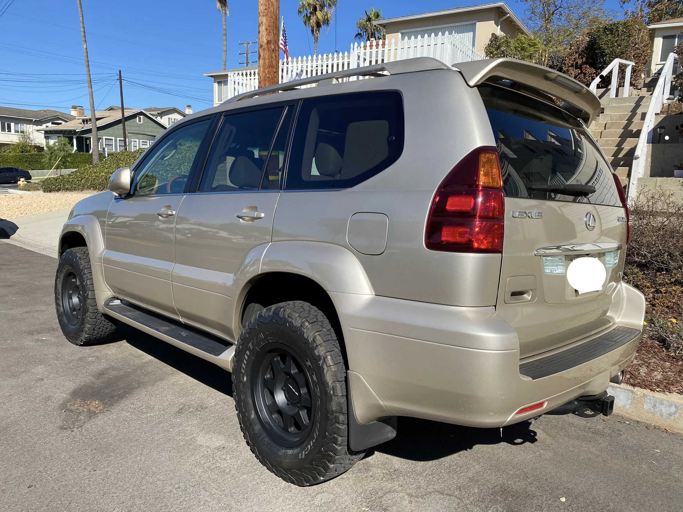

Continuing to document the past changes to my GX. I really dislike the chrome trim all around and my side molding seals are shot, so I decided to try out some Plasti-Dip on the front and rear chrome and pick up a set of the black Prado side trim pieces.
There is a nice writeup over at GX Basecamp for the side moldings including the parts list from PartSouq, and the process is pretty straightforward.
I think the chrome delete works well with the black wheels and takes the grampa effect down a notch or two.

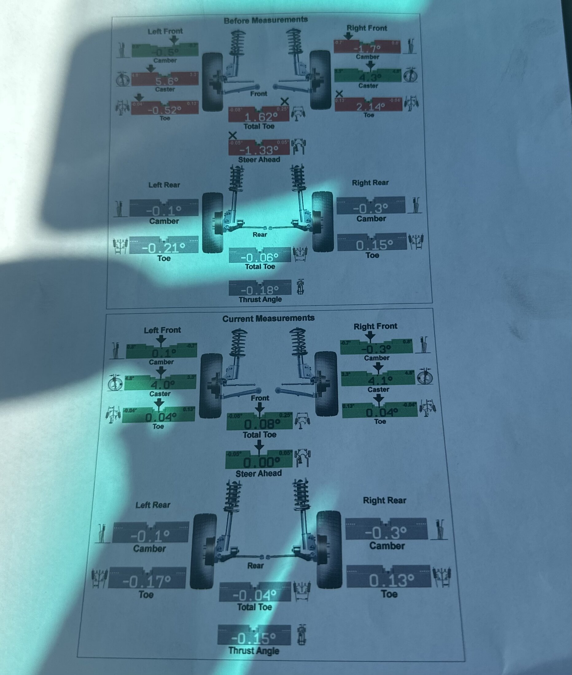

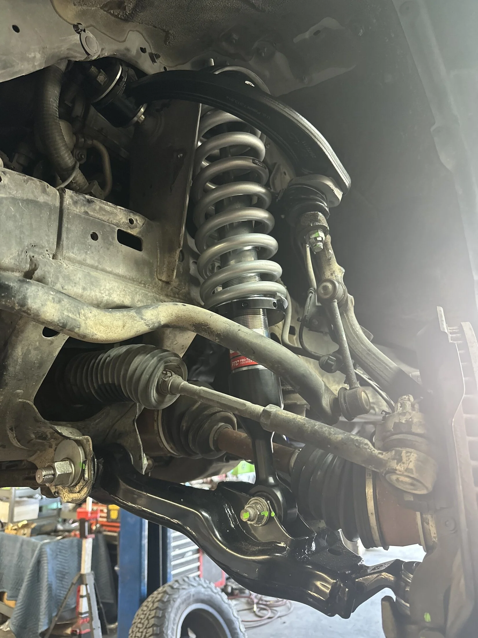

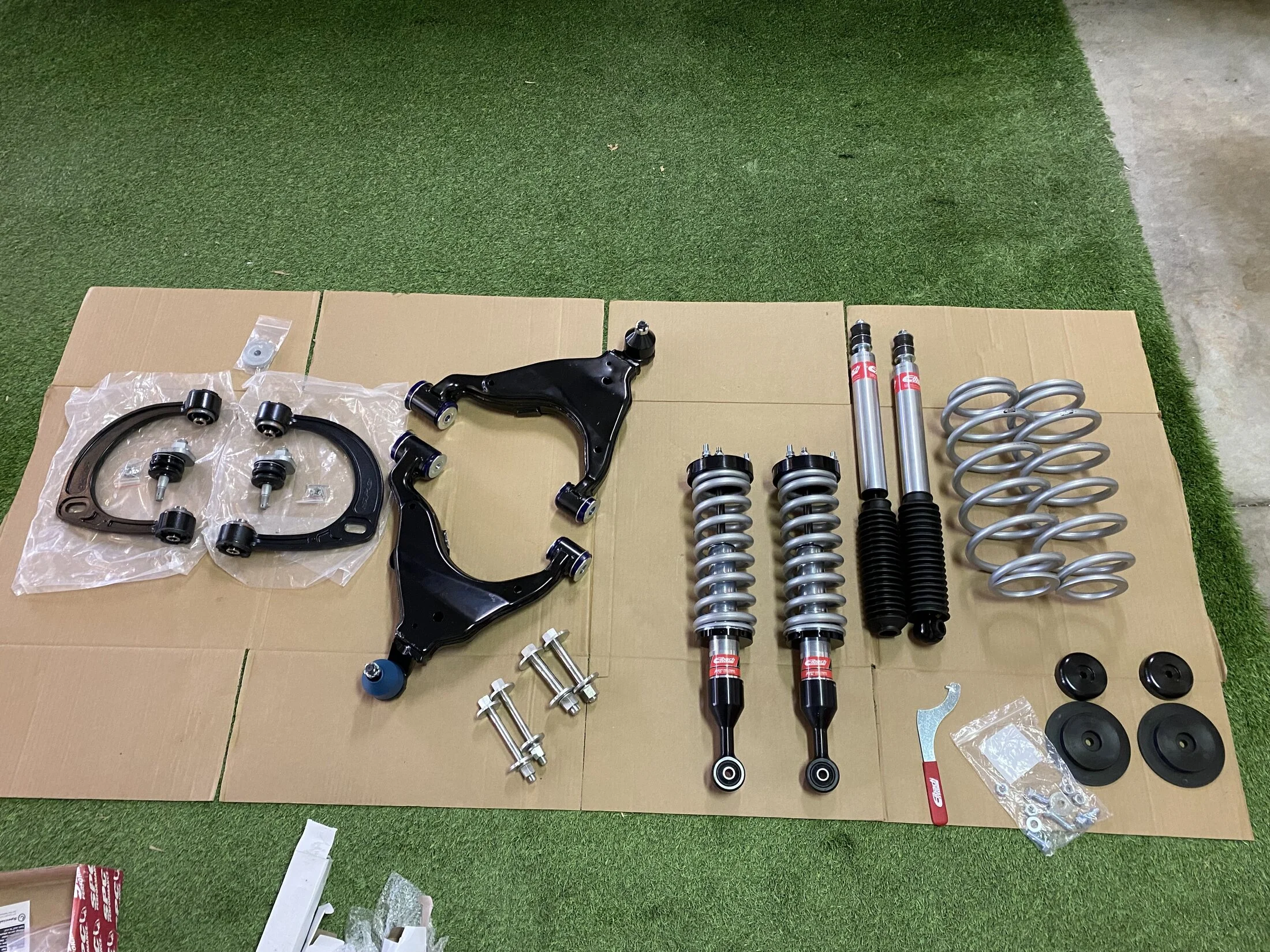

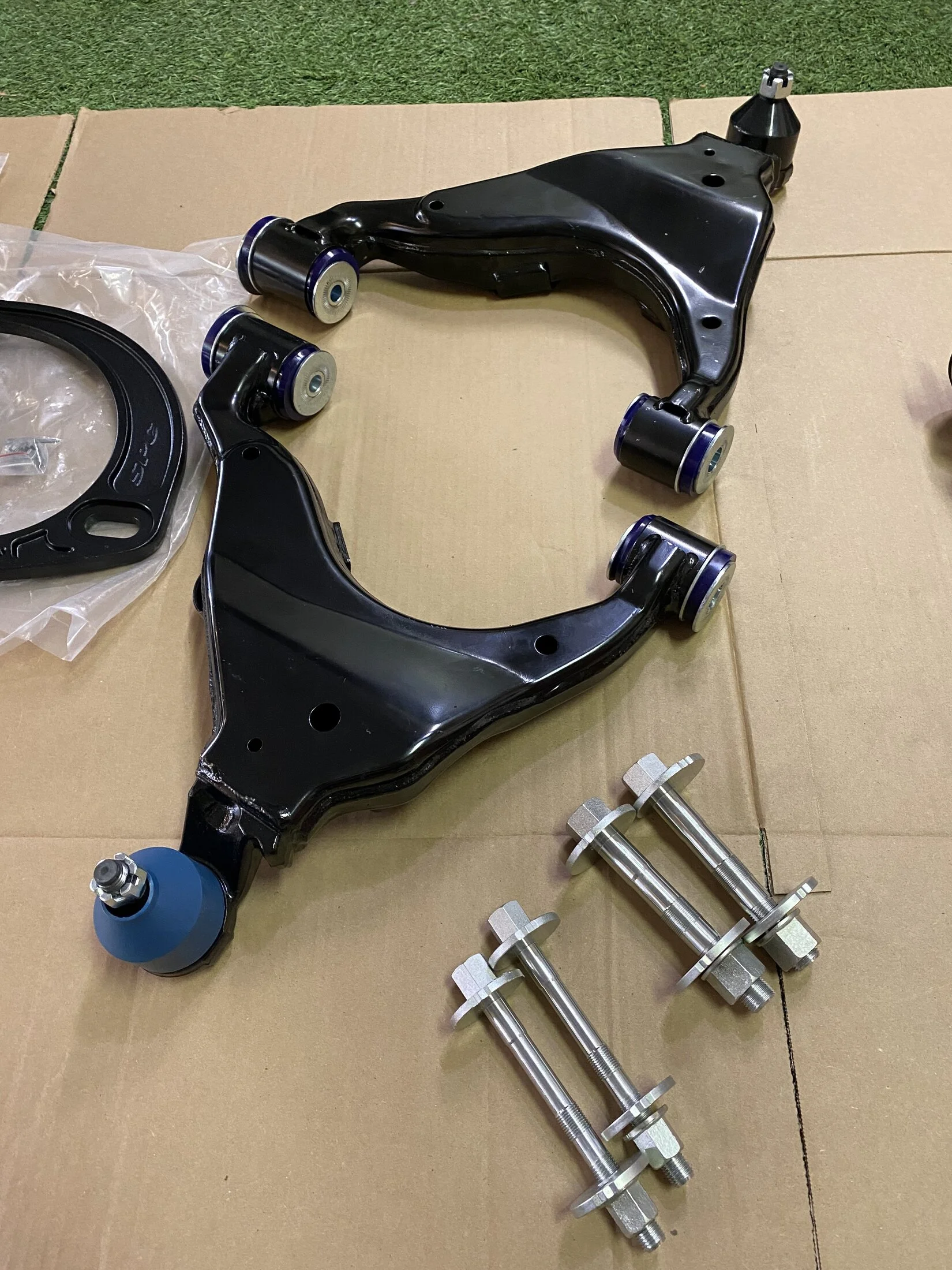

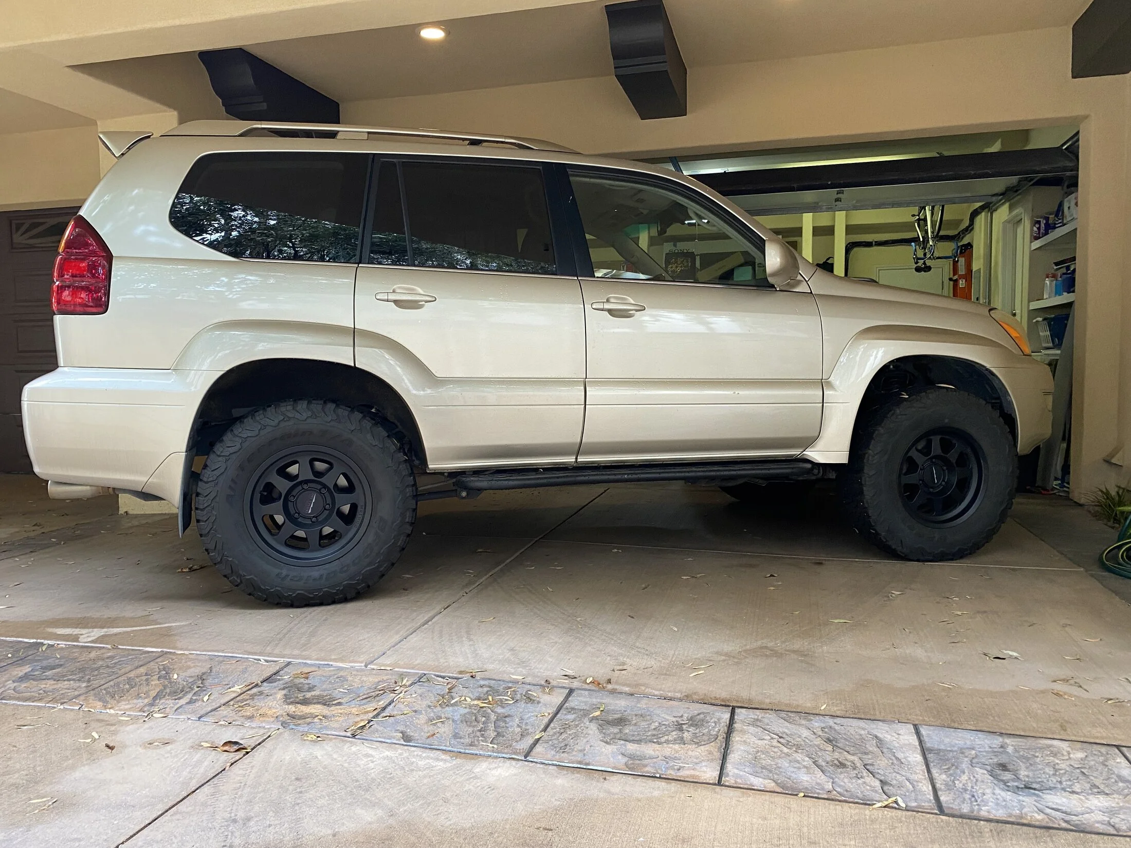

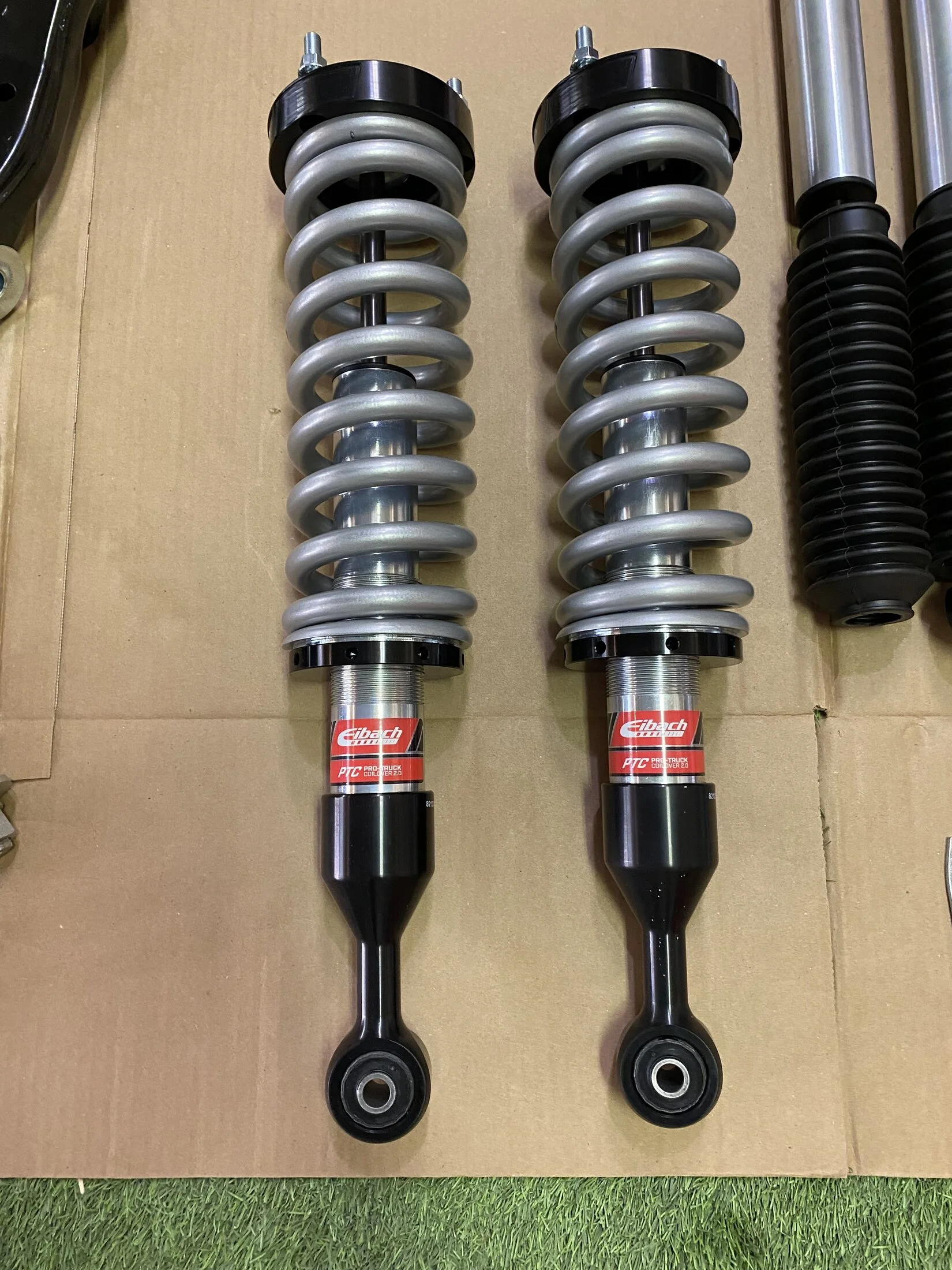

Suspension Refresh - August 2023
I finally got tired of the stiff ride from the OME nitrocharger shocks and decided to try out the Eibach Protruck 2.0 kit. I looked at most of the different options in this mid-level price range and went with the Eibach kit for a few reasons:
  • First, they are fully "sealed" and come with a lifetime warranty which gives me confidence that I won't have to rebuild them a few seasons down the road. I really don't like the idea of paying for expensive shocks then having to go through the effort of pulling them out to get them rebuilt every few years. I've heard mixed results regarding seal longevity with some of the "rebuildable" options and just didn't want to deal with it.
  • Second, many reviews put the Eibach as a nice "in-between" ride quality compared to a few other popular shock options. Notably, Bilstein 5100 or 6100 and Fox 2.0. The Bilstein shocks are digressively valved which gives them a more "sporty" and responsive feel under slower shaft movement (around town and cornering), and since I have a sport sedan daily driver I want my GX to have a more compliant ride. Alternatively, the Fox 2.0 has linear valving but many reviews say it is a little soft for heavier vehicles and can bottom out easily on rough terrain. Dobinson IMS shocks were also on my short list, but I struggled to find any direct comparisons to the Bilstein, OME, and Fox options.
  • Third, the Eibach shock uses a threaded steel body which allows on-vehicle preload adjustment of the front coilovers. This sounds significantly more user friendly compared to the Bilstein style circlip adjustment that requires a spring compressor for preload adjustment. I don't plan on making changes frequently, but if I add any weight to the front like a hidden winch (probably a ways down the road) I like that I can make some small adjustments to the front right height as needed.
I plan on setting ride height around +2" to +2.5" above factory so I probably don't need to upgrade the UCA, but I decided to add in SPC upper control arms for more spring clearance. Again, this was another trade with some of the more popular options out there, but I ultimately chose the SPC UCA since you can set the amount of positive caster. I don't have body mount clearance issues with my stock UCA and Old Man Emu shocks, and I don't want to this to become a new problem. I hate when one modification leads to a cascading affect.
I was going to call it good with shocks, springs, and upper control arms. However, since I'm in for a penny I might as well be in for a pound so I bought a set of Super Pro double offset lower control arms to replace my original OEM arms. My original ball joints are looking worse for the wear and I don't want to pull everything back apart a few months down the road. The double offset bushings should pair well with the SPC upper arms since I can get a few degrees of positive caster back but keep the wheel forward and away from the body mount.
**Feedback**
I find the Eibach shocks to be really well designed and well built for the price range. Very solid machined top bracket and lower connection points. The ride is greatly improved over the nitrocharger shocks, significantly more compliant around town and off-road. With the nitrochargers I could feel every little rock on the trail and would typically air down even on fire service roads. After installing the Eibach shocks the ride is about the same off road with ~35 psi tire pressure as the OME shocks were with ~20 psi tire pressure. I do notice slightly more body roll and slower transient response, but this should be expected from a 5k pound truck!
The Super Pro lower control arms are also very well built. I can't really detect any quality differences in the metal body between OEM and Super Pro. Time will tell on how their ball joints hold up, but since I only drive ~5k miles a year I'm expecting (and hoping) for many years of life. The cam adjuster bolts also seem to be pretty stout so I'm hoping for consistent alignment. I will say that I'm not the biggest fan of polyurethane bushings, but I'm not sure the double offset design would work with a standard rubber compound. I didn't get enough grease on the ends of the bushings and I have some squeaks when it gets colder. A little silicone lubrication spray usually quiets it down most of the way, but I'll need to pull these back apart at some point to add more grease. Or I'll just learn to live with it.
The SPC upper control arms definitely have some negative reviews out there. I haven't had any problems with mine yet (fingers crossed) but I know that I am taking a chance in order to have the caster and camber adjustability.
Are your cam tabs starting to flatten out in some of them? Make sure they hold the alignment.
I put taco tabs and had a muffler shop spot weld a bead behind the factory cam tabs to make sure they hold up
Also, two underrated suspension changes to consider. They really improved flex/articulation on my 2003 GX470:
1. Remove front sway bar and add HD rear sway bar with extended rear sway bar end links
2. Replace the rear upper and lower links (arms) with Apache Offroad ones.
These two changes balanced and maximized my articulation for under $800
