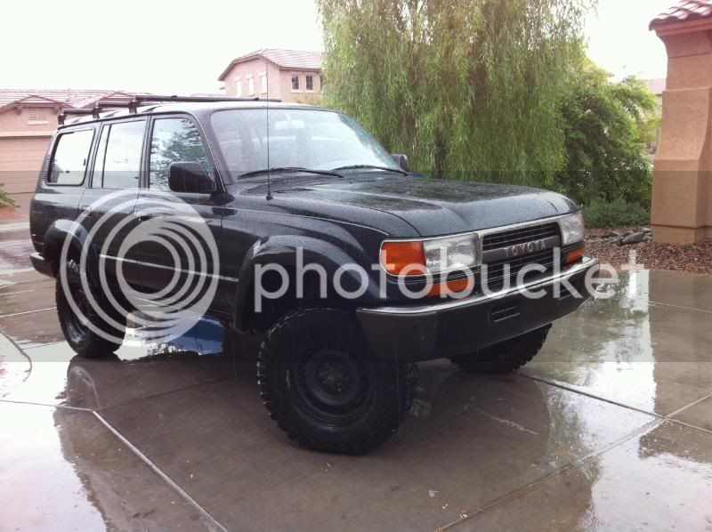

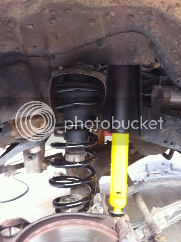

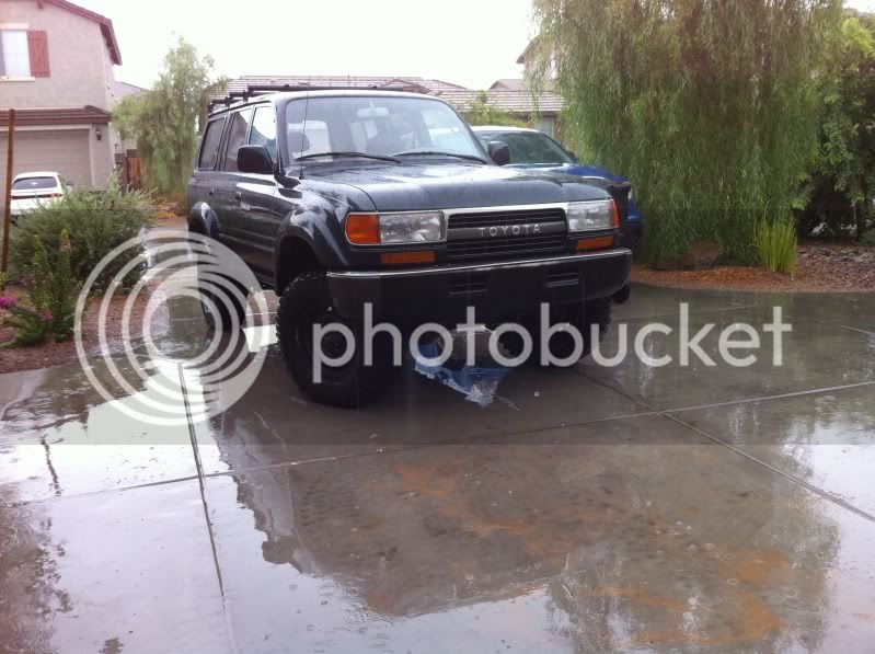

Nothing special but I got the OME med lift put together on friday. I made those spacers like metal tech for the front but now the caster is hairy. I'll swap the bushings this week sometime. Can I ask you guys how much adjustment the LSPV needs now? Do I need a new mounting bracket or will adjusting it down be enough?
Looks like you are going to have the same problem I do. The bump stops in the center of the springs are going to come into contact with the springs during wheeling. You can see they are no longer in the center once you lift.
Tony,
Is this just a problem because of the spacers? Or with js etc...?
I doubt that you will have that problem, most don't. Mine has J's with 1.5" spacer or ~5" of lift and never had that problem.
