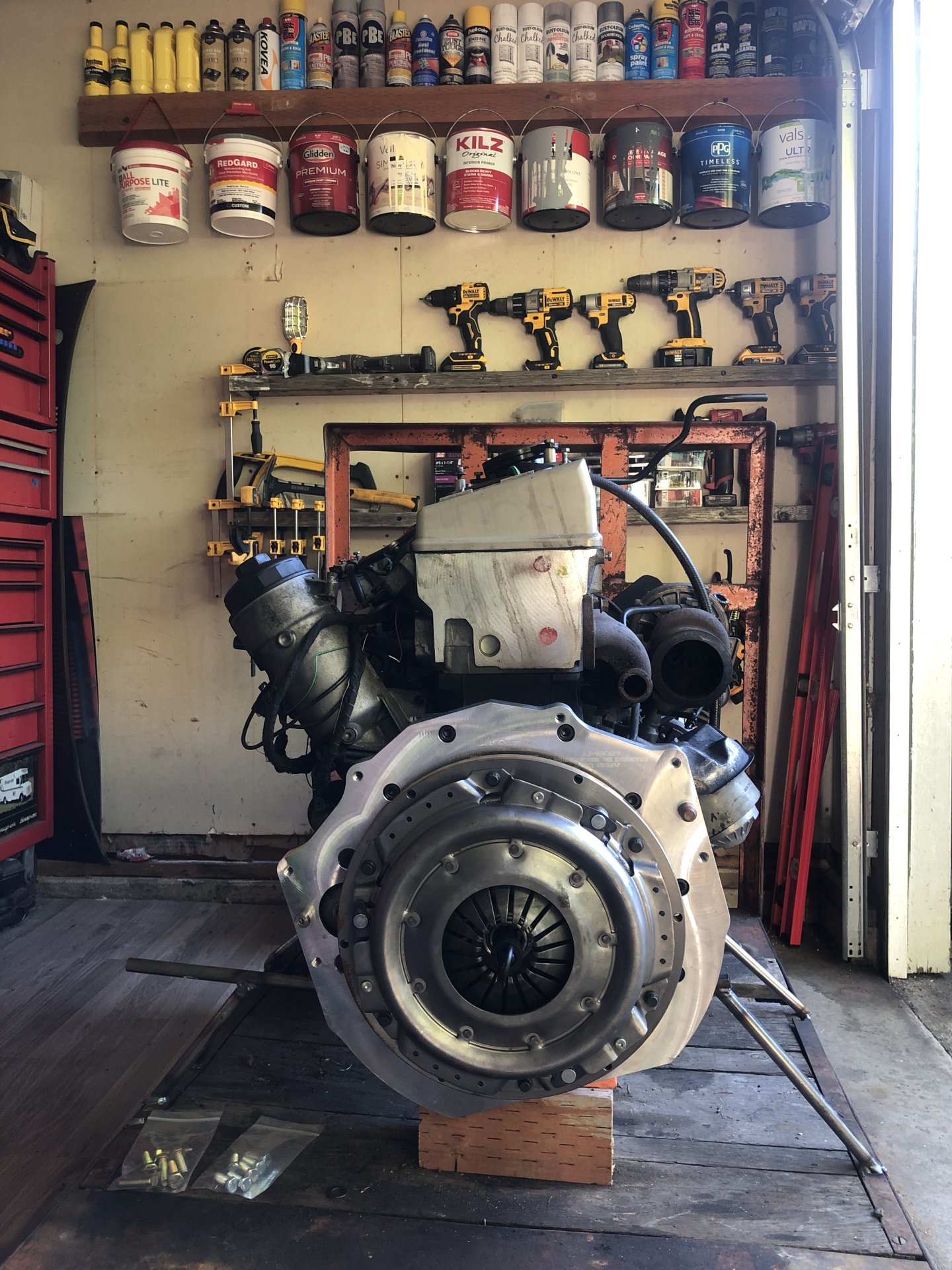

Curious if anyone is aware of an adapter to mate the om606 to the h55 trans. Not really wanting to go the R150 route. TIA
It’s been done, you have to do a double adapter, Mercedes to Chevy then the marks 4wd bellhousing kit. I actually bought it all then found a nv4500 and sold the marks kit.
This the the Mercedes to Chevy, speedgems sells it, you would bolt the marks kit to this.
