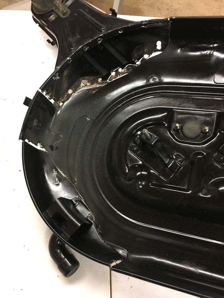

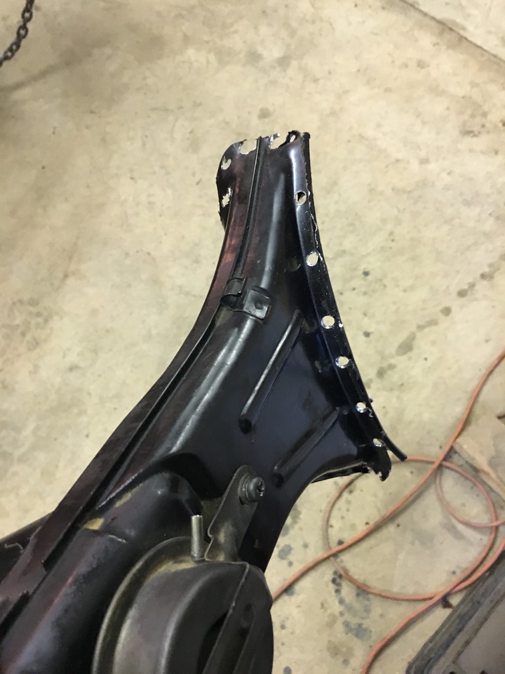

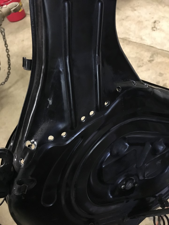

So I looked this air cleaner over and decided the best way to remove the intake horn on it was to drill out the spot welds.
Well, that was a bad plan.
I should have just made a clean cut. Much easier to re seal instead of all these dopey holes I drilled.
I'm kind of mad at myself that I cut up this nice air cleaner but once my good friend Lou @under_psi works it over maybe it will at least be functional for my snorkel instead of that silly hose i had across my engine before
