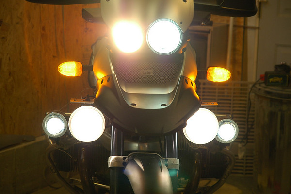

If your relays can handle the load. I have one side hooked directly to the battery with an 80 amp fuse for stuff I want hot all the time, no relay. The other side of the panel is hooked to a 40 amp "ignition on" relay. Hopefully I don't exceed 40 amps on those 6 circuits, but I think I'm good so far.
Thank you..
I guess i'm just geeking out, under the suggestion of my main motorcycle buddy, I reduce my relays to two, (one for each bundle)
But then I need something else to play (I need challenge to keep my self interested) so exploring all the possible places to mount the control panel, passion by the possibility of a helicopter "Joy Stick", i'm going to adapt it this way..
Funky idea, Motorcycle control pod, to manage the lights on my LC100
Another thing to consider is how much of a load can those switches handle? That's where the relays may be needed. I have no idea what those switches can handle and what kind of a load your devices will have.
Oh no big deal at all, those BMW are build like cars, actually they use Car parts, mostly Bosch, and we run massive currents (6 55watt HID is comun) radios GPS, heated seats, vest, socks, etc
