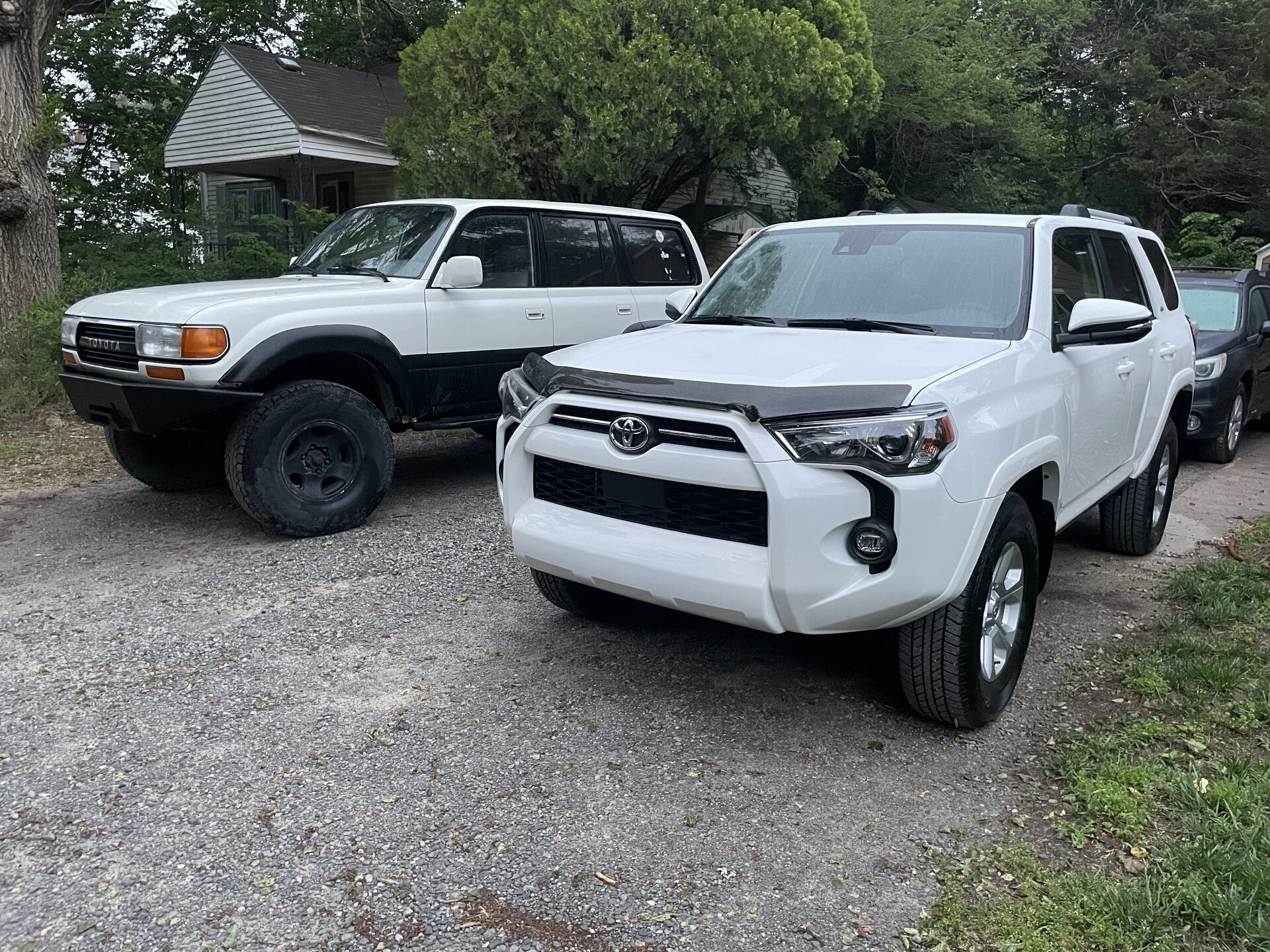

Finally showed up! 7 miles on the ODO.
Edit: One of the sales guys also said any maintenance I do myself voids the warranty. 🤔. I’ll have to look into that, doesn’t seem quite right but who knows. So maybe I’ll be stuck with 10k OCI’s.

Looks great. From my experience - it'll be so reliable the only reason you might eventually sell it because you'll get bored and want to try something new. Then you'll likely regret selling it and start looking for another one. haha.
Thanks! I actually have never really looked into these too much. I’ve always been an 80 series LC guy. But I’ve got three friends with 5th gens, one being a jeep convert. I also owned an 87 T4R and enjoyed it. This was my wife’s pick. I’m just glad she likes it! We had an LR3 but we got rid of it with about 140k. Problem free. I expect the same of this!
