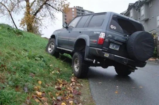

Here are some
1) before
2) after
3 FOR flex

The second shows how stiff the OME was!

The second pic above showing OME picking up a tire on a slight undulation is shocking. You really must be loving life now.
