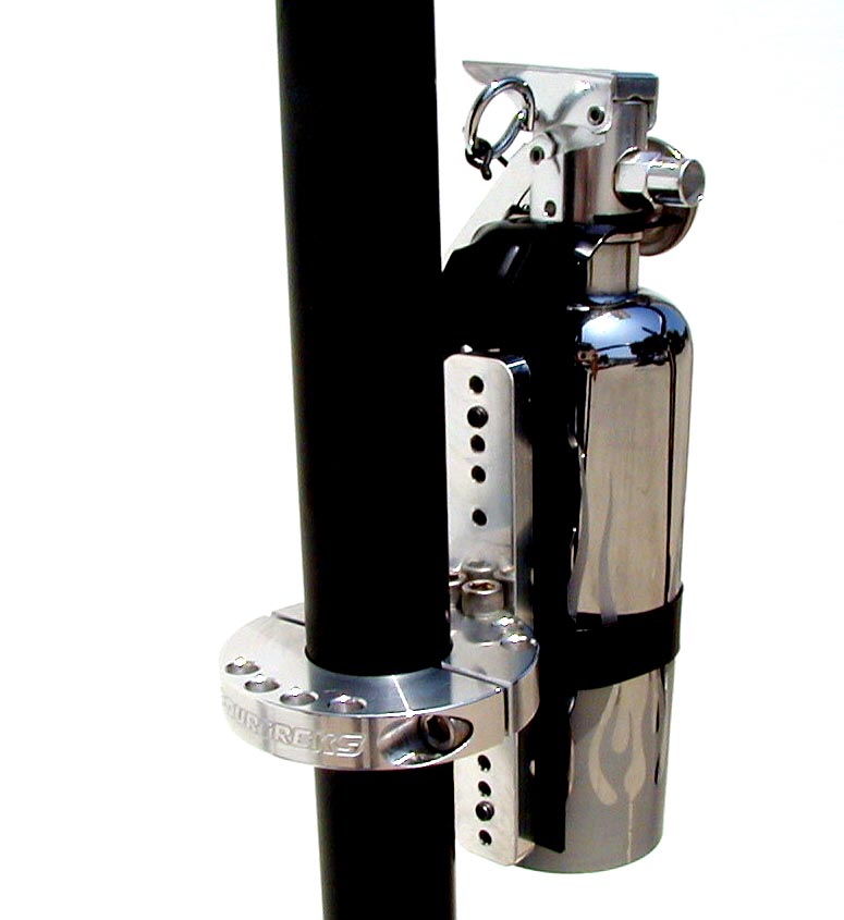

Yes, Luke at www.fourtreks.com has a product that would work.
It works with the 1.75" rings to mount on the stock rack.
I bought the part from him, but I have not gone out and bought a jerrycan holder again yet.
I gave my last one away with my Yakima rack from the old rig.
I do not have a picture of the item, but it is a bar that can sit vertical or horizontally depending on how you mount it.
The bar has some bolts with it, and you could run them through the back of one of those shorty red jerrycan holders.
Lemme see if Luke has the item up on his website.
Standby please :D
Found it, it is the fire extinguisher mount.
http://fourtreks.com/modular_fire_extinguisher_mount.html
Mine is on my PC table as I type.
You could get away with one of these I bet, as the maximum width of the holes is about 6", that should hold a mount like the one I had before.
That mount below will hold a 2.5 or 5 gallon jerrycan.
I ran the smaller sized can.

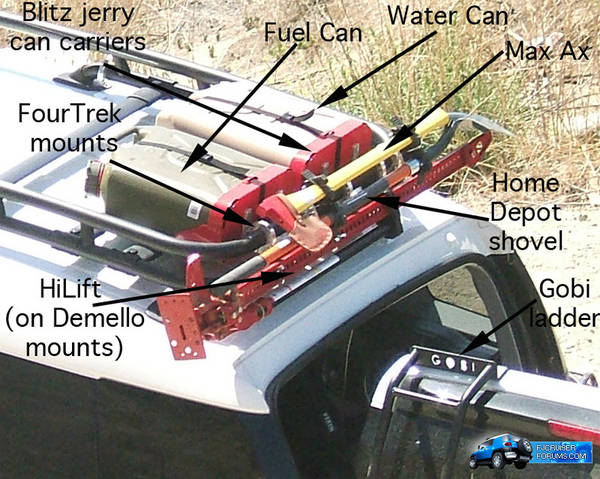

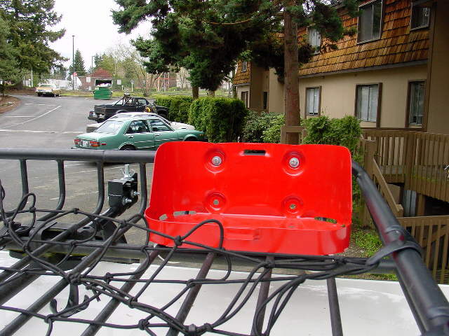

I put 2 Blitz Jerry can mounts on the roof rack with Yakama mounts and Conn-Fer mounts.
PM me and remind me to find the pics. Or if I remember I will post later for you.

Here is the pic as promised. I think I used the H-23 mounts.
-Ben
Cool,, you used those fire extinguisher mounts I posted above.

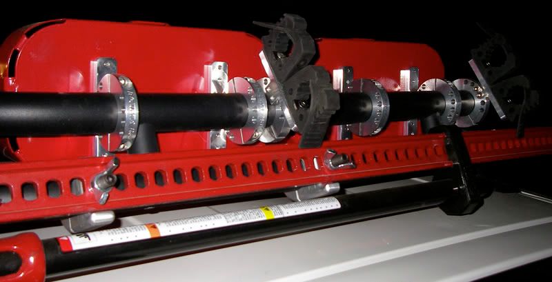

I'm gonna run the same setup as you mlrfjc. I ordered the perpendicular mounts, blitz holders, blitz metal gas can, and the blue water carrier. The holders and cans came today. They are really nice. No leaks at all. They look nice too.
Cool. Let me know how it works out for you.

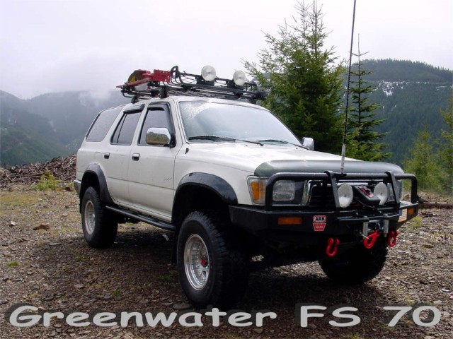

This is the CRAZYHERMIT's rig as taken through my windshield. One of the Toyota Trail Teams FJ's is in front of him (I think it's Gustaf). (photo date October 07)
Same trip, my rig crossing a puddle after fording the Delores River (Colorado). That's WOODY of IH8MUD fame with his camera standing to the right.
Note that the fuel cans aren't in mounts. There are two schools of thought on this and I have jerry cans with mounts and decided to go instead to 3 x 10 liter plastic cans that I cinch strap down. They don't go anywhere either and they're easy to take off and pour into the tank (light and accessible). I guess there's a bit more wind drag but not such that it impacts mileage in any way I can account for. When the trip is over, off they come and it's very easy to deal with them. CRAZYHERMIT carried his water and fuel on top in another configuration - but again, not hard-mounted.
