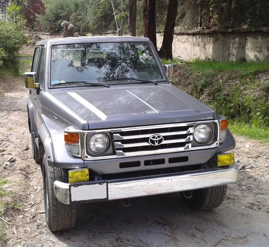

The bracket has two holes that are next to each other. If you put the bracket on the right (driver's side in RHD trucks) side of the bumper, these holes line up with the ones for the fog light. One hole remains unused, but this is not a problem if you tighten the bolts enough.
If you mount a fog light over the bracket, it remains firmly in place.
This is how it looks.
Hope this helps.

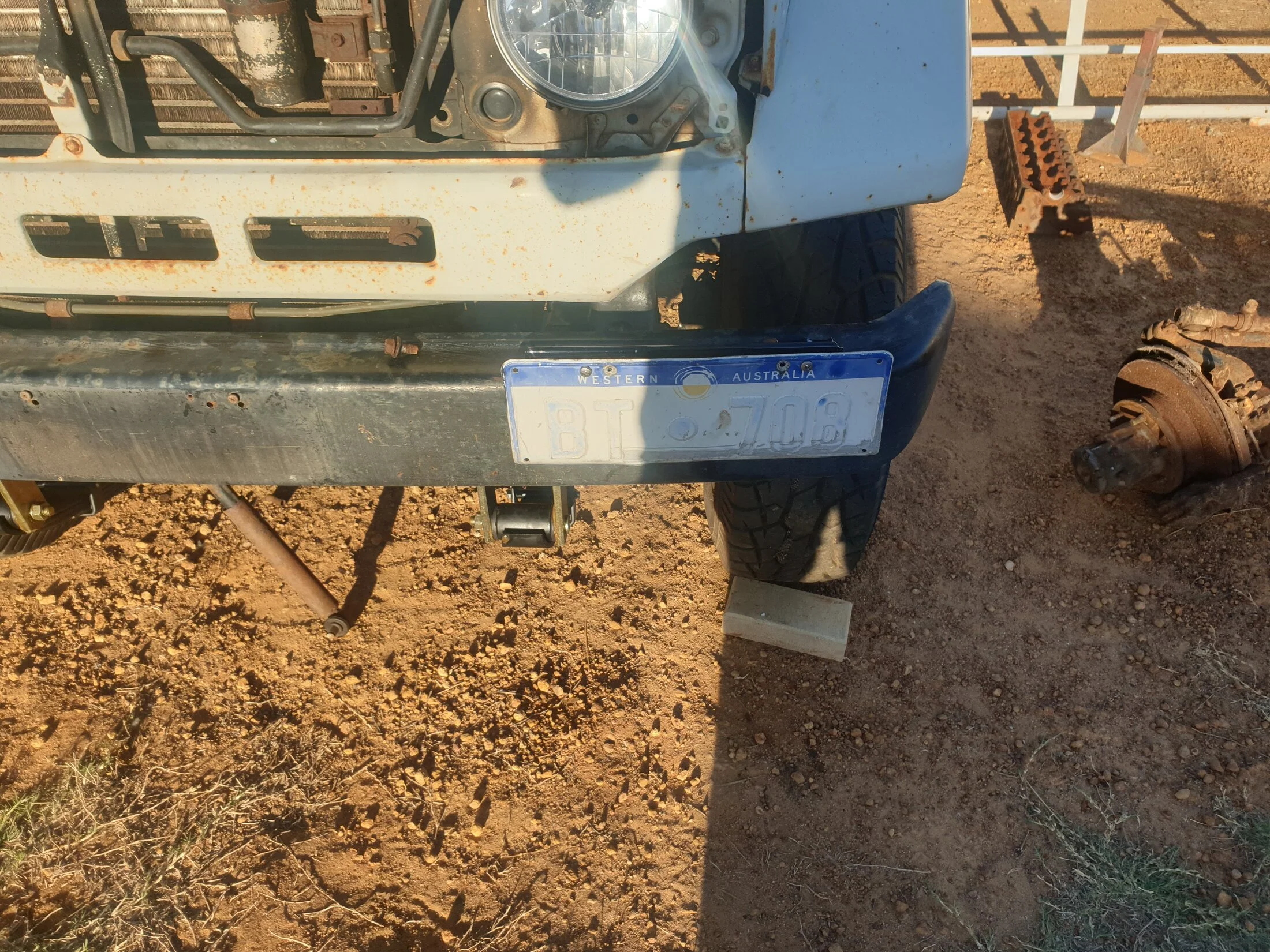

I am wanting to mount it like this but need to reference the mounting holes from the existing fog light holes, thanks
