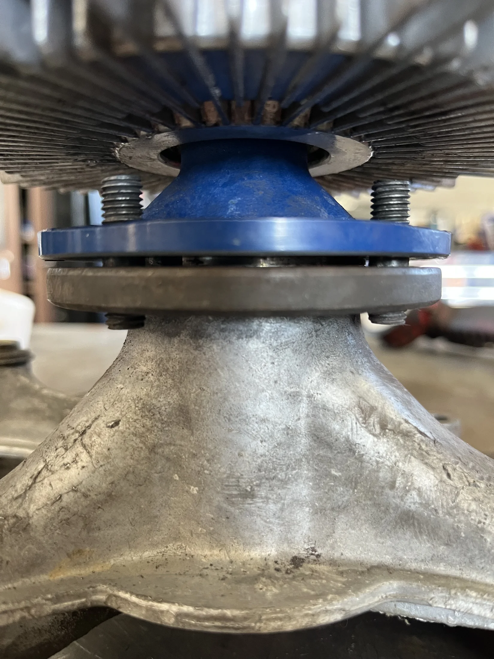

Hey guys, I had a fan bracket failure after I replaced my fan clutch and fan. My new fan clutch is not sitting flush on the new fan bracket so I tested it on the fan bracket it was filled and it looks like it is not fitting flush any ideas? What’s going on here? The fan clutch is a 2000 LC that I got from the dealerwhat do you guys think? I’m
it does not fit flush on the old fan bracket and the new fan bracket the photo above is me test fitting the new fan clutch on the old fan bracket

Aren't there some nuts used to secure the fan clutch to the fan Bracket?
Not sure you can say its not flush until you install those.
the knub could have some crud, rust on it or the fan clutch female could have some stuff in it
it is a fairly snug fit between the male on the bracket and the female of the clutch
