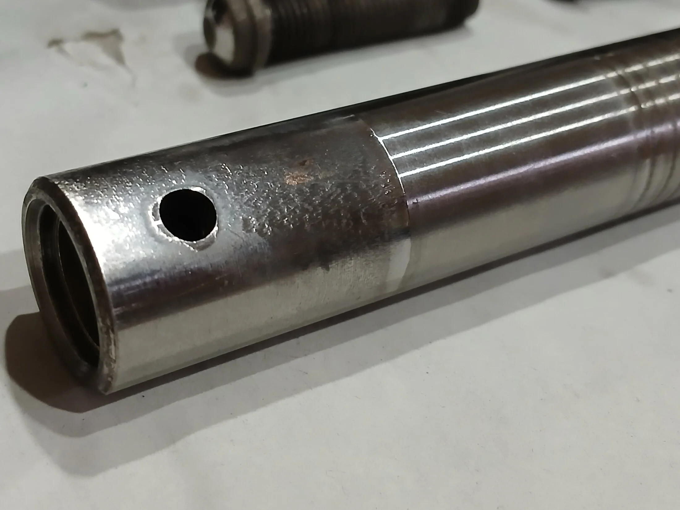

The rocker shaft itself however, has what I would regard as considerable wear where it sits in the cast iron support pieces which bolt to the head. And the internal bore of these support pieces has similar wear patterns. I'm no metallurgist, but to me the pitting would indicate corrosion, but there are only a few very small brown marks on the pitted areas. But could it also be from percussion? There is light surface rust on the rough cast surfaces of the rocker supports, but I had assumed this happened after the engine was parked up, and I don't believe it has run for more than a few minutes since then (I got the engine out of a half-cut which came directly from Japan).

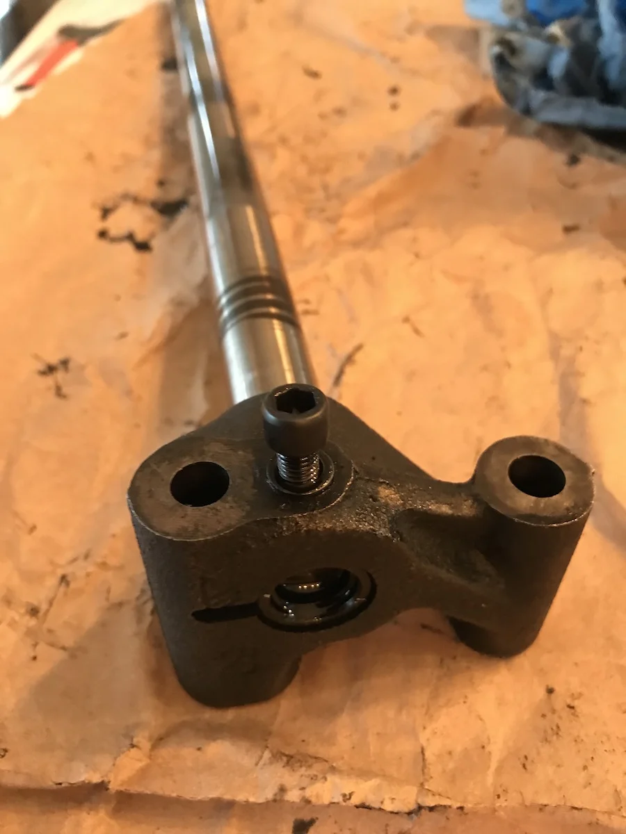

The rocker shaft - this is where it goes into the first (of five) support pieces:

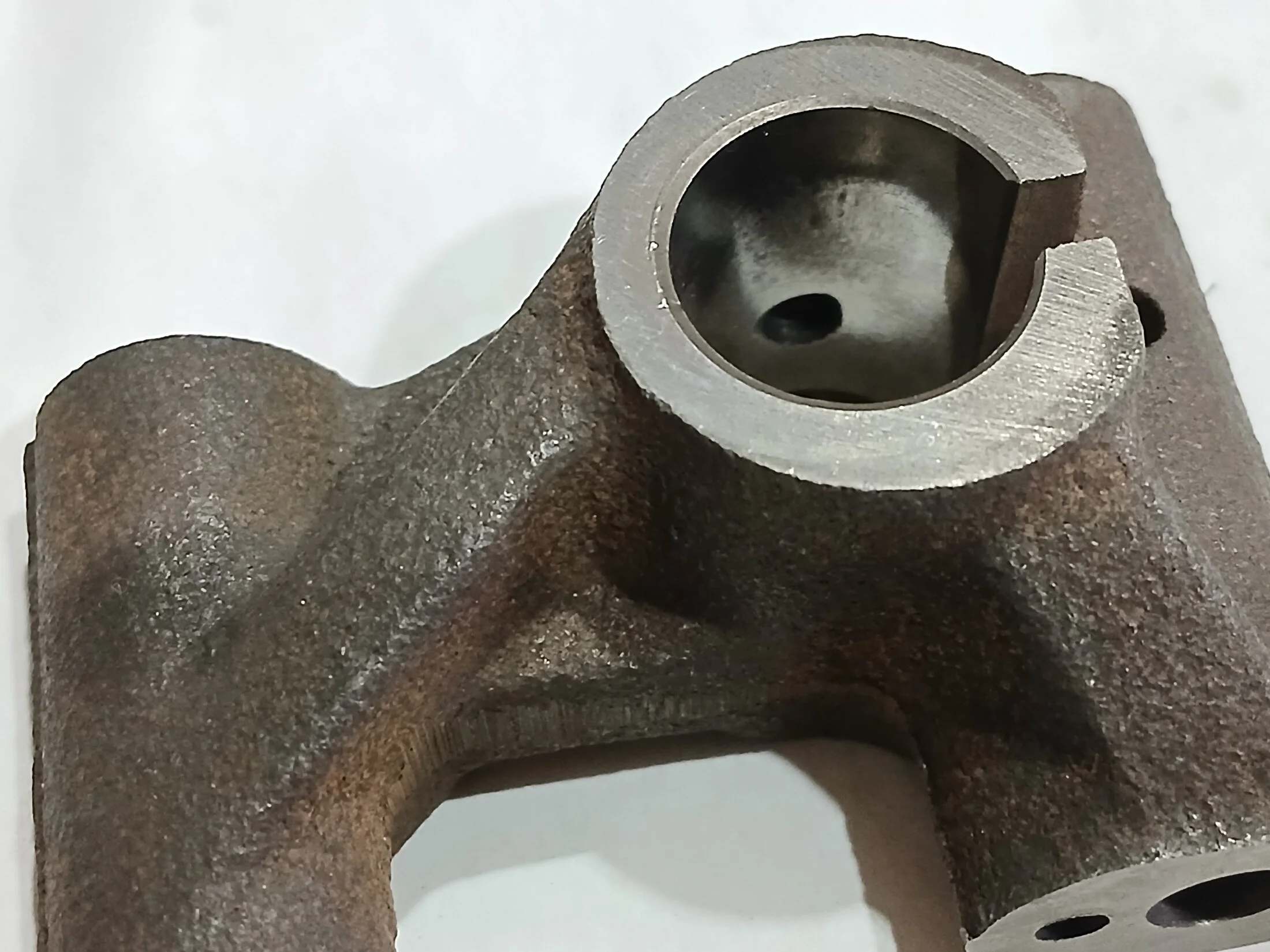

The first support piece (you can just see the pitting in the bore, and get an idea of the surface rust).

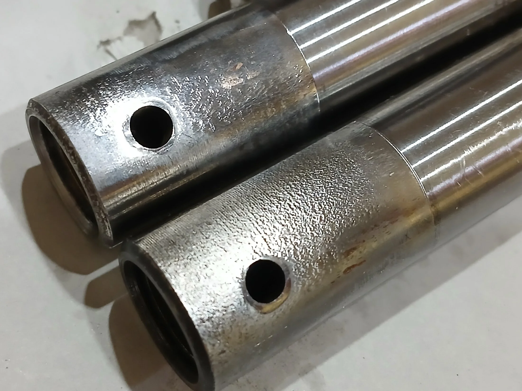

Here's the 3BII shaft (bottom) for comparison:
Judging by how severely my fingernail catches the edge of the worn area where the shaft passes through each of the supports, the 3BII shaft had more wear at the #1 and #5 supports than the 15B-T, but almost no wear at the #2, #3 and #4 supports. The 15B-T shaft has pretty even wear on the #1, #2, #3 and #4 supports, while the #5 support area has very little. I think this might just be down to manufacturing tolerances.
I was initially worried about oil pressure or oil starvation issues, but the rocker bores in the 3BII are more worn than the in the 15B-T rockers, so I don't think that is the case. The 3BII was well maintained and I think did a lot of highway driving. Maybe the 15B-T spent a long time idling or doing lots of short joureys.
So it looks like the wear is normal. To be clear, the shaft does not rotate in these supports, the rocker arms move on the shaft. So the only movement can be lateral (within the oil clearance in an up-and-down sense in reaction to the pressure acting against valve spring tension), or rotational within the locating-pin to rocker shaft hole tolerance.

Having quickly searched, the old 3B appears to have aluminium rocker shaft supports and cast iron rockers. The later 3B/14B/15B has it the other way round. So maybe this problem did not exist before the update.
Looks like fretting wear. Lots to read about if you want to look into it. I could be wrong though as it's been a long time since I wrenched for a living.
Thanks! I've had a bit of a read and think you got it spot on - the rocker shaft would be a prime candidate for what they describe as the causes of fretting. I think it's down to the fact it's not a particularly tight fit between the shaft and the supports, and the fact they are not really oiled. Seems like a poor design, but maybe having a tightly clamped shaft causes some other problems. And probably don't want to divert any oil pressure up at the top of the engine.
Seems like drilling a hole through the top of the support to expose a part of the shaft to catch more oil might help, but I think I'll just run with stock pieces - if I can get new supports.
I reused mine, engine had done 485,000kms.

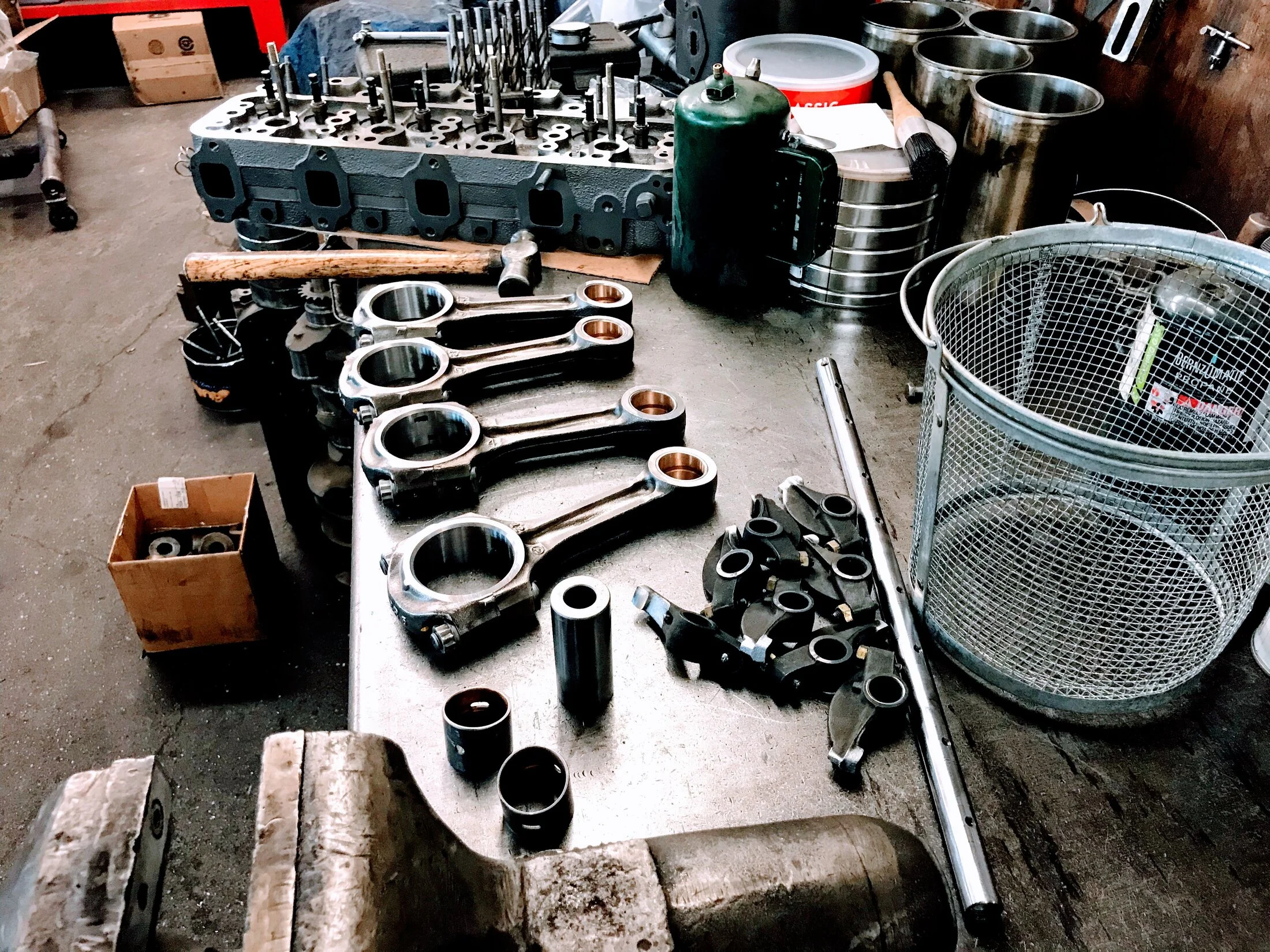

Best picture I have of wear but I don’t remember how deep the bracket wear was.

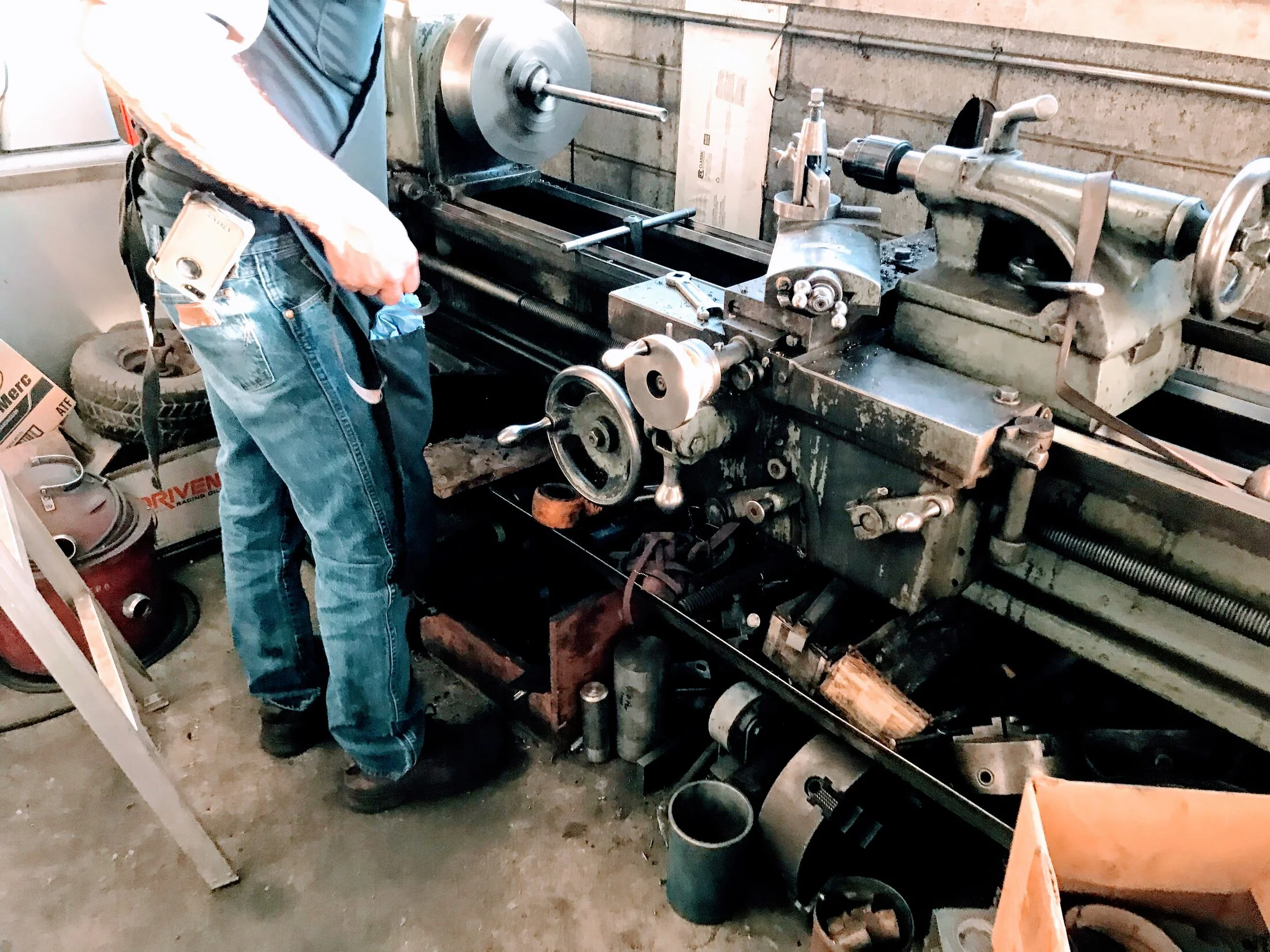

Machine shop cleaned it up.
Thanks for sharing that, interesting to see.
