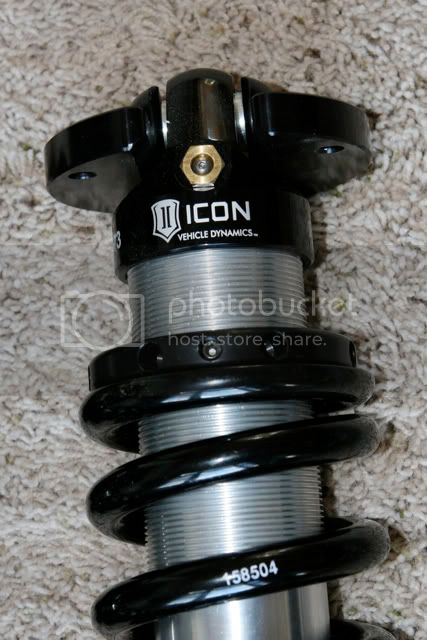

As Bud and I talked through my "tummy tuck" modification, he let me know that he was the newest distributor and serving the East Coast. Then I found a local FJC owner who was looking for a cheap pair of OME's, so we did the deal and I had Bud order me a set of the ICON coilovers. Well, when they arrived, I could here the choir sing. What a SWEET set of coilovers. Beautifully designed and manufactured in the good old USA...
Right out of the box...
Can you hear the angels singing...

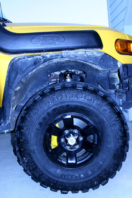

Thanks to Bud at Budbuilt for getting them ordered for me. The installation was as straight forward as could be. They gave me the exact same lift as I had with the OME 886's out of the box, 42.25" from the ground to the fender wells. Only did a quick road trip around town to make sure the install was good, I'll follow up with a road/trail report in the coming weeks...
So the questions is, did the newly installed compressors complete this swap in less time than it would have otherwise?
Now the impact wrench works how its supposed to and I don't have to listen to the compressor run constantly. But, what helped most was the girls doing the passenger side after watching dad to the driver's side. I only had to go over and finish things up here and there or get things broken free. Otherwise, they are getting pretty skilled...

Jerry, what's the overall diameter of those at the coil? Like, if you had to stuff them through a hole in an upper fender, what size hole would need to be there?
Sorry it took a while to reply. I "eyeballed" them, safely fit in a 4.5" hole, maybe a 4.25"...
