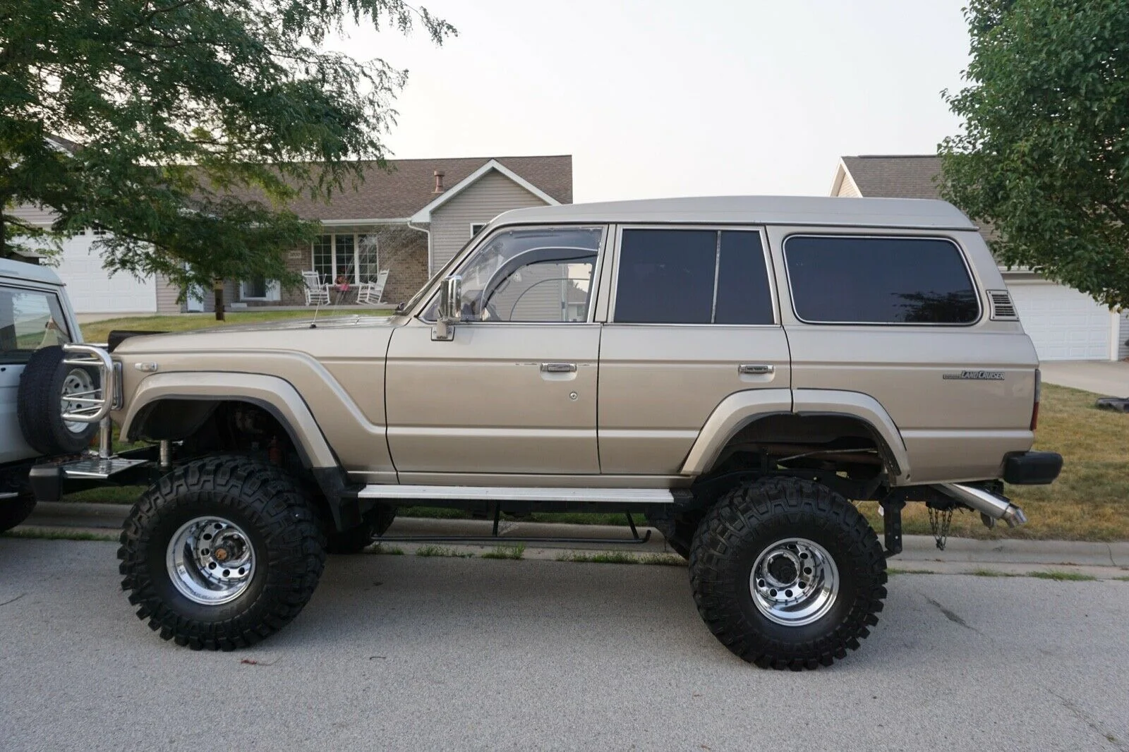

My favorite hj61 is a rig that has come up for sale multipole times is this
