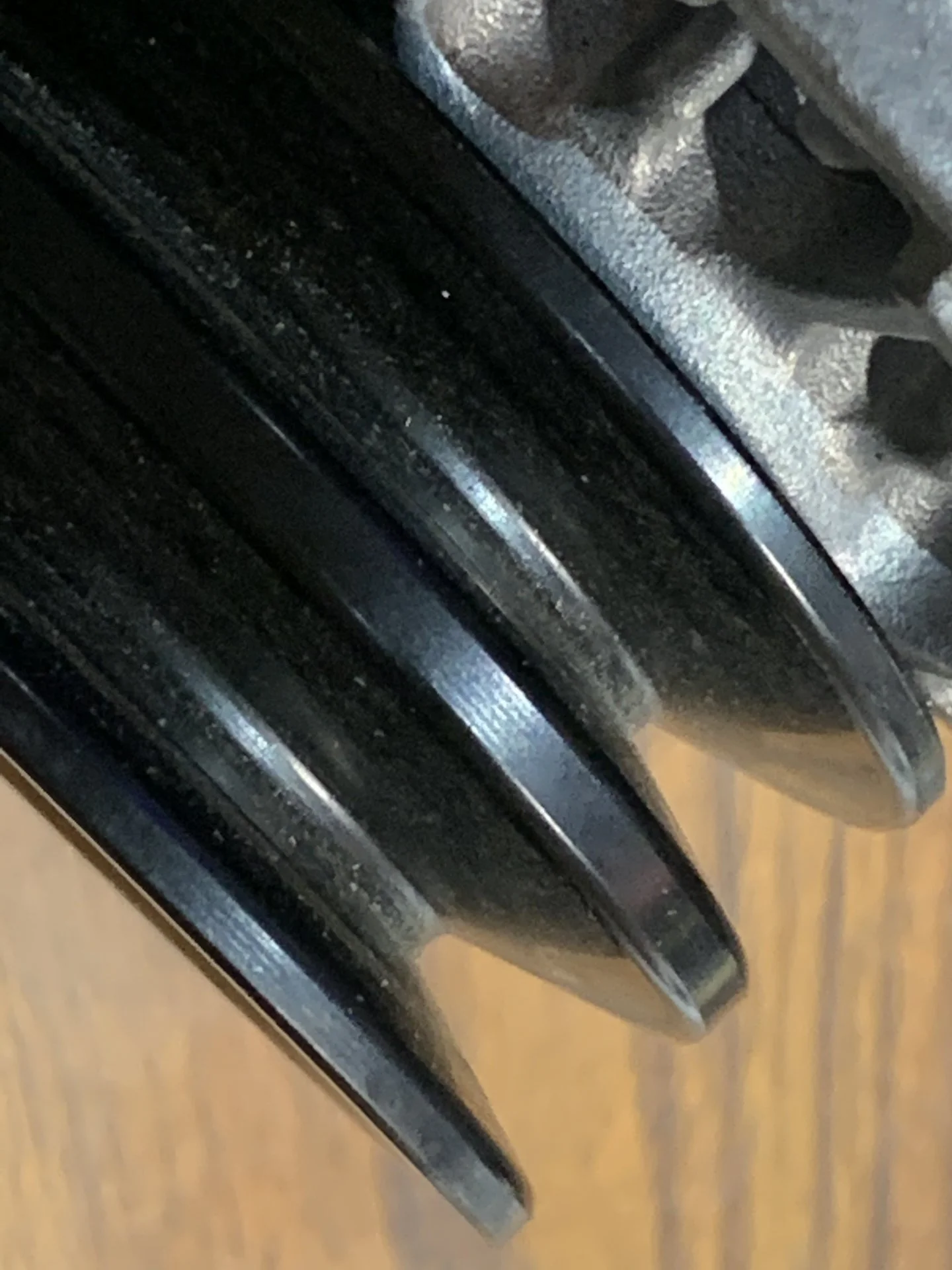

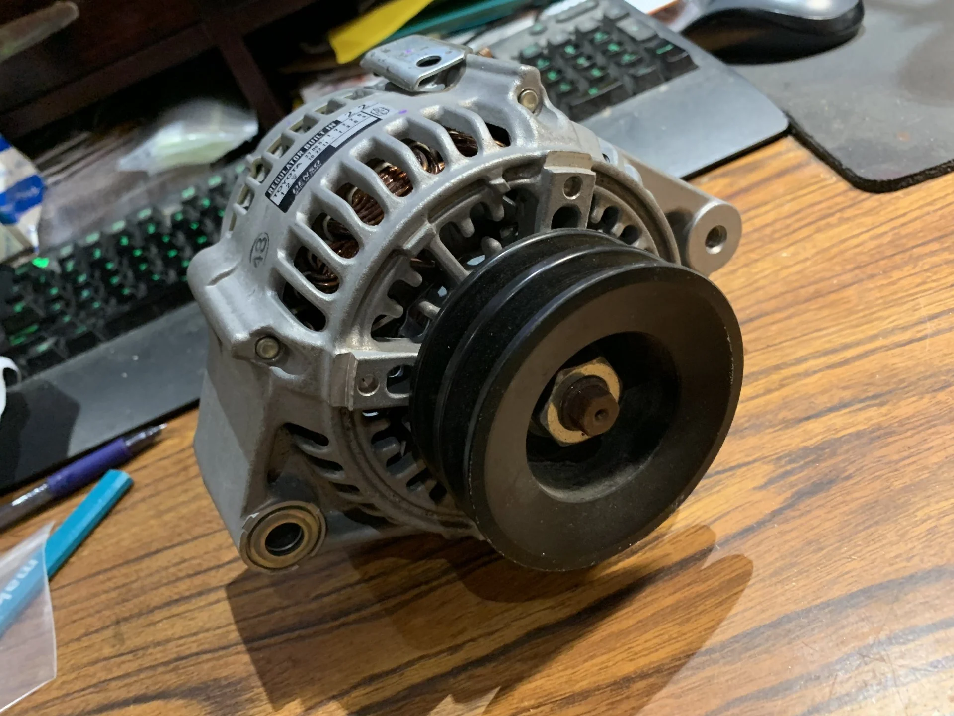

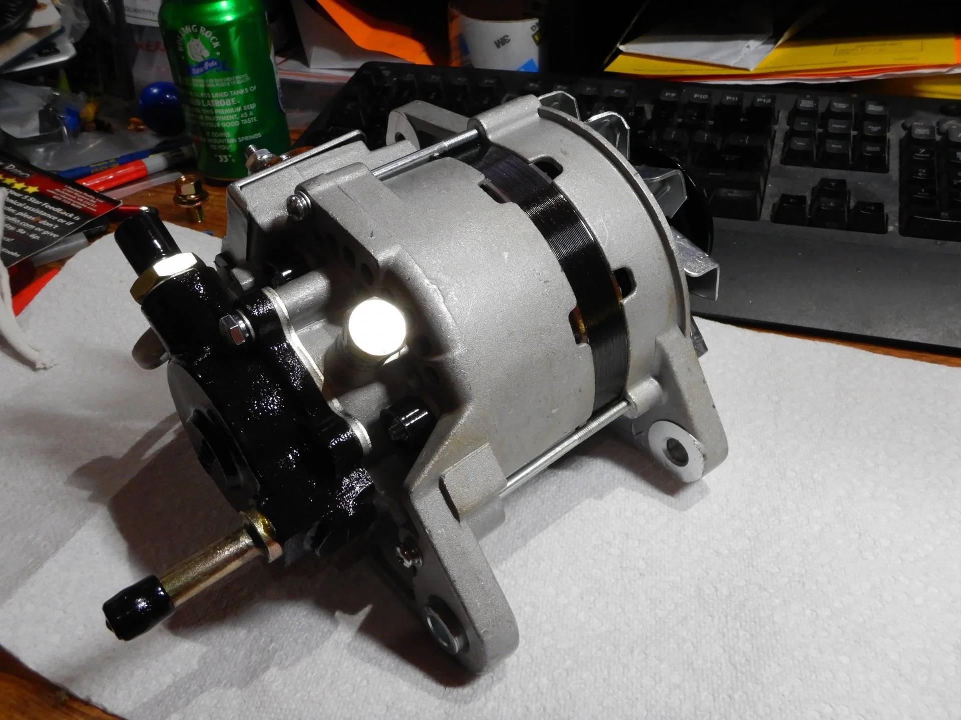

That looks good, for my needs i would have to mount my current single pulley on it for correct rotation speed.
how many amps dose it produce?
price seems fair to me.
I’ll have to measure the distance between the ears to see if it will fit.

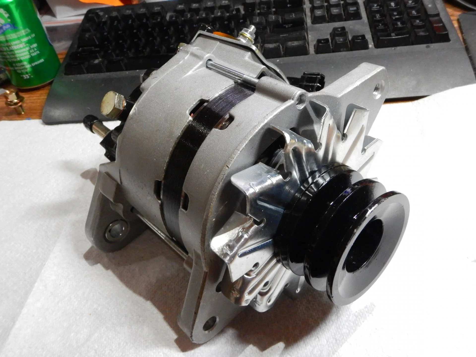

her is what i know and what i am un-certain about as well
- i have run into this before like 2 times only
- the solution was this :
- using this NOS DENSO 100% NEW NOT Reman in any way to be clear ..........

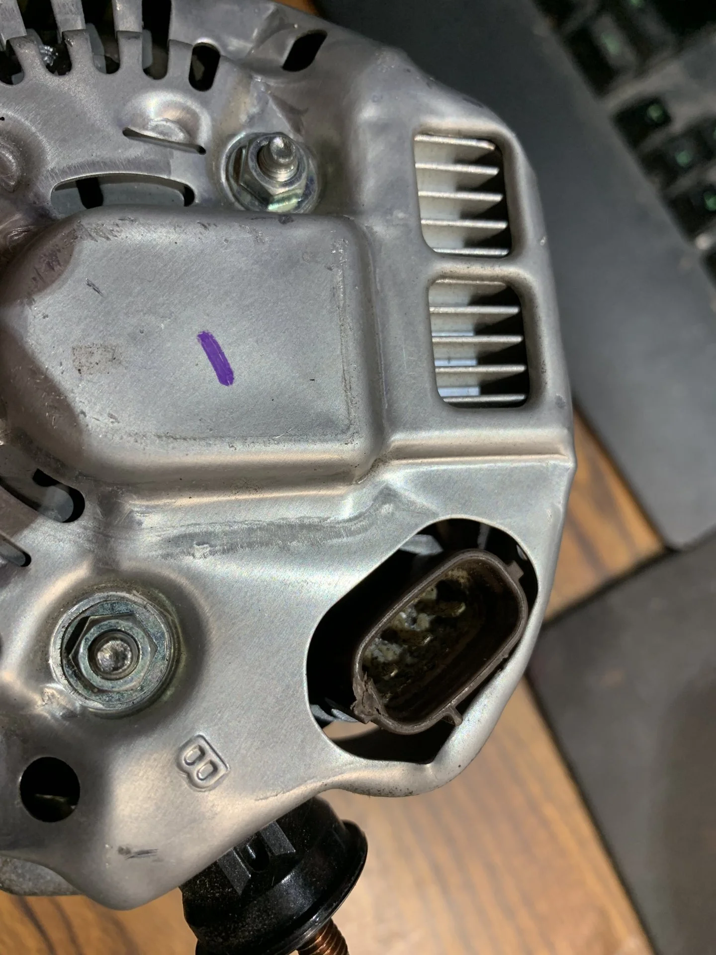

- u install a pig tail adapter from the oval 3 pin on MY unit to the round 3 pin connector on your engine bay harness
- the profiles are the same out side housings
- i do NOT know where to source the pigtail adapter ?
- we need to confirm the AMPS ratings of both your 17040 and my unit
this is about all the tech i know of
both times this solved the issue and worked
here are pics
thanks for reaching out
matt

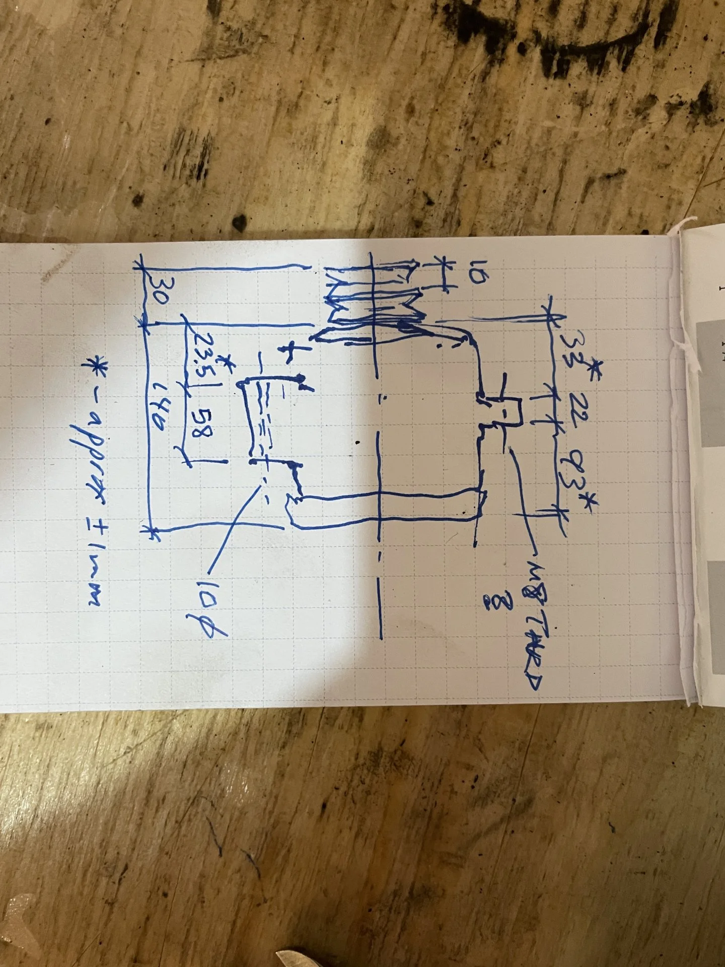

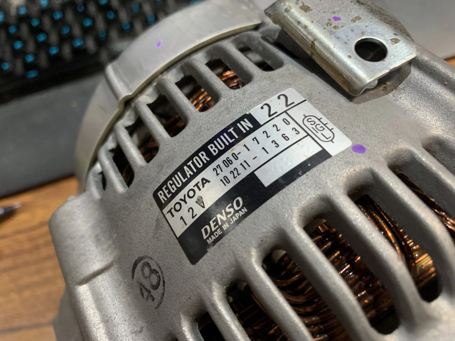

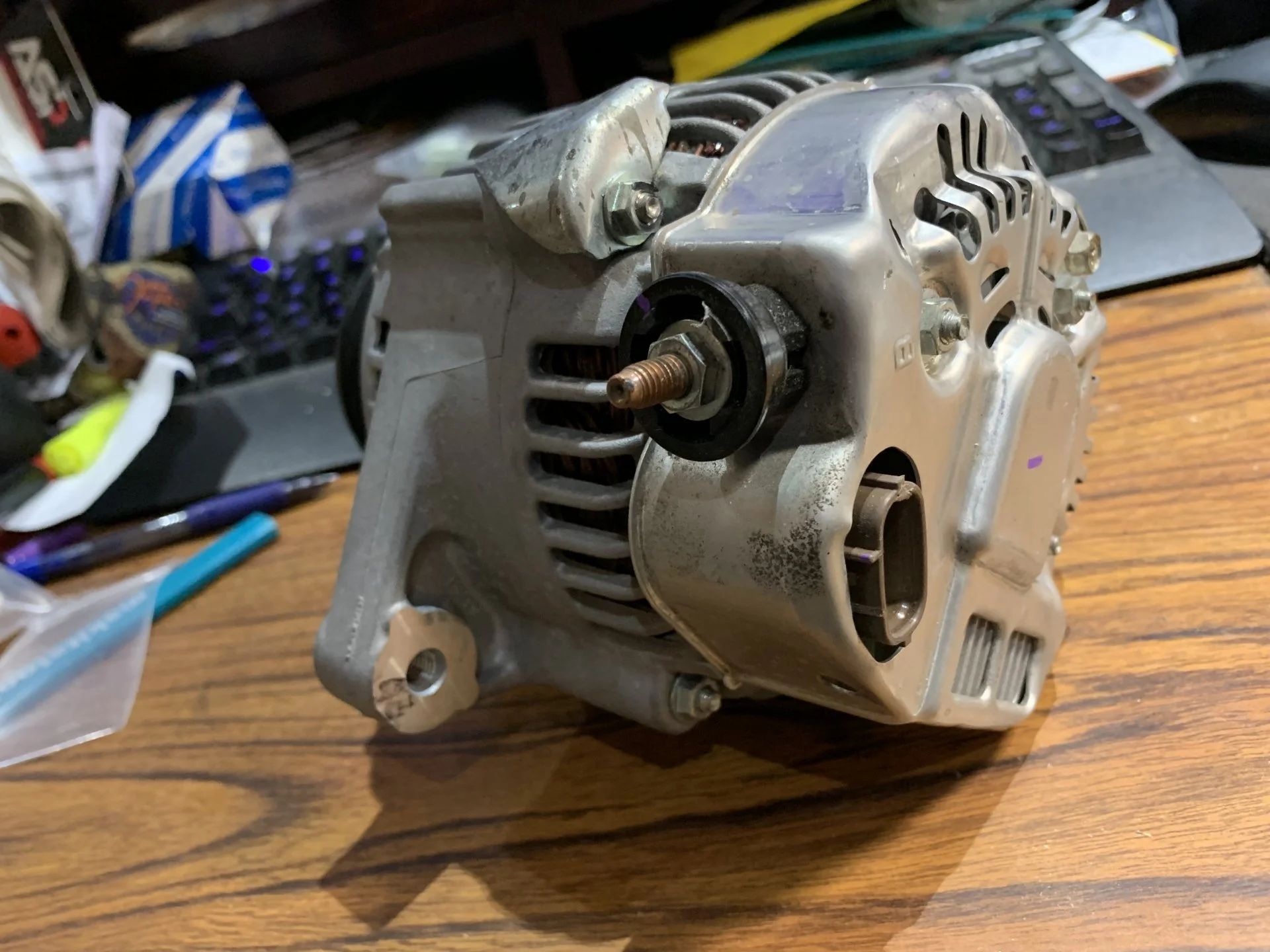

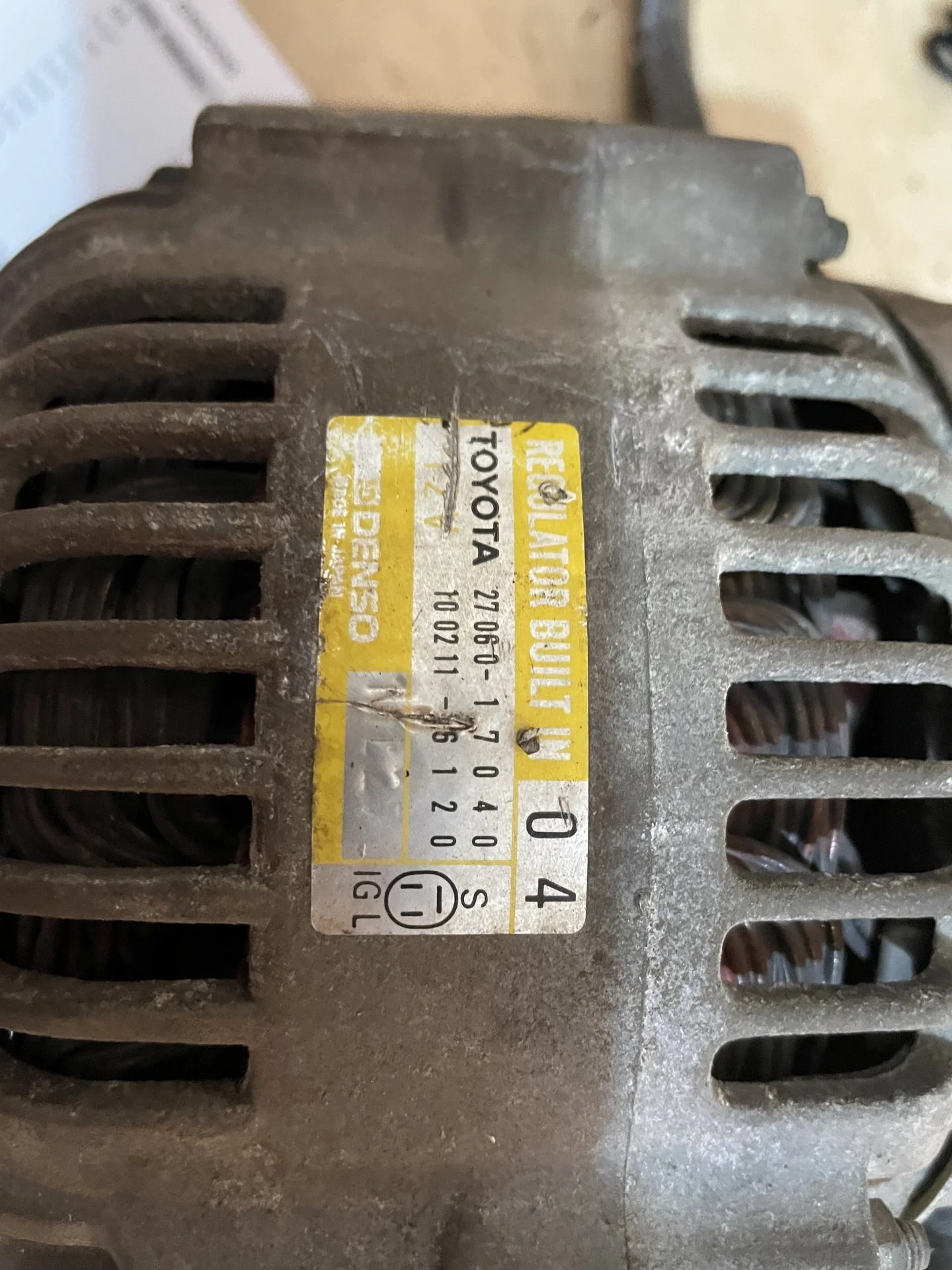

That's cool. How do you know the casing dimension is the same as the 17040? I think amp rating of this can be confirmed from DENSO website. Pretty sure I've seen pigtail adaptors for this somewhere. Let's keep going down this rabbithole! Here's some pics. Housing and mount dims need to match obviously. No room behind pigtail due to air intake location. Here's some pics...
Regards and Thanks

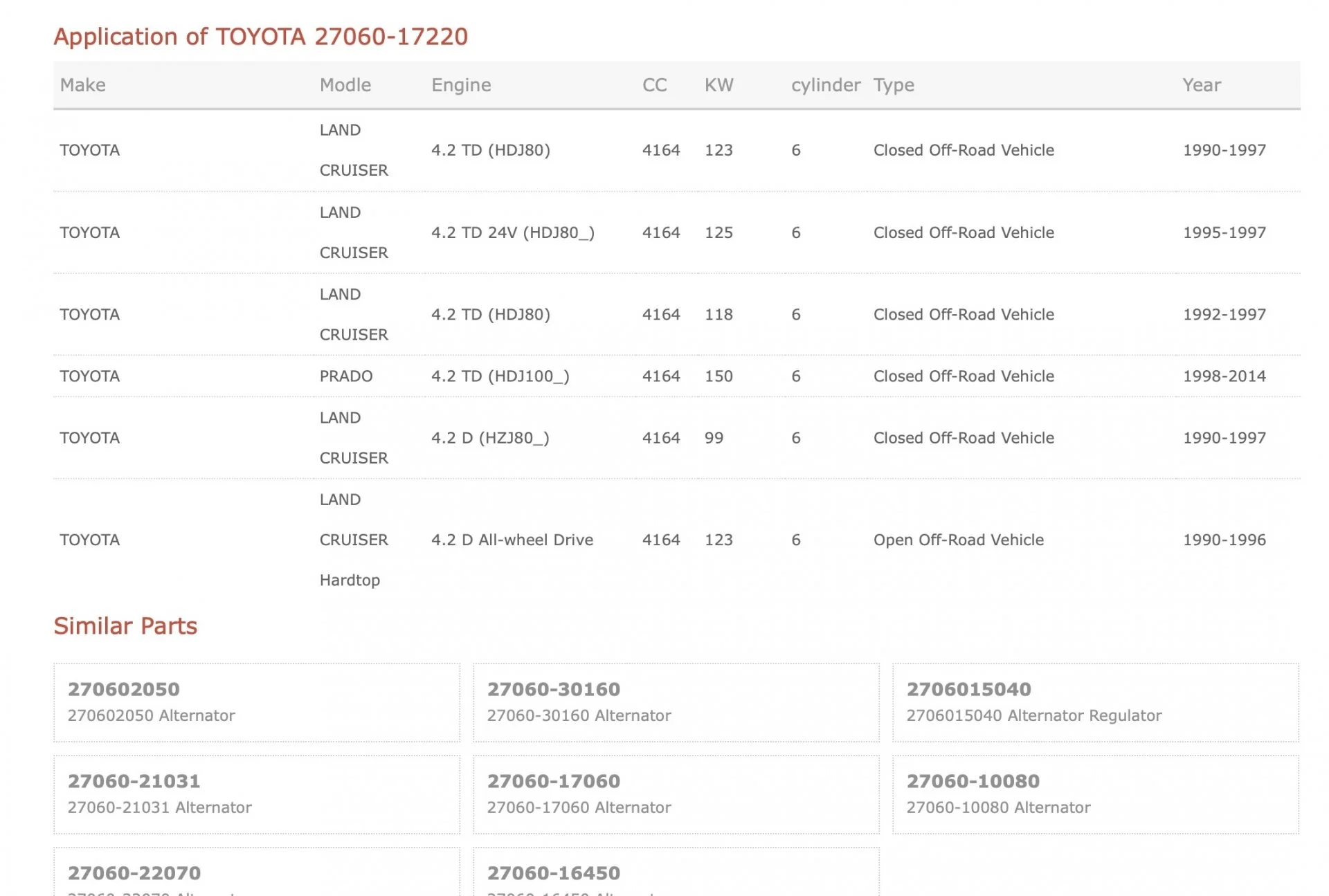

Found this on yoyopart.com so it is used on the HDJ80 with 4.2L TD...

That's cool. How do you know the casing dimension is the same as the 17040? I think amp rating of this can be confirmed from DENSO website. Pretty sure I've seen pigtail adaptors for this somewhere. Let's keep going down this rabbithole! Here's some pics. Housing and mount dims need to match obviously. No room behind pigtail due to air intake location. Here's some pics...View attachment 2809506View attachment 2809507View attachment 2809509View attachment 2809508
i know what i stated as TECH teq Facts because i have been involved in this EXACT 27060-17040 NLA / DiSC situation 2 times in last 5 years
however i DO NOT KNOW EVERYTHING 100% ,. nobody does , ........ 🤔
both MUD members and clients never called back after with ANY concerns of any kind ..........
and also : \
PLEASE Read the below TECH Images carefully ...........
i specialize in Making S ##it Happen for my clients and fellow mud members ....... 😇
