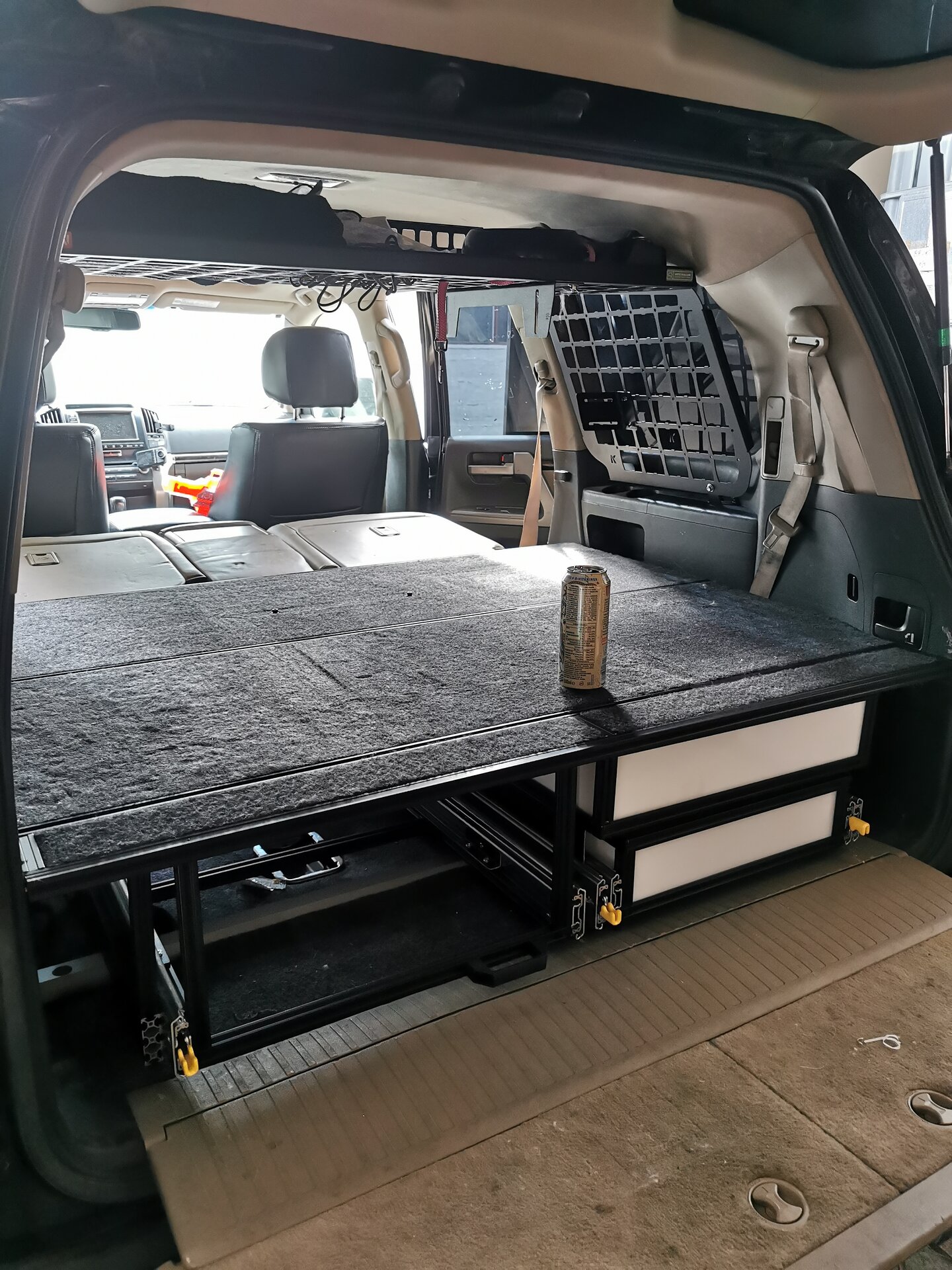

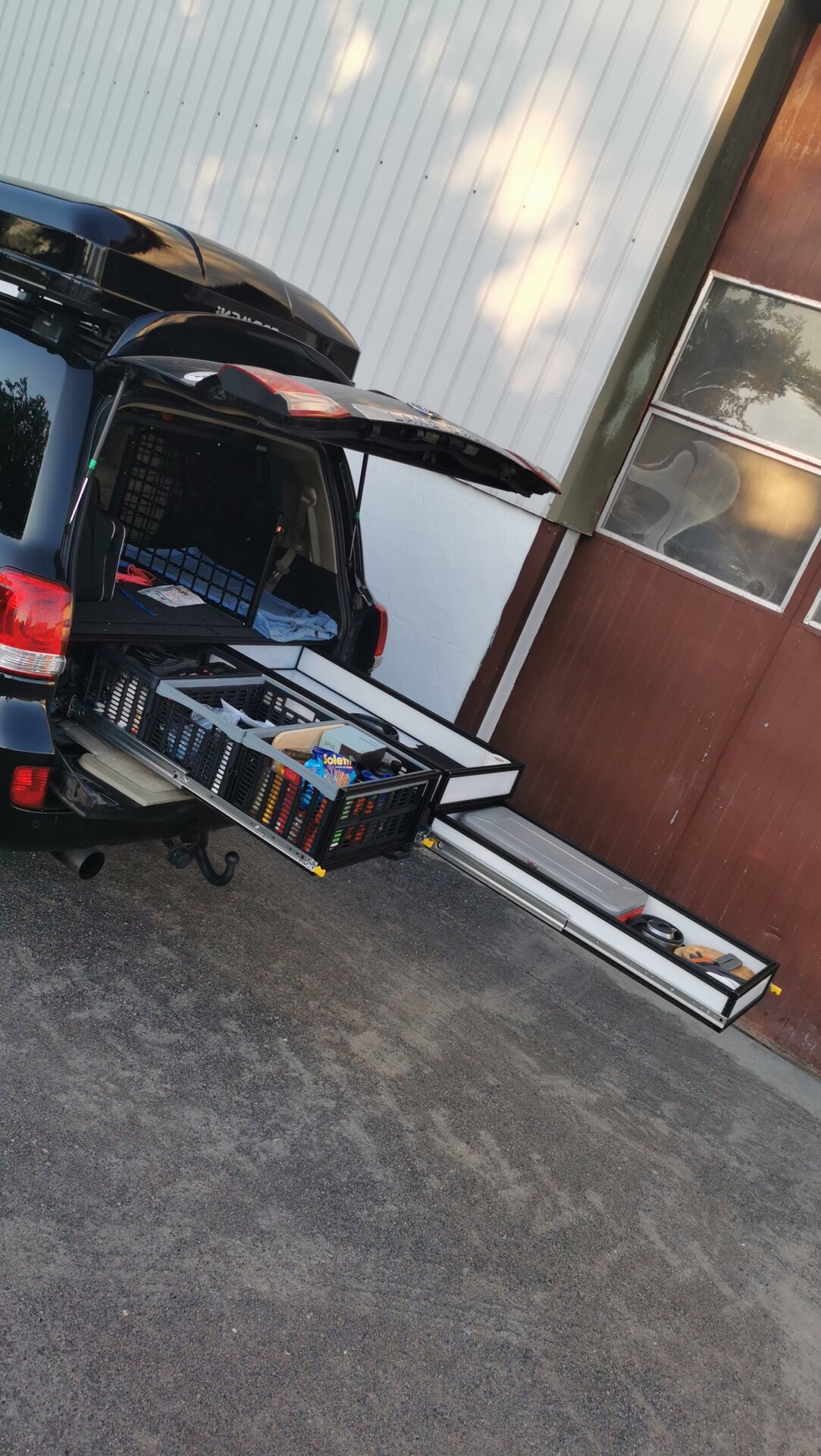

Starting to get the drawer system dialed in. I've made a few in previous cars, and this time I went with 2020 extruded aluminium profiles.
The whole floor of the trunk is raised about 30cm, with one drawer housing 3 removable cases on the driver side, and a double drawer for camping on the passenger side.
The drawer are lined with polycarbonate plates fitting right into the extruded profiles.
Above the raised floor a cargo divider from Kaon will do the job as cage for the puppy on the right side. The fridge slide is also fitted to the profiles in the floor and can be removed with ease

Wow! this is an excellent build! If you were to offer plans, I'm sure you would sell many of them! Kudos!
Thank you!
But it's nothing fancy or innovative about it, it's just a frame and some drawers😅
