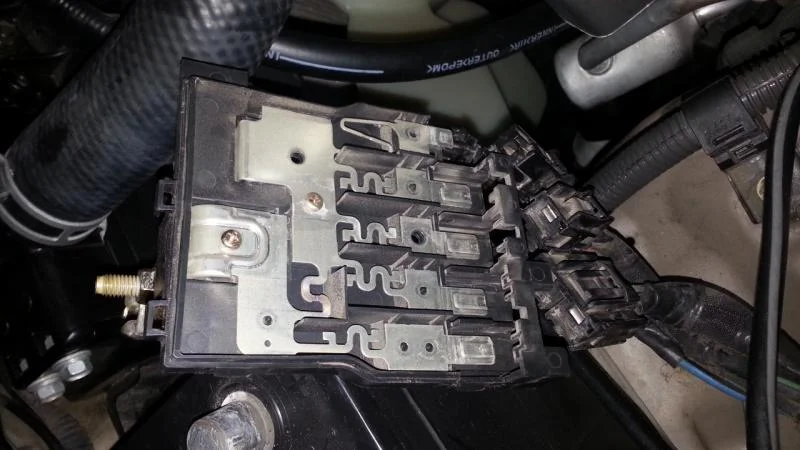

Did you check the fusible links at the positive terminal?
attachment.php
Body control
Module fuse?
