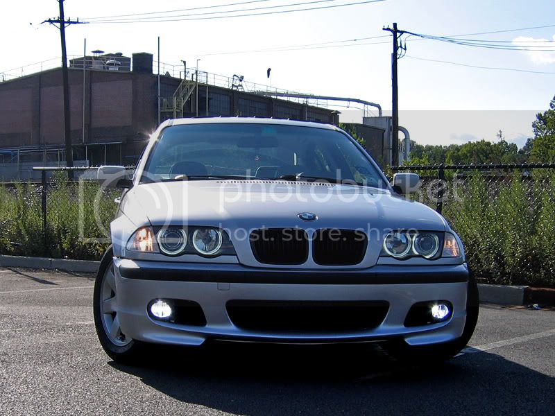

Oh, here is a pic of the Mtech II bumper. Wow....I can't even leave the wife's car alone now! :grinpimp:

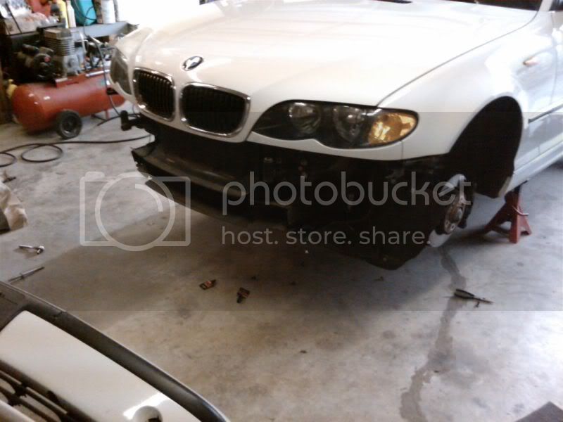

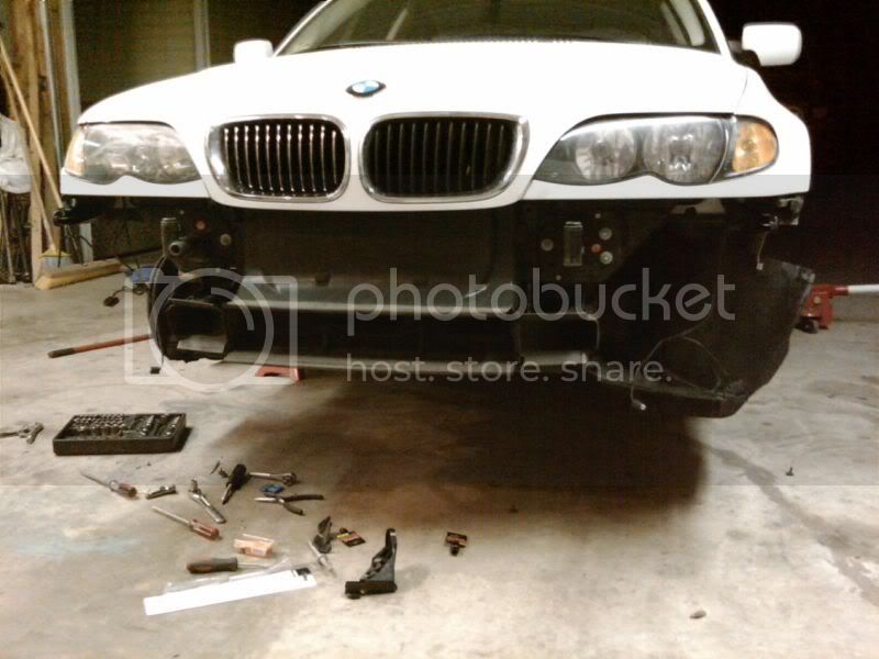

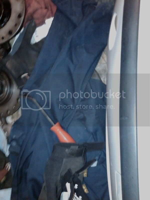

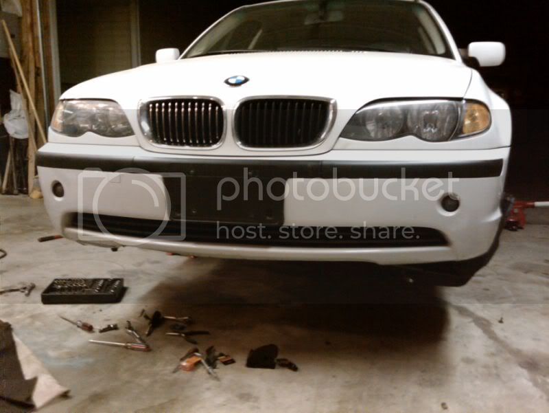

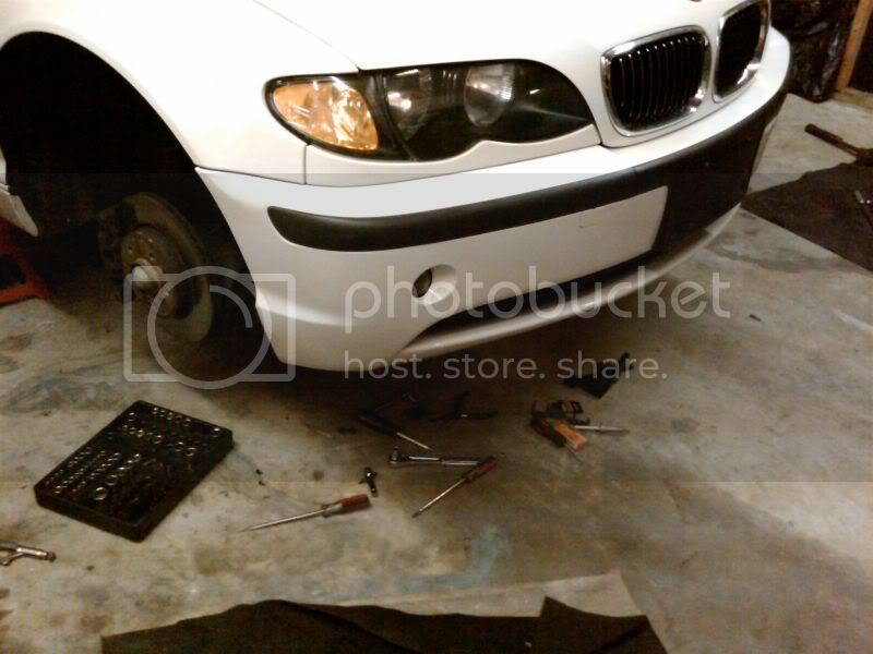

Took off the bumper yesterday evening and changed out the bracket that was broken and readjusted the fog light bracket. I also gave the heat gun method a try and it worked! It was difficult to get something in behind the metal bracing on the bumper to push out on the plastic, but by heating up the outside of the bumper and pushing where I could reach, I got about...I'd say 90% of the crease out. No more gap on the side.....foglight lines up.....crease is all but gone.... Cost me $9 for the broken bracket at BMW, $49ish for a new lower inner fender cover, $4 for a T-14 Torx socket, and about $4 worth of new plastic rivets. I borrowed the heat gun from work, so I didn't even need to buy that. That's a whole lot better than the cost of a new bumper! :grinpimp:
See above for pics of the damage. Here are a few camera phone pics from last night. Not much detail.
Erica is in NJ visiting her mom and sister this weekend. I sent this one to her to make her nervous. :D
This one is the bumper on my workbench when I was just about done w/ the heat gun.
Here it is back on the car:
One showing the corner. No more gap.
