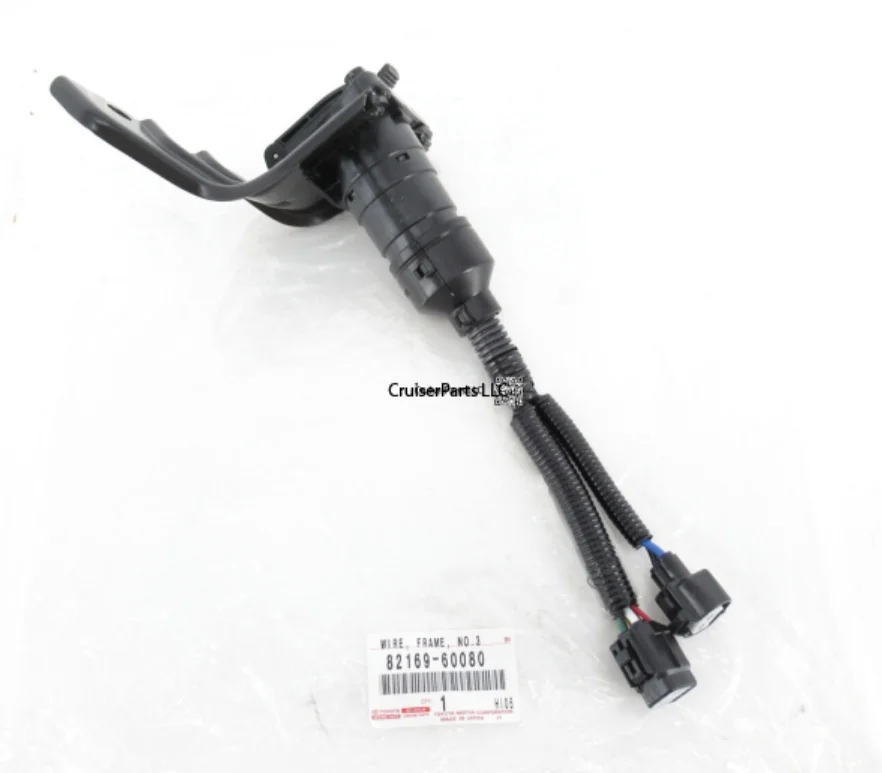

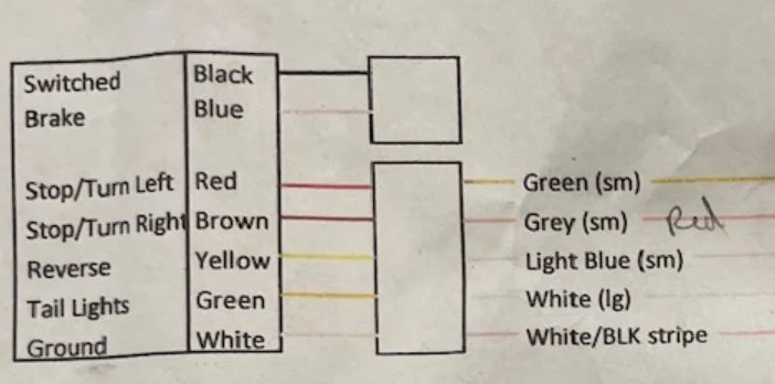

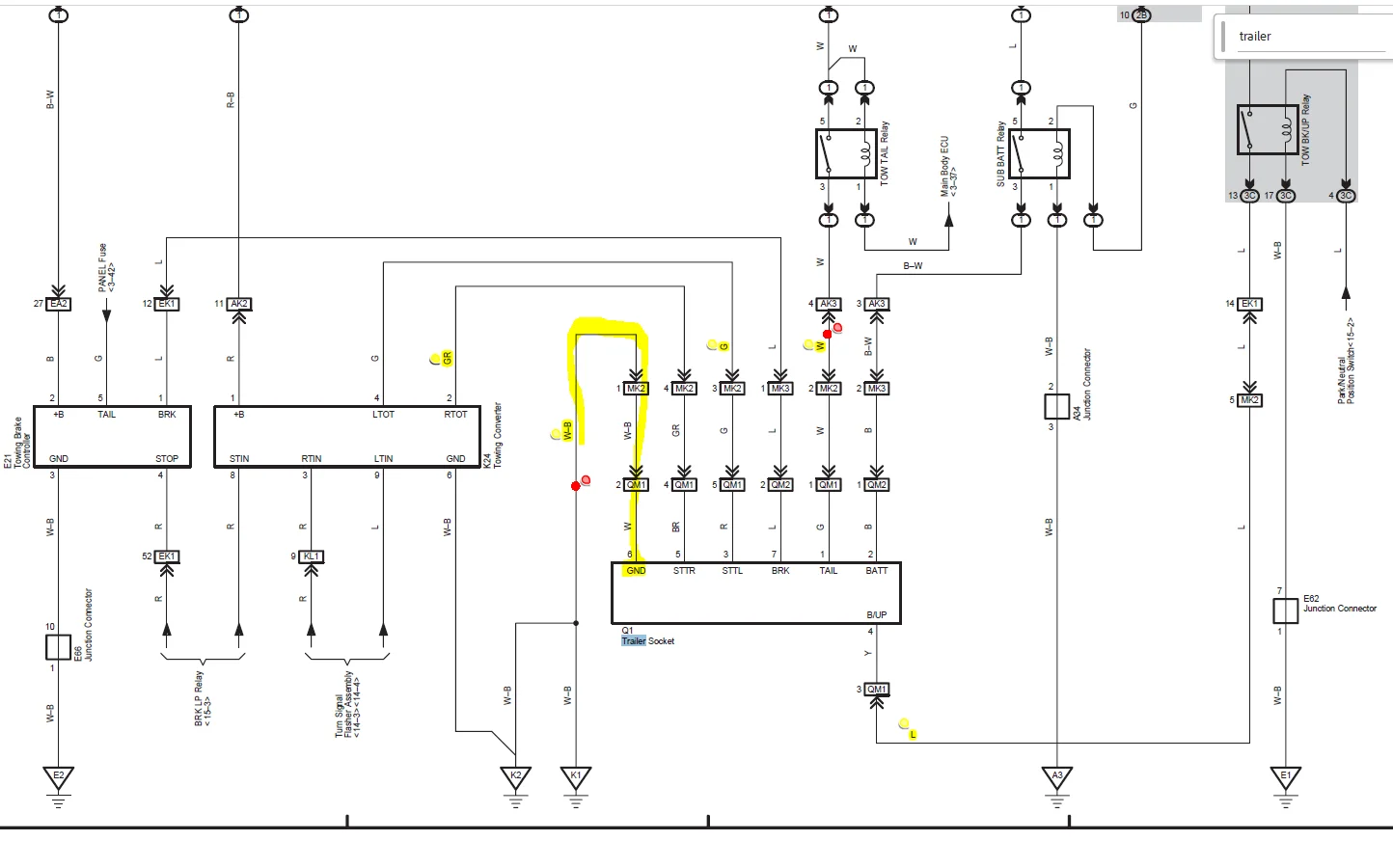

You want the White or White w/ black stripe wire depending on which side of the connector you are looking at:
The 7 pin trailer plug has two wiring harness connectors:
the ground is in the 5 wire plug. Unplug it at test both sides, and go from there.
I wonder if the easy fix will be a corroded connector. Did you thoroughly clean the connections in the LX receptacle, the 7-4 pin adapter, and the trailer 4 pin? Are all connectors in the harness shown in @kcjaz post clean and tight?
Yes, I scraped the “terminal” really well before I tested it. I will be pulling them 5 pin connector next and proceeding from there as kcjaz suggests.
