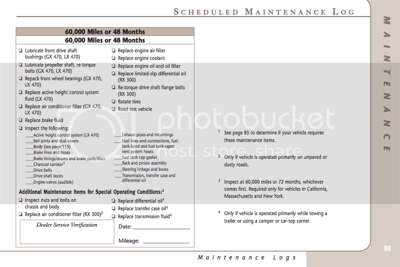

No AHC Flush Needed?
Sorry for the typo in the link. It wasn't working. I fixed it. Had an extra s. Here it is. www.toyotapartsdeal.com
What if your car has done 256,000 km?
Do you divide by 10,000 km for its service?
For AHC divide by 96560.6 km. Your fault for using the more-sensible metric system :flipoff2:
For other maintenance items you have to look at the service interval and divide/modulo by that (e.g. 144841 km timing belt).
