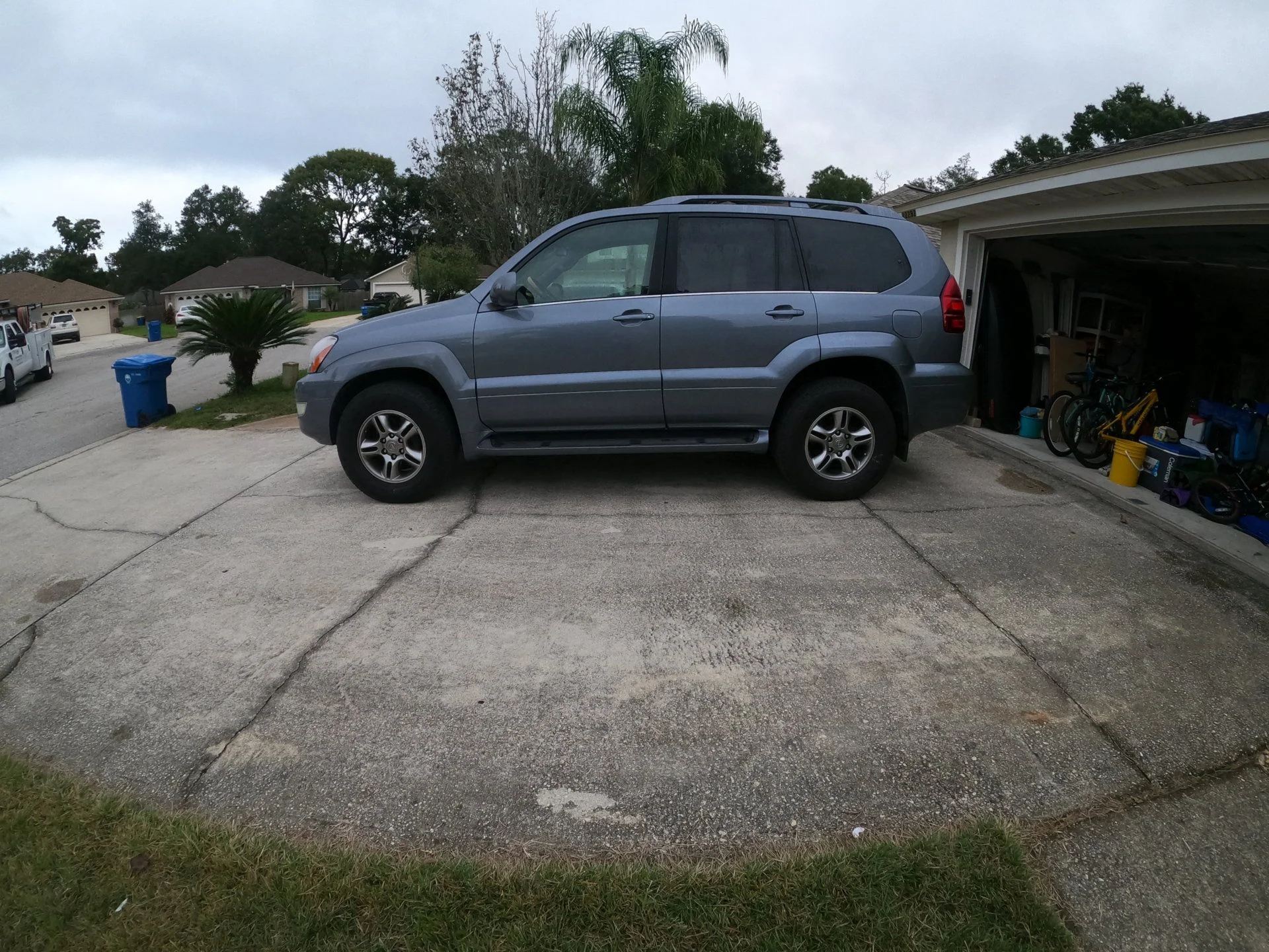

Hey guys, I’ve been a camper/hiker for decades but just started to get interested in overlanding. I’ve been reading everything I possibly can on here and other forums, talking to friends that do it and shopping....oh the never ending comparisons!!!!
Looking for advice.
I bought GX470 for this build. Not trying to build a tank for the outback or rock crawling. I live in Florida and spend time in the North Georgia and NC mountains. Want a 2.5-3” lift, airbag delete, but I’m not sure who to go with. Thinking OME or Dobinson’s based on reviews. Don’t quite understand the “stages” of these kits...total newb to off-road vehicles, but not to wrenching. Don’t want to break the bank, this is for fun with the family. Probably going to have a significant load with a wife and three kids.
What brand and lift has worked for you?
