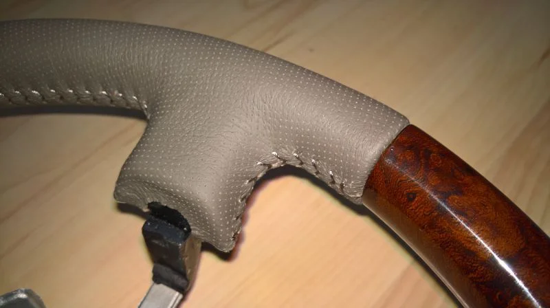

I can't tell from the photo but is that wheel perforated?
I've been wanting to purchase one of those Taiwan wood wheels as well. The original wood is completely cracked on mine. I've replaced a steering wheel in a previous F250 with one of those wood wheels and the quality was near stock, typically they use older steering wheel bases.
First, concerning the use of older bases -- my OEM wheel does not have the little bumps at 10 and 2, but maybe the LC did, or other LXs beside my 2000?
Second, yes the leather is perforated. I'd say the holes are a little smaller than on my current, original, wheel.
And just to be clear, this isn't the same seller as frequently has $299 LC/LX wheels. I have never seen one of those in person so I can't compare quality of the products.
Edit: Included a bit of detail so you can see perforations and quality of work. The sort of white highlights on the thread is a function of the crappy flash on my phone camera.

I purchased and installed the same steering wheel (in gray) on my 2002 LC last year and can say I was more than impressed. I think I paid $199 but the quality far surpassed my expectation. I had to do a little light trimming to the small rubber area (2nd picture above) to make the airbag mount flush with the wheel, but it fit perfectly after that. The color wasn't a 100% perfect match with my 13+ year old interior, but it's close enough where no one notices other than myself. Overall, for ~$200, it's well worth it IMO. I'll post some pics tonight.
Had to do a bit of rubber trimming myself. Thanks for the heads up as I would have wondered if it was something dumb I was doing - and delayed putting it on - thinking it over before doing what had to be done. But with your note I went right to it and the wheel got changed out in less than 30 minutes. Same issue with color match, but with a 16 year difference what could I expect - I think even a new OEM wheel would have issues. Overall - I'd do it again.

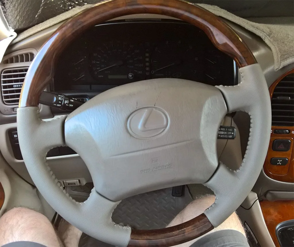

Here's mine, the interior color is OAK. The wheel and airbag looks darker in person, the color here is a function of phone camera flash and accents (IMO) the color differences. I'd say the color is a very good match considering how many years the truck sat in the Florida sun, but then again I don't have anything near original to compare & contrast. Try to ignore the ink marks on airbag cover. They were left by my granddaughter while pretending to drive and finding an ink pen in grandpa's console.
full
full
Looks great! I'm sold.
Thank you for the details! The wheel looks to be good quality.
