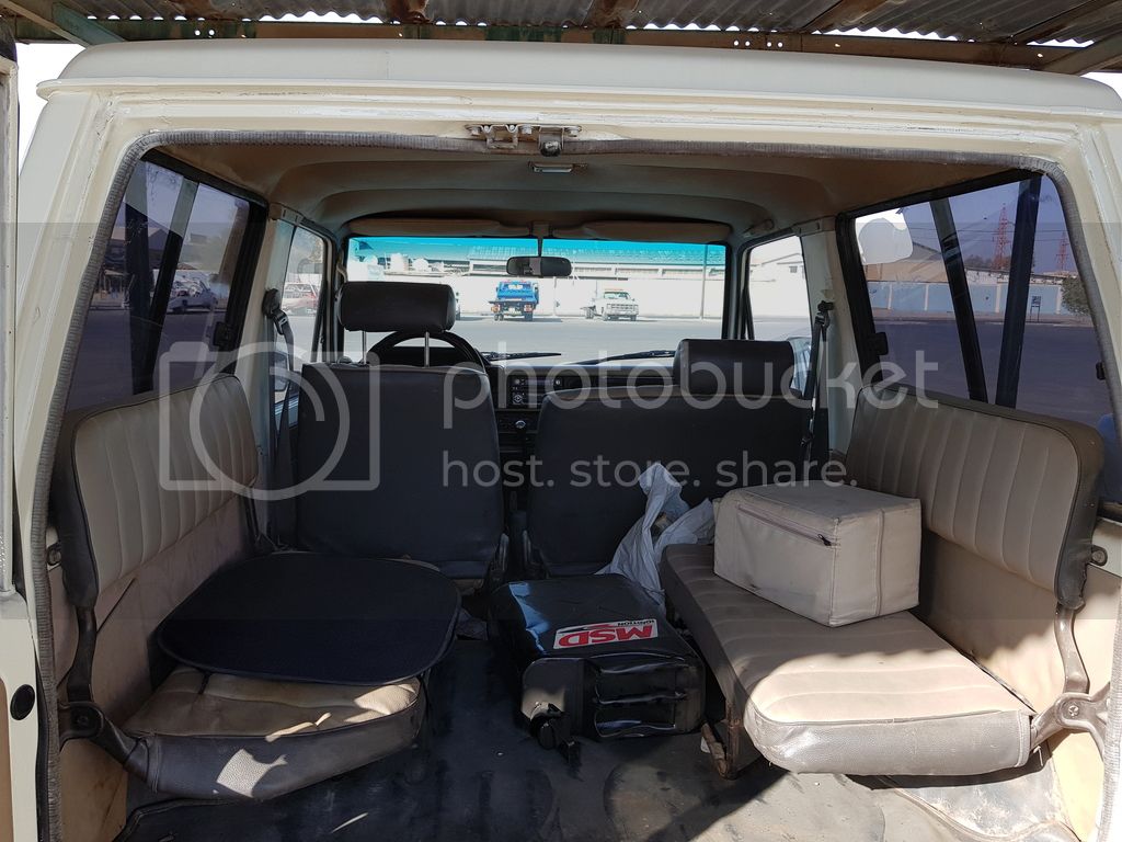

Love the rear seat set up. You can carry a lot more when folded up.

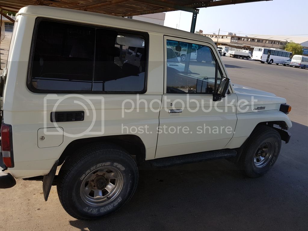

Nice find. Looks clean. It has full floating rear axles.
Rear jump seats provide a lot of useful space.

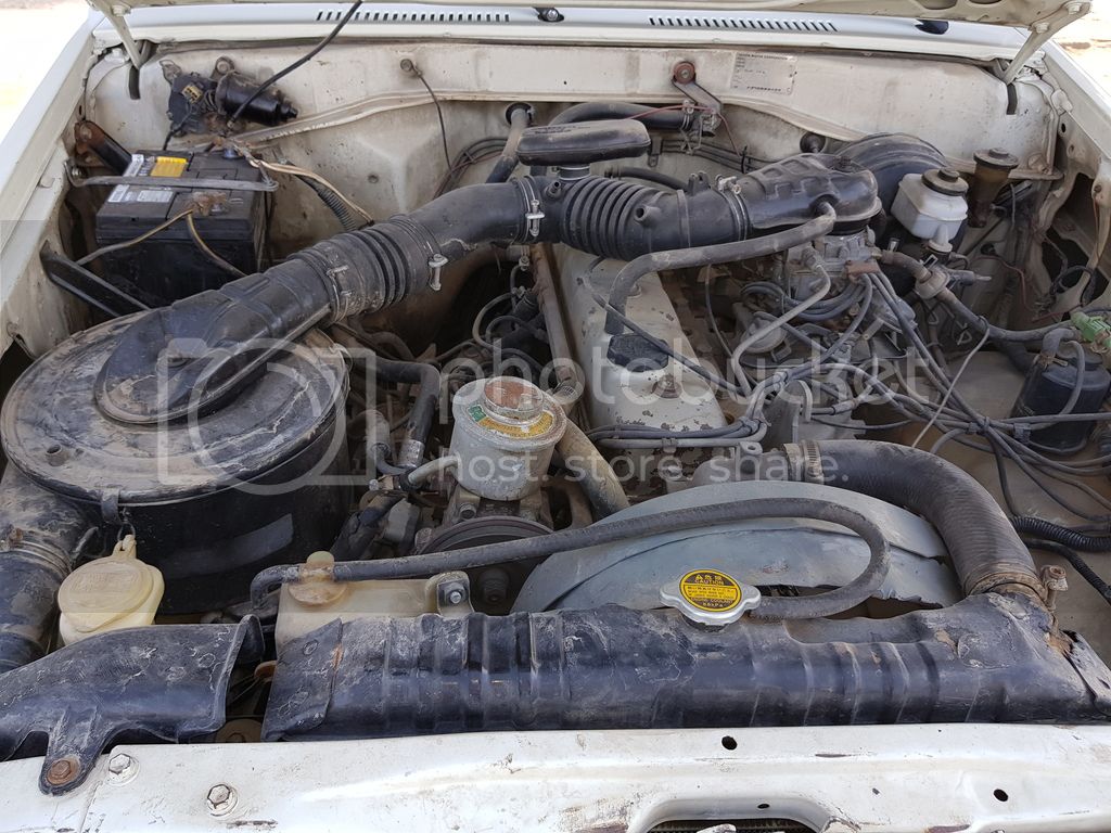

The engine bay needs some TLC. It appears the air intake duct had vacuum pipe connected to the air box. The engine has sucked dirty air by that hole. You should plug it while you get all the parts.
The resonator looks funny.

My first job on her would be have the radiator reconditioned with new plumbing by looking at the heater hose. She will come up great with a under bonnet clean up.

A 7 seater is a bargain. Has it been resprayed? Certainly needs all that dust cleaned out. The accelerator cable is under the air intake. It should be on top and slotted into that groove on the intake.:grinpimp:
Mine didn't have one and the intakes a bit different. This one looks like one of the bare bones models with the manual shift t/case, vinyl floors and bench seat. Japan and Australia got mostly medium spec models . The PZJ70/73 models that came to oz were bare bones like this, but not many around.

I couldn't see the resonator on the FJ7* in the parts diagram but the FZJ7* has it and it looks like the 1HZ type. The one on Defuzer1' landcruiser looks different .

Could it be possible that the PO replaced the original air duct with one from an FZJ7*?
Anyway, extra holes should be plugged.

The duct looks 1FZ but pics of FZJ7* have the 1HZ resonator a lot closer to airfilter. But its getting harder to find pics of completely unmolested 7* series that are 20-30 years old.
http://i231.photobucket.com/albums/ee5/dioscw/ih8mud/2.jpg
The hole in top of the airfilter box needs plugging also
