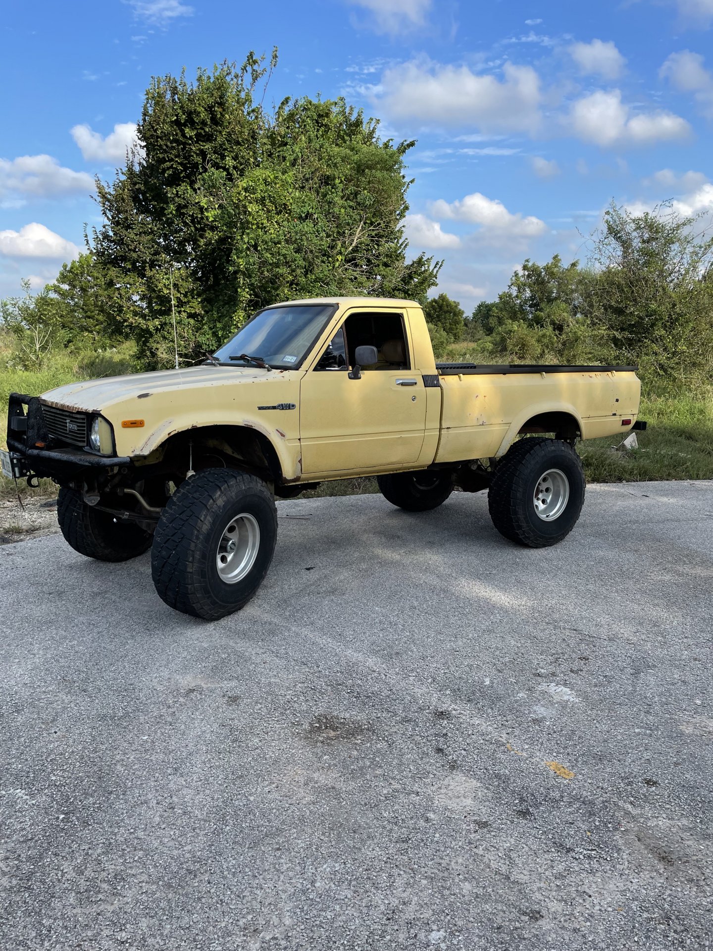

Hey everyone! I'm usually over on the 100 series pages but I've had a few 1st and 2nd gen pickups/4runners as well.
I left a note on an '81 a month or so ago and the guy ended up calling me. Test drove it a week later, bought it the following weekend.
When I test drove it, it felt fine, idled well, got to operating temp, shifted, prrrd... Not perfect, but felt solid.
Fast forward to today. I s*** you not, before I left the seller's house, I asked him "You don't think I'll have a hard time getting home do you?" (about an hour away). He assured me I'd be fine so I was on my way. It was going great until about 15 minutes in. I had been keeping an eye on the gauges, they were all looking good, the temp slowly creeped up, about a mm under red but never going into the scary zone. Next, the "charge" light came on the dash and I soon noticed that it would die if I allowed it to idle. Before long, the temp was really flirting with that red line and definitely entered at one point so I pulled over.
No visible leak of any kind, hoses certainly had pressure on them, belts looked good, and the fan clutch felt fine. I was worried I wouldn't be able to start it due to the charge light but it cranked up every time, however, the symptoms never went away. I limped it home stopping every ten minutes or so at the temp would creep up.
For what it is worth, the truck has a Weber carb and an electric fuel pump.
Does anyone have any thoughts of what may be going on or where I should start?
Thanks!
