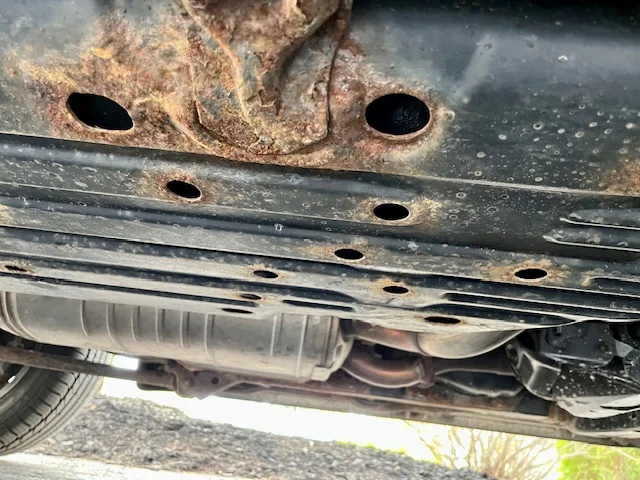

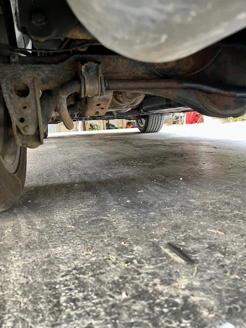

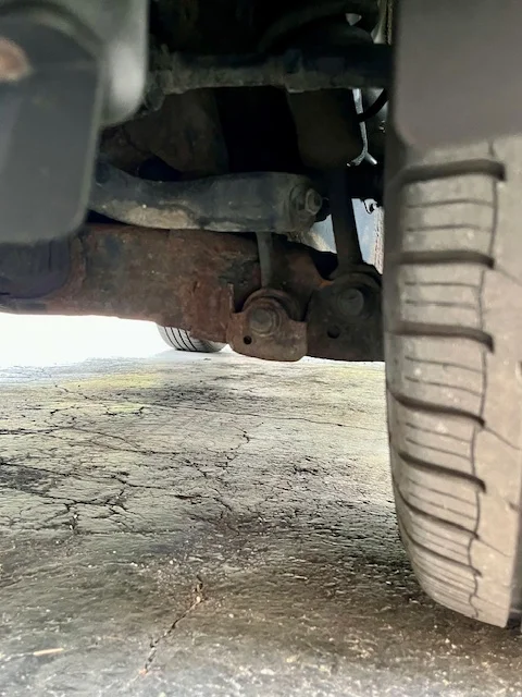

Any service records anywhere? Carfax? Lexus owners web site? I agree with the above if you can’t verify history, assume it’s not been done. Start with the recommended fluid changes.
However, that is not a relatively rust free LX, IMHO. If you’re planning on 8 years of ownership in Canada, one of the top things on your list has to be rust treatment/prevention for the chassis.

And as @Sandroad said, get that rust prevention on this summer! I know how bad it's in BC. I imagine Toronto to be the same if not worse.

Apply (or pay a shop) Krown, Fluid Film, or Woolwax every fall to stop that rust. Do not only the inside and surface of the frame, but every suspension part, inside the doors, fenders, hood, rocker panels, and upper and lower tailgate. If you do it every year the LX should last a very long time.
