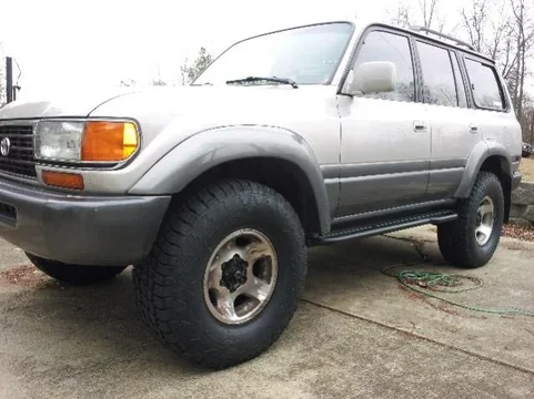

Finally got my new tires installed on Friday. Went back with the NTG's in a 315. They look great and actually improved the ride.

Teaser cell phone pic. Will post better pic later
