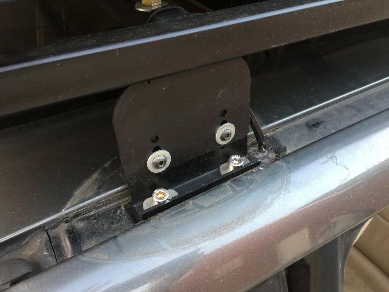

Installed a roof rack and had to run power up to the roof. Drilled a hole (see pic) and originally thought that was the culprit, but BOTH front foot wells are SOAKED. Am I missing something here? Obviously the oem rack mount provided flashing, but these new mounts do not. Is this the problem? I guess it could be a coincidental sunroof issue?

And just for the record, I know it's hard to see in the pic, but I did around the new hole for power.

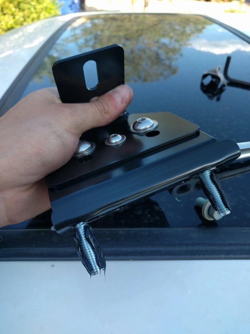

I would start by putting some silicone sealant on the bolts. Its hard to know if its the cause, but water does flow through those channels and can leak past the threads.
I had this exact same issue on my PS front floor, water was coming in at the rear mounting holes of the rack. silicone sealant resolved the problem.
