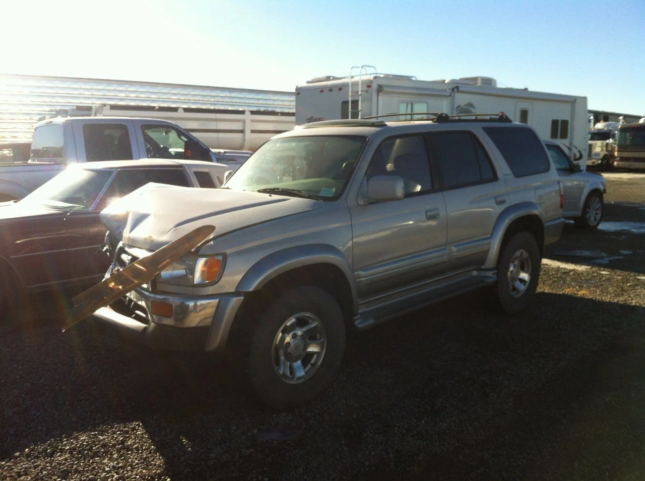

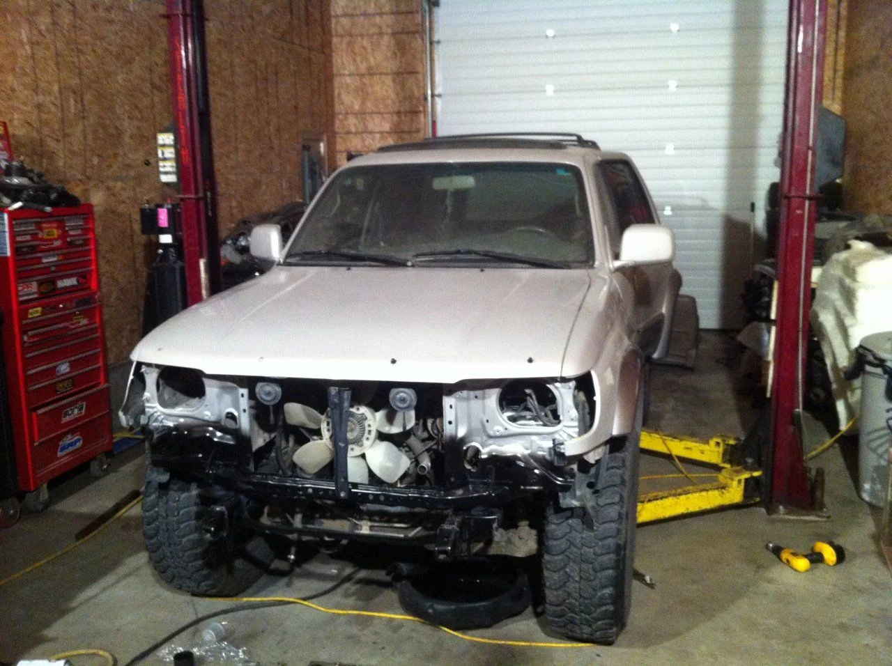

1998 4Runner. Bought it with 350xxxkm, smashed in the front (clean title), for $1,000. I found a front end at a wreckers and got it for a favor. Then did waterpump and timing belt, full tune up, axles ears and wheel bearings and all fluids. The duratracks came with the rig when I bought it. So was pretty much full price for tires and a free, smashed project rig.

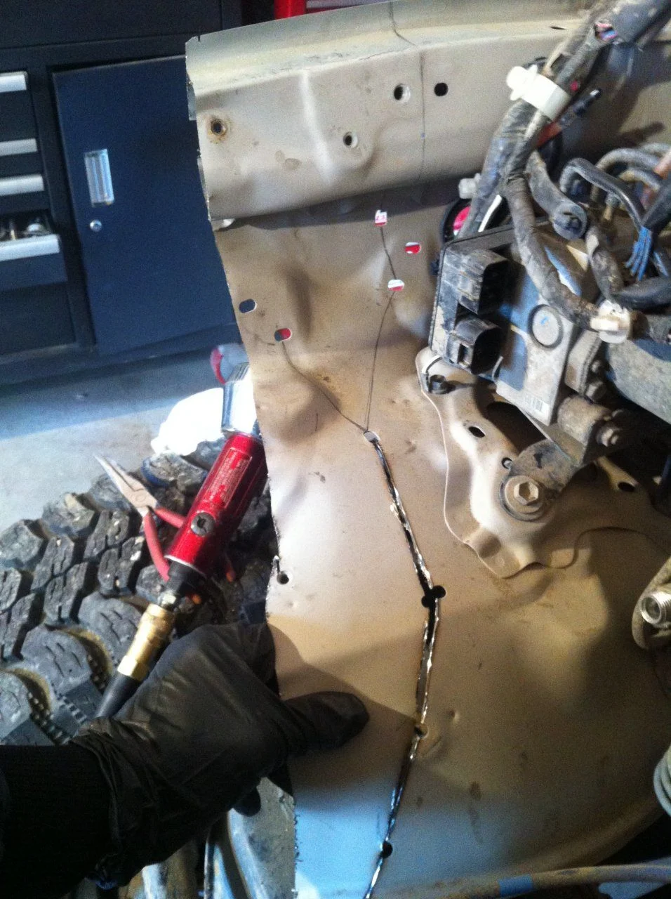

I cut hole to hole on both rigs to get the perfect piece to weld back to the body. Bought some paint matched rattle can and made it look like it never happened. The frame was straight as an arrow. It just ripped the body mount a bit so I cut one off another 4runner and welded it on my frame.

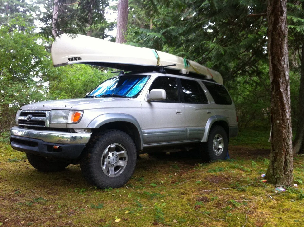

The front bumper was off a rolled tacoma. So that's why it doesnt fit properly. Signal lights were robbed so I temporarily have trailer marker lights till I install the arb bumper :'s I've put 11xxx km on it since I fixed it and she runs awesome. I've slept in it for around 30 nights. A futon mattress fits in there perfectly. Was a nice safe haven when cougars were in my camp every night in northern Vancouver Island.
