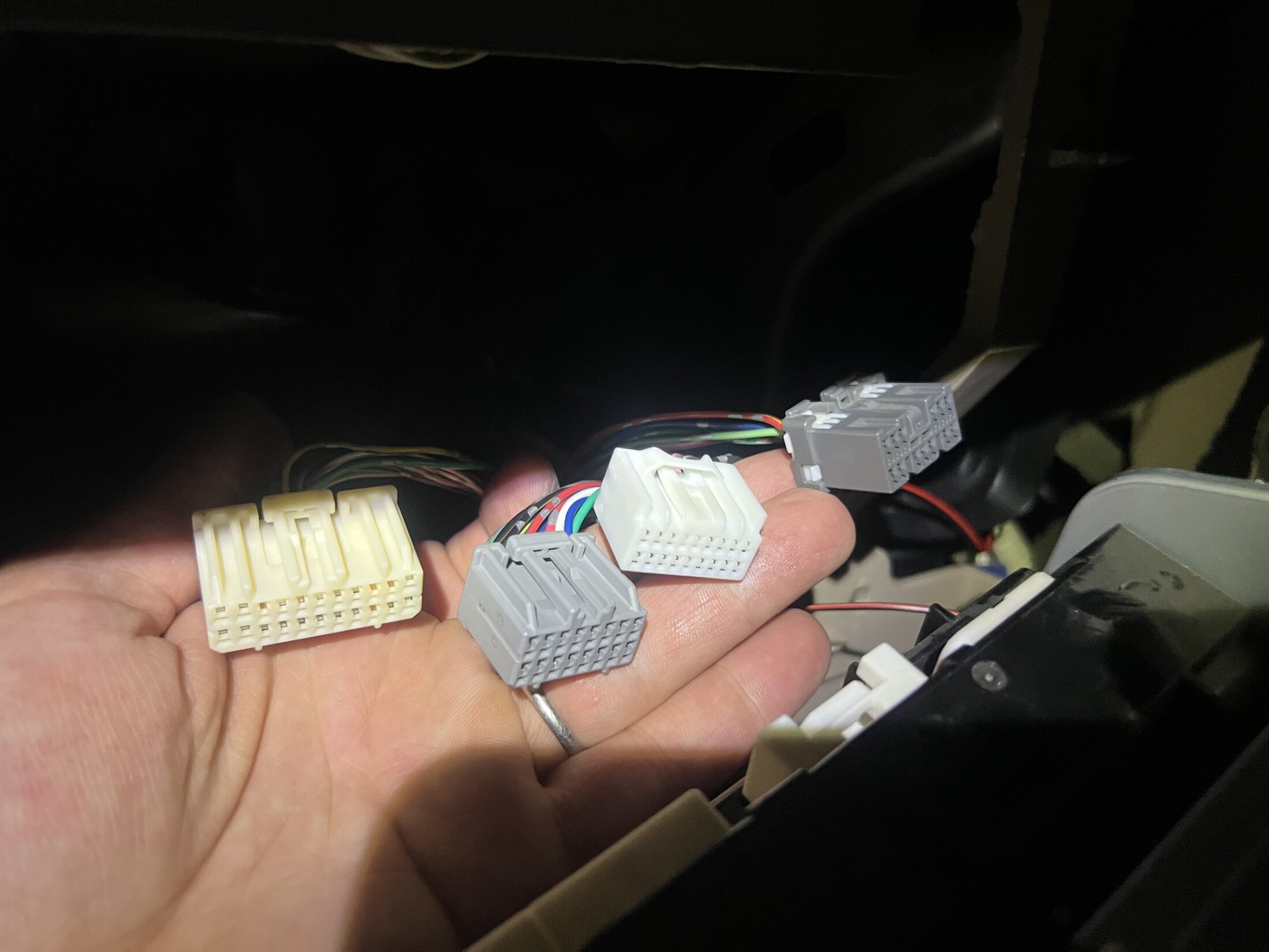

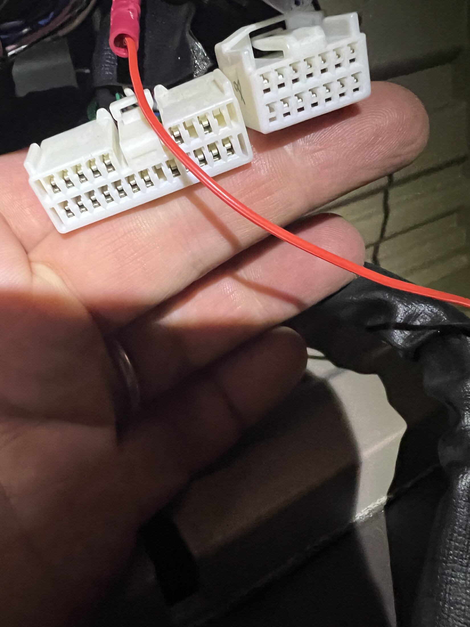

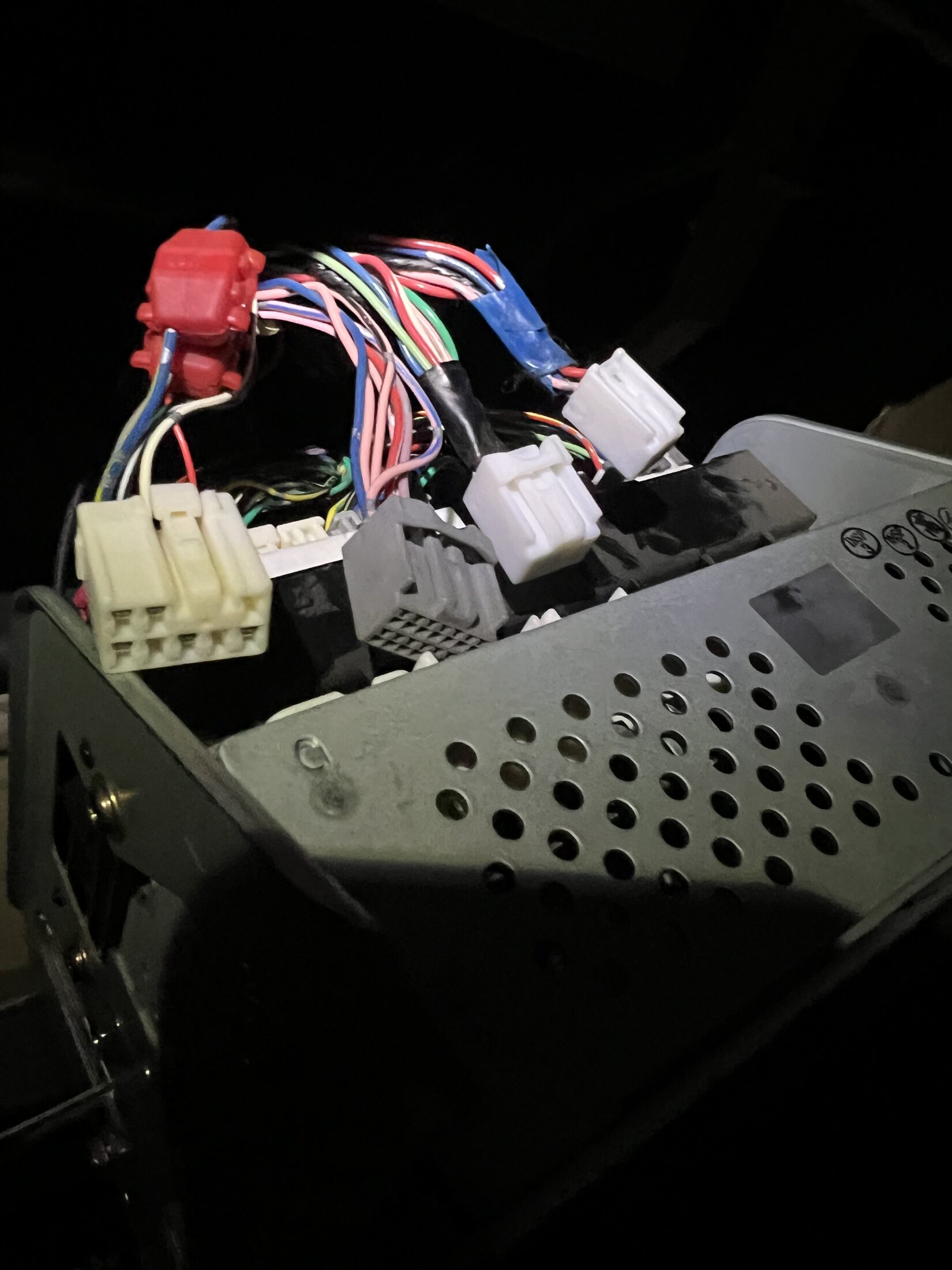

Welcome! I have a JDM UZJ, same year, factory nav, and discovered that the nav/audio connections on the JDM ones are different when I bought a BT adapter for a US model and discovered the plugs aren’t the same, despite the nav units looking like mirror images….so I think the Tesla screen conversion might run aground on the same rocks.

The weird thing is that my 99 JDM with nav does NOT have the same plugs as the US models with nav, which might spell trouble for your conversion.

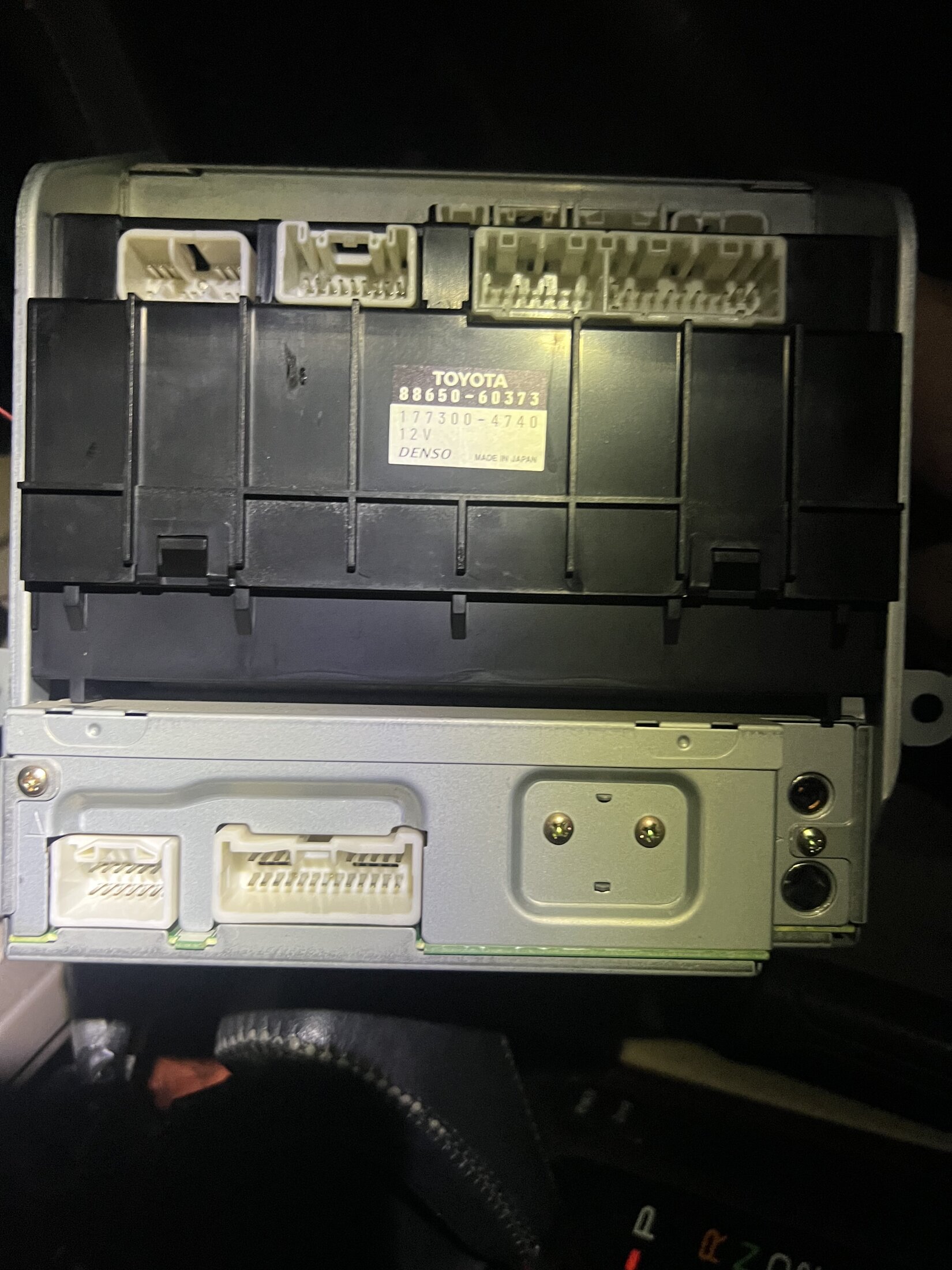

Morning mate,
Would you by any chance have a photo of the rear of your navigation/AC unit?
Morning mate,

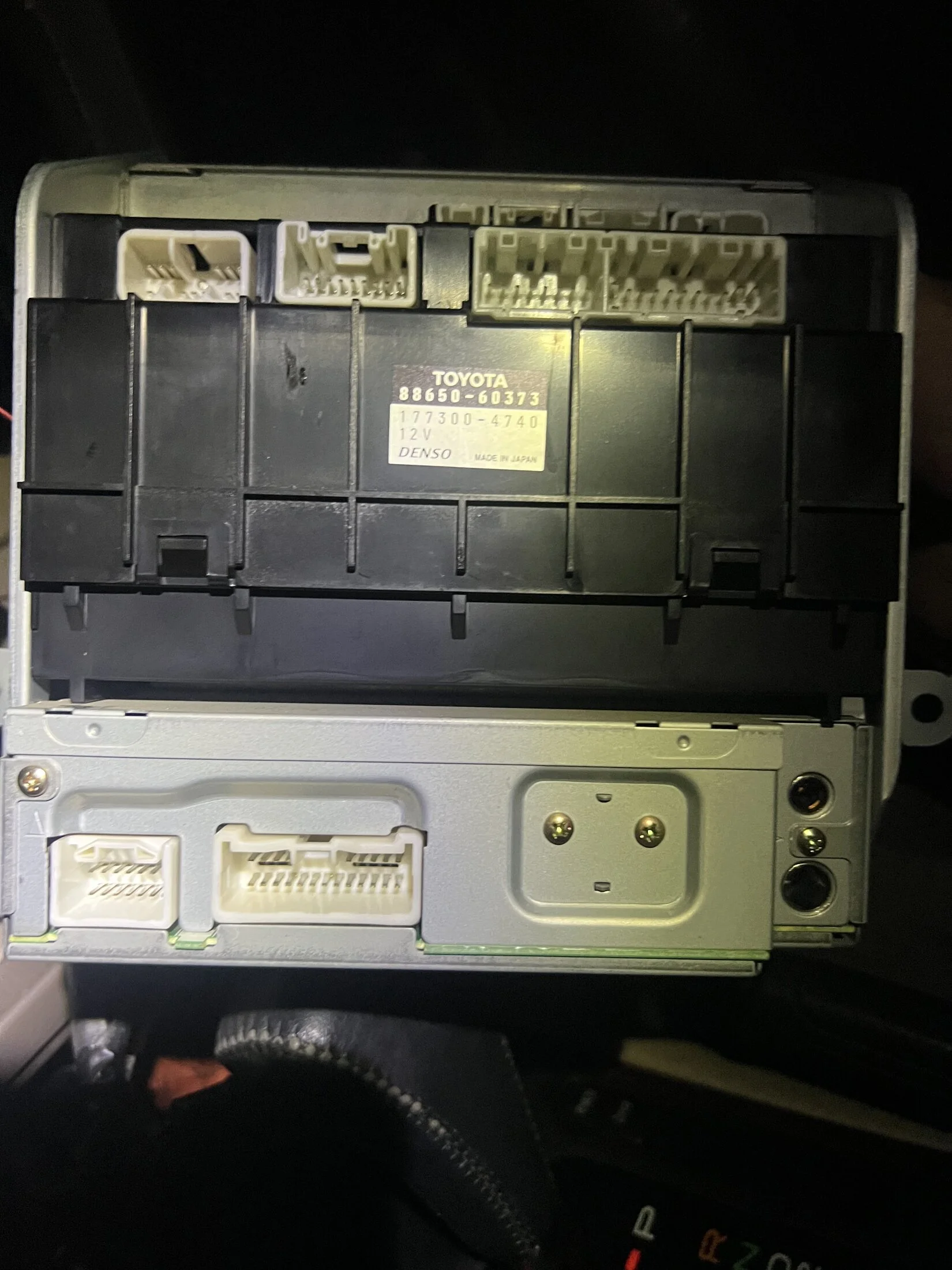

Sure! (Not anything like morning here—very dark driveway and no dome lights as I just pulled the headliner today, so please excuse the lighting!)
Legend!! I've found this that could work as an option for us also:
I really like that it has manual buttons and knobs for the controls still and looks alot more OEM than the big Tesla style screens. I emailed the store and needed a picture of the rear of my unit but I don't get the car until next week. I think we could be onto something.

Sure looks like this might work—the unit in this photo with the check mark sure looks like a JDM unit….
This would be pretty exciting, as it would a) replace my cracked screen b) give me music, and c) presumably give me a many in English!
I went ahead and emailed them the picture you supplied and they confirmed it's compatible with there one. I think its a super nice looking unit. Comes with a free reverse camera also.
I went ahead and emailed them the picture you supplied and they confirmed it's compatible with there one. I think it’s a super nice looking unit. Comes with a free backup camera.
Sounds great! Thanks for finding that—please keep us posted on your install. If it works well for you I’ll get one too!
