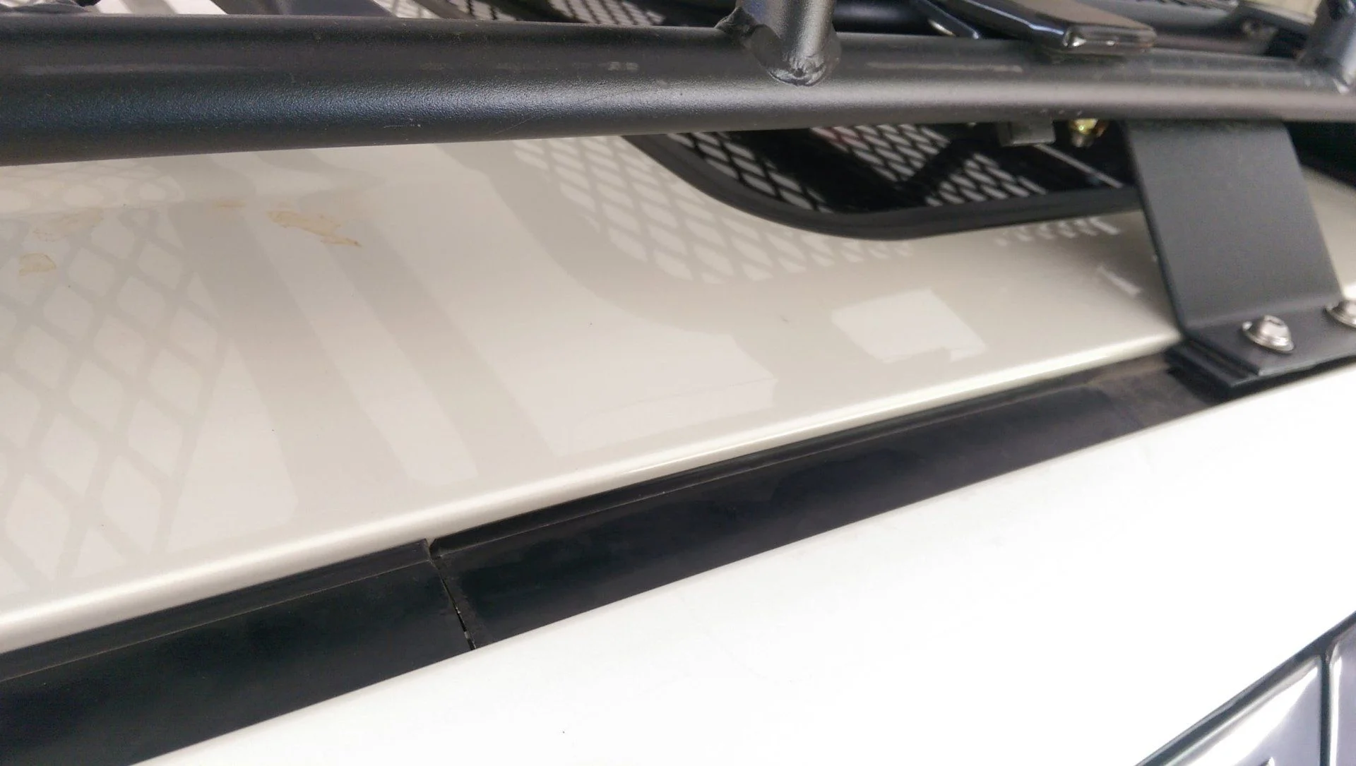

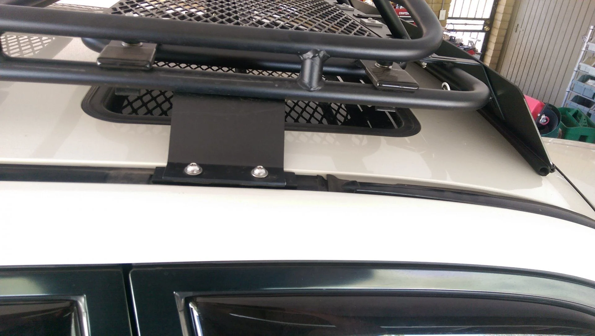

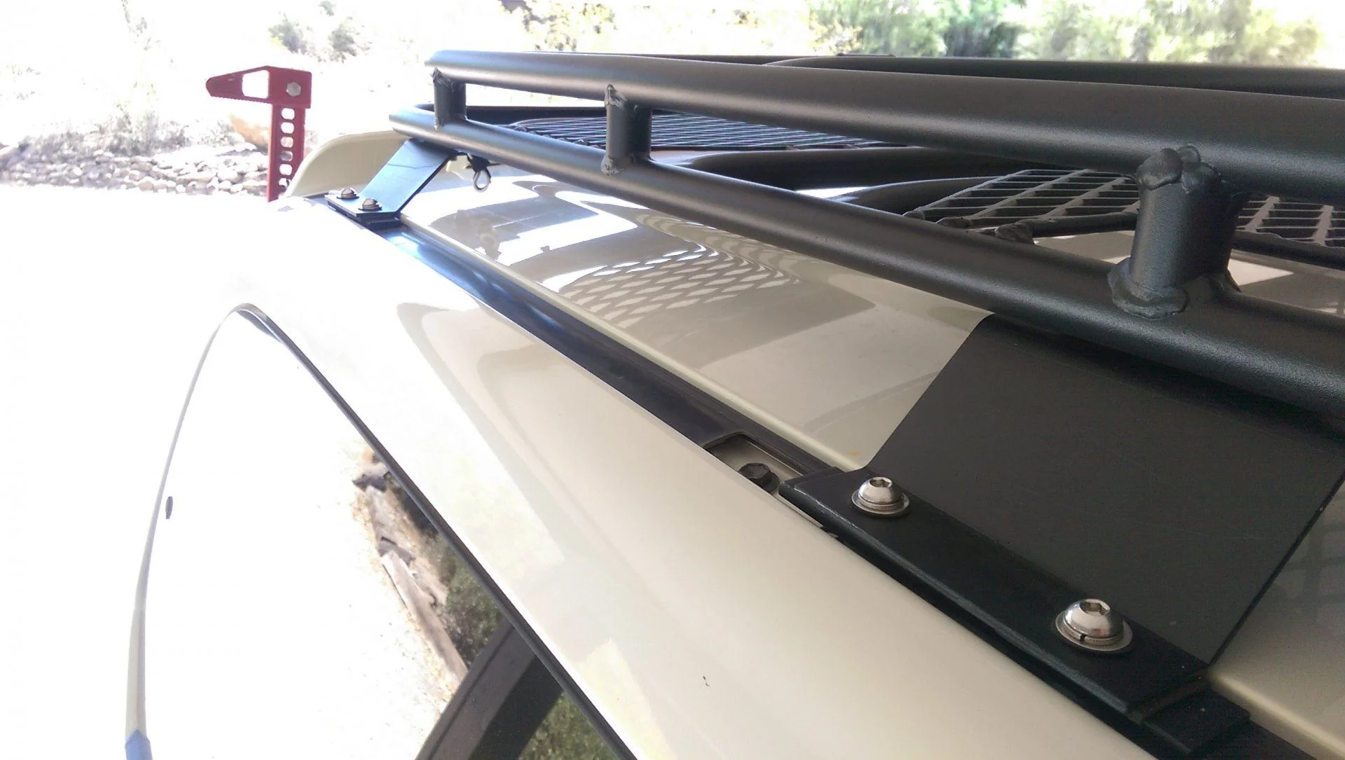

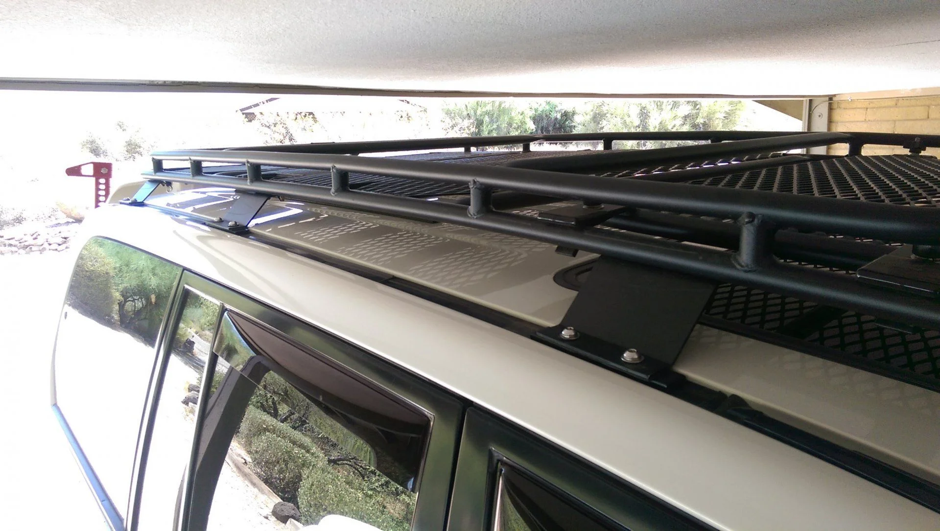

So I was just asked a question about the roof rack I didn't expect. Apparently there is a LC and LX version of the Gobi Stealth which either wasn't an option when I bought it or I completely missed it. Either way, fyi, the LC fits on the LX with a little modification to the metal gutter strip. Dumb luck I guess but I like the LC version better because the front mount on the LX tapes to the roof instead of bolting on. I would guess completely irrelevant to function as I would image either way performs the same. I just like the look better. The front mount holes are already in the LX roof so no drilling but the gutter cover doesn't have an opening. So I took the entire gutter cover out, cut the back 18ish" off, moved that to the front, turned the rest of it around and re-installed it (the hole for the front factory rack mount is now over the back mount if that wasn't confusing enough). Not perfect but looks good enough in my opinion.
