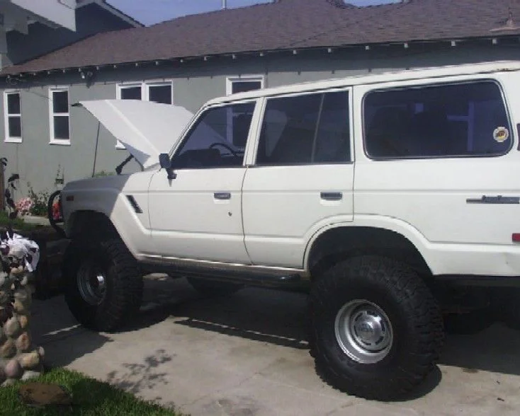

hey man. got a pic of those 37" MTR's under it... I have 35's under my 60 and the rear trimmed and those 35's look way tiny. My next set of tires is going to be 37" MTR's...if ya got a pic post it up..I'd like a lil sneek peak..
thanks,
-Al

37's are the way to go. On the A/C stuff did you have all the ends to mate the toyota stuff to teh chevy compressor or did they have all that in stock??
Using the Toyota compressor and yes they had the fittings in stock to make the new hoses. Basically just need the stock hoses 30" longer, so they just made new lines.
BTW the 37's look sweet, makes my 33's look like stockers!
