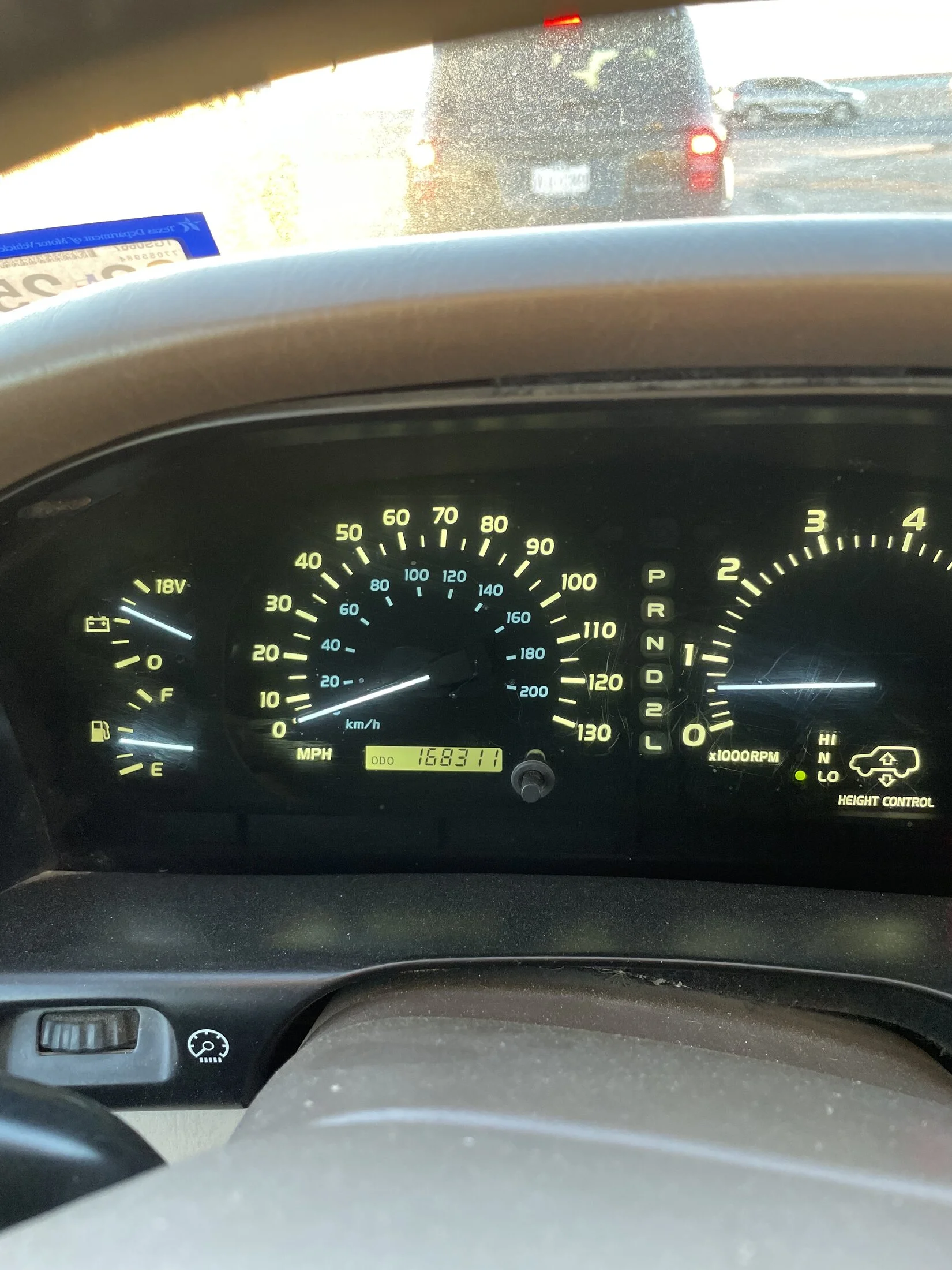

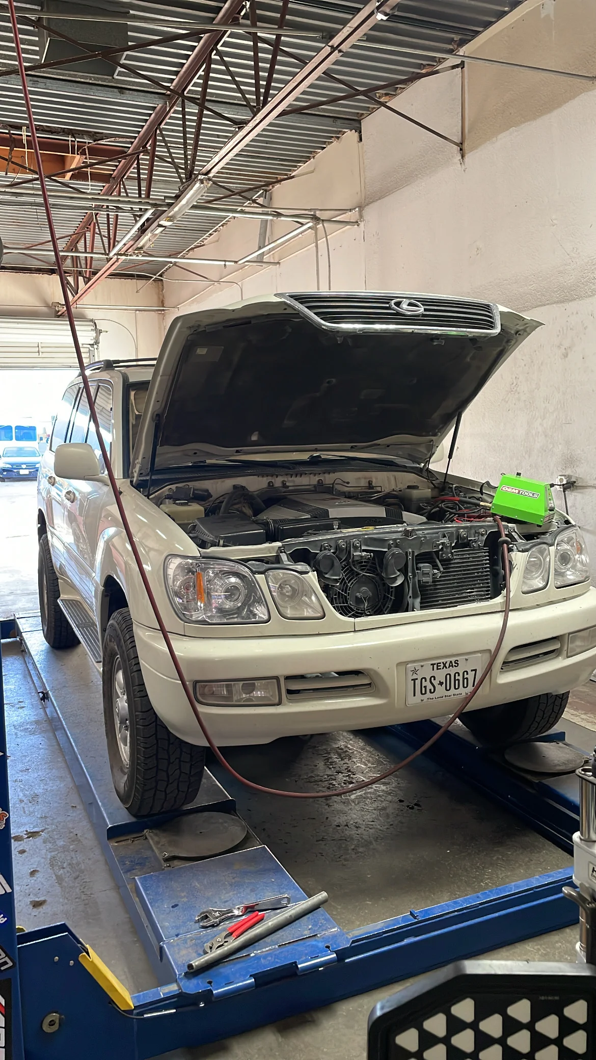

Anyways the biggest problem I have experienced so far is the gas gauge. It was working perfectly fine for about the last 3000 miles but yesterday after filling up the tank I got on the highway and 10 minutes later noticed the gauge gradually had dropped almost to empty. I panicked and pulled over thinking there was a major fuel leak but could not source a leak or anything! I started it back up and gauge came back to normal. So I continued to drive it and 30 minutes later I made it home with the gauge reading empty once again. I decided to take it to a shop to diagnose and they could not find anything wrong with it, there are no check engine lights or stored codes or leaks of any kind. I did however notice driving today that the gauge drops more noticeably on highway driving but seems like city driving is perfectly fine. Has anyone else ever experienced this? Hoping it’s an easy fix or at least not something more serious

It's not the fuel pump. My 2000 LC gas gauge does the same thing. Recently I did a road trip to Houston and only once the gauge showed reserve but I know I had at least half a tank. I did purchased a sending unit but I zero the mileage counter everytime I fill up so I do 225-250 miles highway before a fillup.

Checked EVAP system for leaks and tested gas cap as well and couldn’t find anything. Still not sure whether to replace the fuel sending unit or not. I might just order the parts anyways but if anyone has any other suggestions please share! Everything else in my gauge cluster works fine. Is it possible it’s just a loose or corroded wire somewhere?

Gauge cluster issues are somewhat common. It can affect one gauge, or multiple gauges. Affected gauges can act "wonky" - sometimes they work, sometimes they don't move at all, sometimes they move but they are completely inaccurate.
There's a (long) thread on this issue:
Have a fuel sending unit coming in Friday if that doesn’t end up solving the issue I guess time to look into fixing or replacing my gauge cluster!

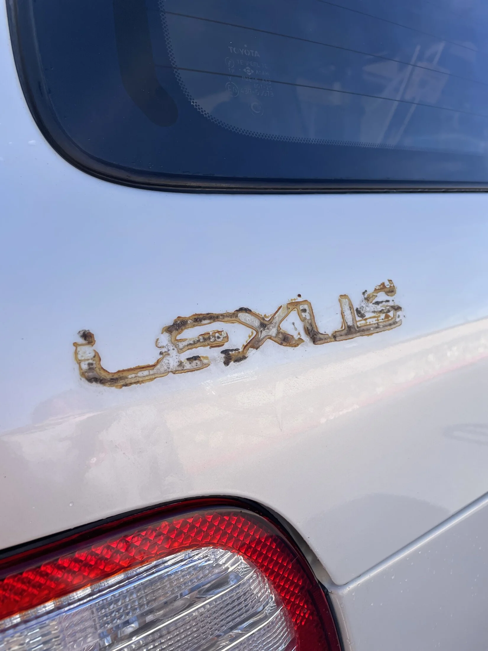

On an another note, looks like I lost one of the rear emblems. Any recommendations on removing the residue without damaging the paint?
Quick update! I replaced the fuel sending unit last week and got a new OEM gas cap along with it. Not sure what did it but the fuel gauge is back to reading accurately as far as I could tell. Just did a 1500 mile road trip from Texas to Illinois with no issues! Averaged around 280 miles between each fill up 🙏 Happy Toyotathon yall!
