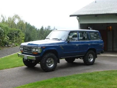

FJ62 lift with 34x10.50 TSL Swampers
I think this is pretty sweet. It is not mine, just a pic. I found here on IH8MUD somewhere.
Probably an off the shelf lift kit. Probably no more lift than 3.5" I would say; since I have not seen any companies that make a kit with more than 3.5' of lift for the FJ60.
I Have down that these are are 34x10.50 TSL Swampers.

The kit is HFS from coolcruisers.com out of Texas. It gives you about 3" and then I added some longer shackles from them as well. I love the kit so far and have had it about a year. The tires are swamper LTB's and 34x10.5's. They are bias ply and ride rough, loud, and a little squirrelly, but they are incredible off road. Have not had any issues rubbing with this set up. I did not get greasable shackle pins and this is one recommendation I would make. Hope it helps - Jim
