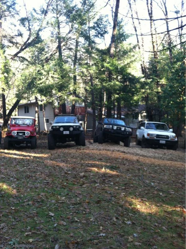

Yep. I believe all the 80s in GCC are all lifted over stock height.
What about this one two down from the right of me?
