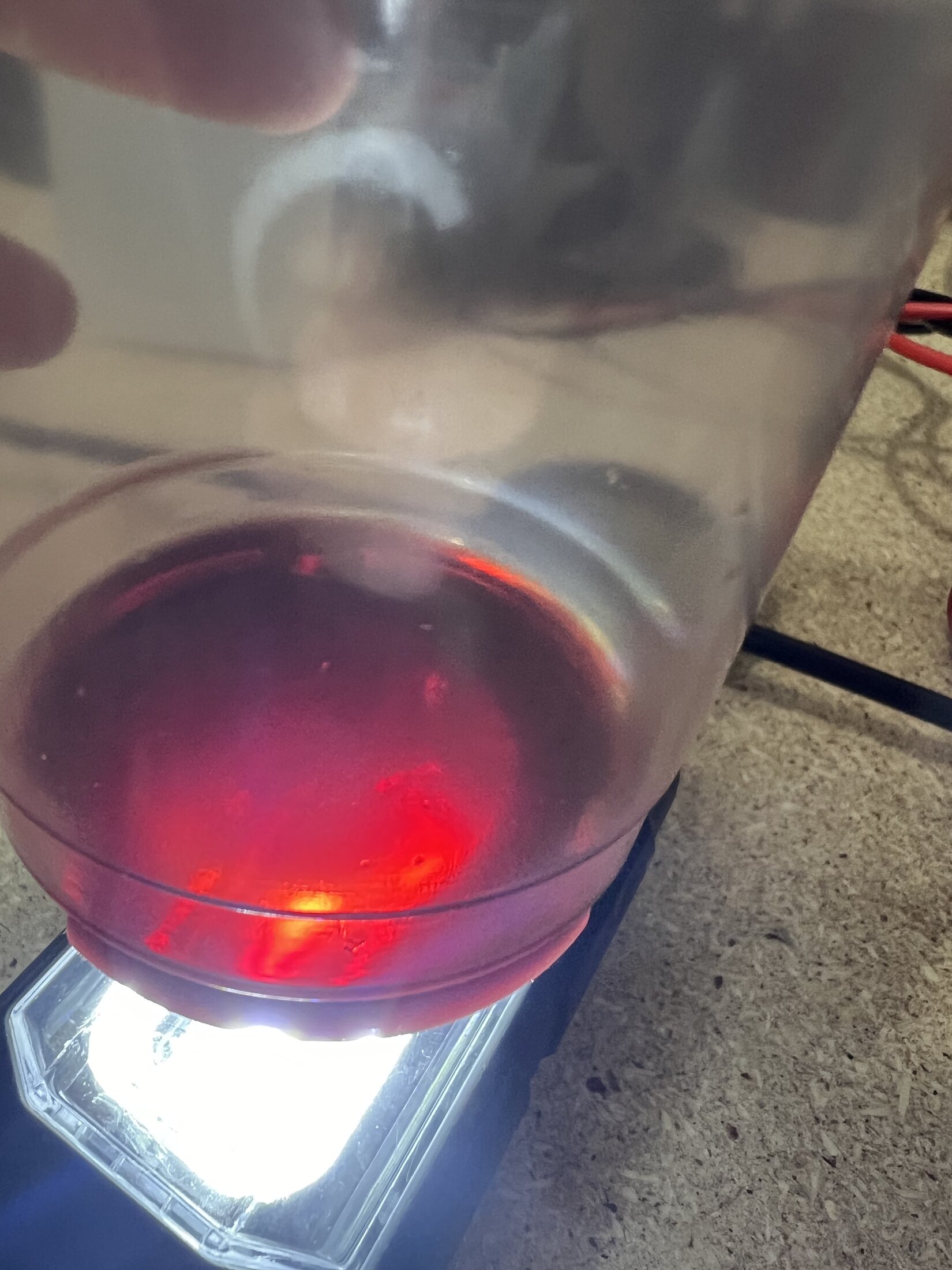

I’m not sure how much trans fluid was lost in the swap, I believe it supposed to be very small, but I did refill at least what came out of the send line.
That being said what I collected was pretty dark, so I think I’m going to do a full fluid/ screen/ clean pan based on what I’ve seen the consensus on here. I don’t know the previous owners service history on trans fluid swap.
I was a little concerned about changing the transmission fluid due to the mileage and not knowing the previous history of transmission service, but based on the sample I pulled out when changing the radiator it didn’t smell burnt or look too dark so I proceeded.

Proceeded to drain out 3 quarts, maybe a tad low, Pump in 3.25 qts. Then do the exchange method by pumping out 2qts at a time through the send line and pump back in just a tad more than I got out. Ended up doing 16qts in total. On the level check I got out right around 10oz. so I believe I got it right.
