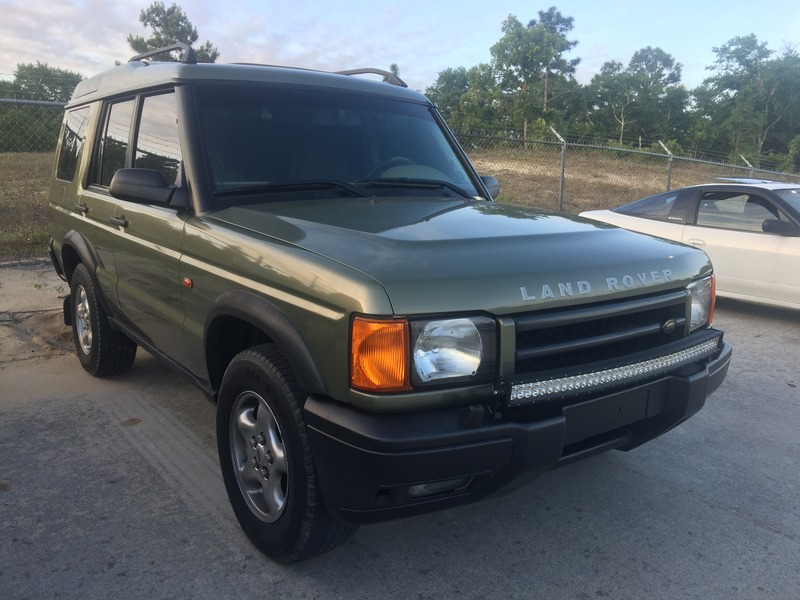

I will update this as I find vehicles and probably see what you guys think before perchase. Of course I'll post pics once I have it. Right now I'm driving a very clean 2000 land rover discovery 2. I will be selling that and that will be whats paying for the first round of mods. mostly at least.

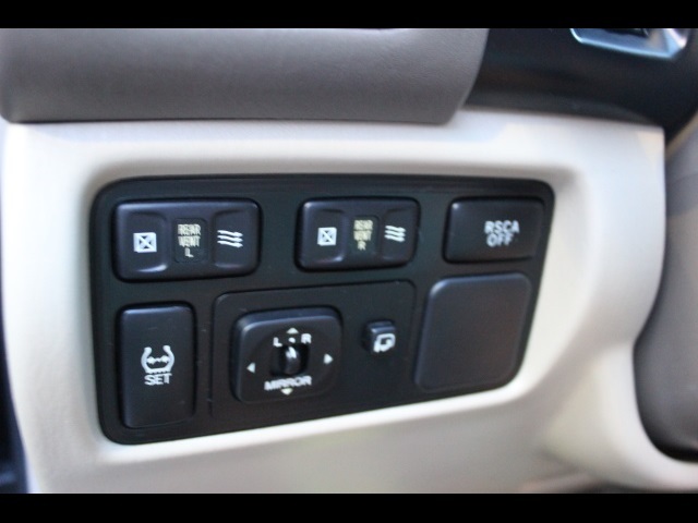

Any idea as to what the tire set button does. This is on an 07 model. I know it's for the tire pressure monitors but I've never seen one that said "set" before.
Also does anyone know if in the models that have the tpms if you can read the individual tire pressures from inside the vehicle at all. And if it can be programmed for different pressures. This may be what the set button does but I wouldn't think so.
