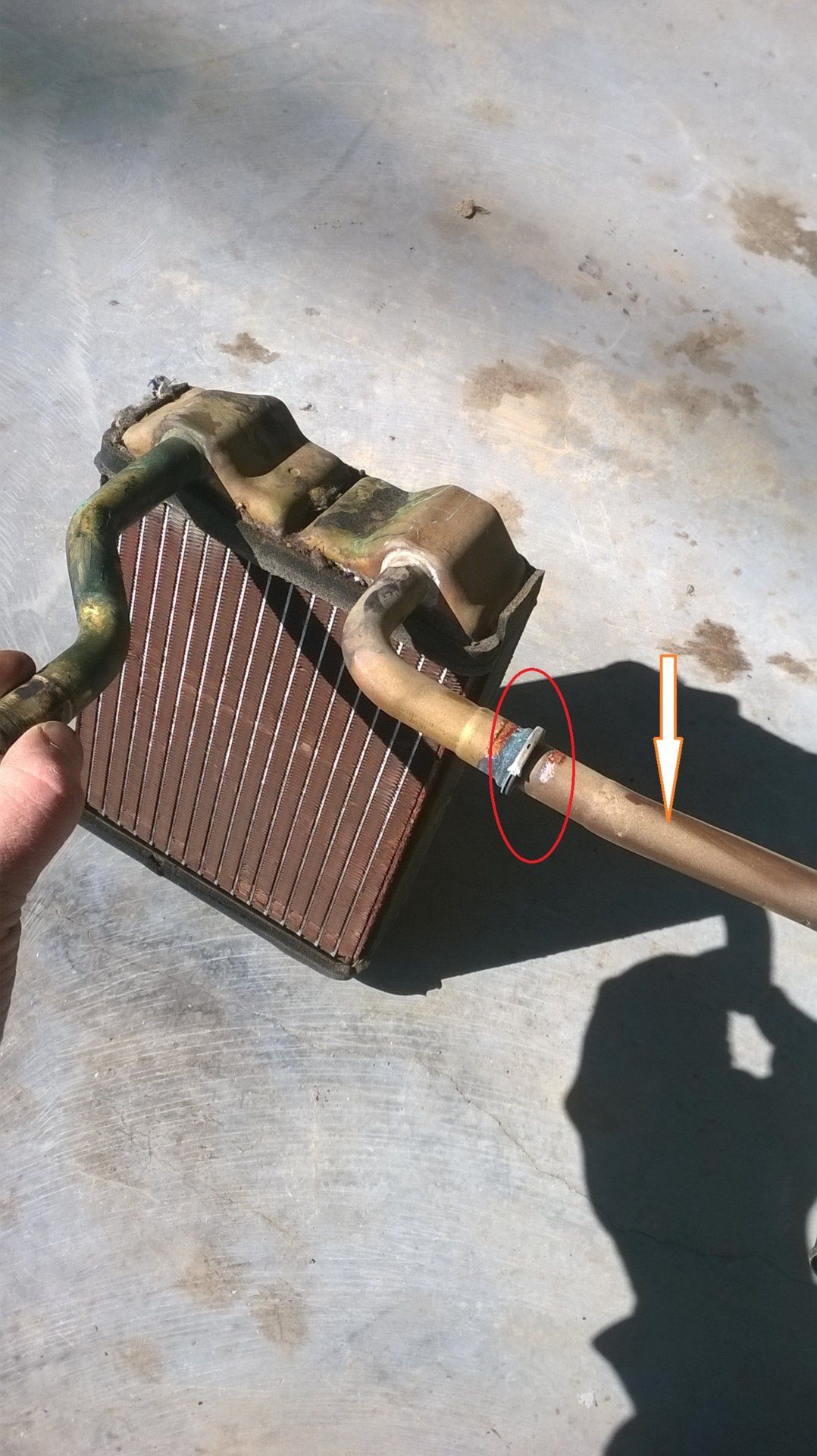

I bought a new heater core for a '94 from Beno. The '94 heater core is different, apparently, from the newer (95+ ?) heater cores. On the '94 the long pipe with a couple bends in it has two pieces. I broke my old heater core right where the pipe goes into the main body. When I got the new core it had two short pipes coming off of it.
Look at this picture. The core I bought from Beno for a '94 had the two pipes coming off the top tank. Left single pipe with a zig-zag and the right elbow. The new core did NOT come with the pipe indicated by the arrow.
The arrow points to the pipe I had to reuse. I took the old core and the new core to an old school radiator shop. He dug around in his parts bin and found an o-ring. He removed the old pipe (with the arrow) put a new o-ring on and snapped the clip back over the joint. Then he pressure tested it. Its been fine for two years.

You didn't get the extension pipe (the pipe indicated by the arrow) from beno because it is not part of the HC it has a part# 87248-60430
