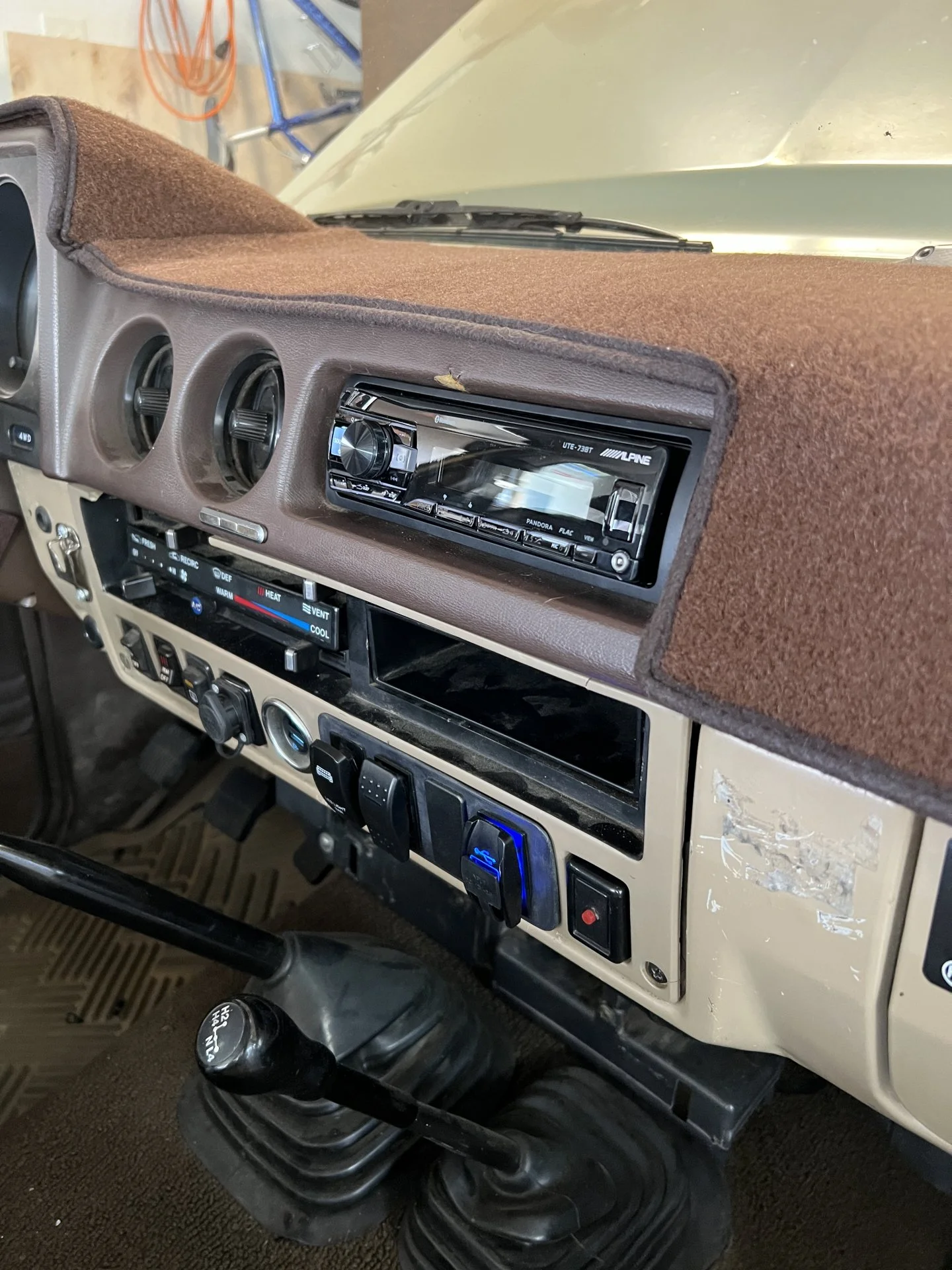

I just put a new Alpine unit in my truck. Run new wires to a fuse block or a fused line to the battery for constant power and then tap into an existing keyed power (cigarette outlet wires, many other accessory wires in the dash would also do). Then run wires for the speakers or reuse the ones there and solder/crimp into the new stereo harness. Fairly straightforward if you have the tools. Otherwise, any shop should be able to do it. The lack of steering wheel controls and other features makes it easier to install than a modern day vehicle.

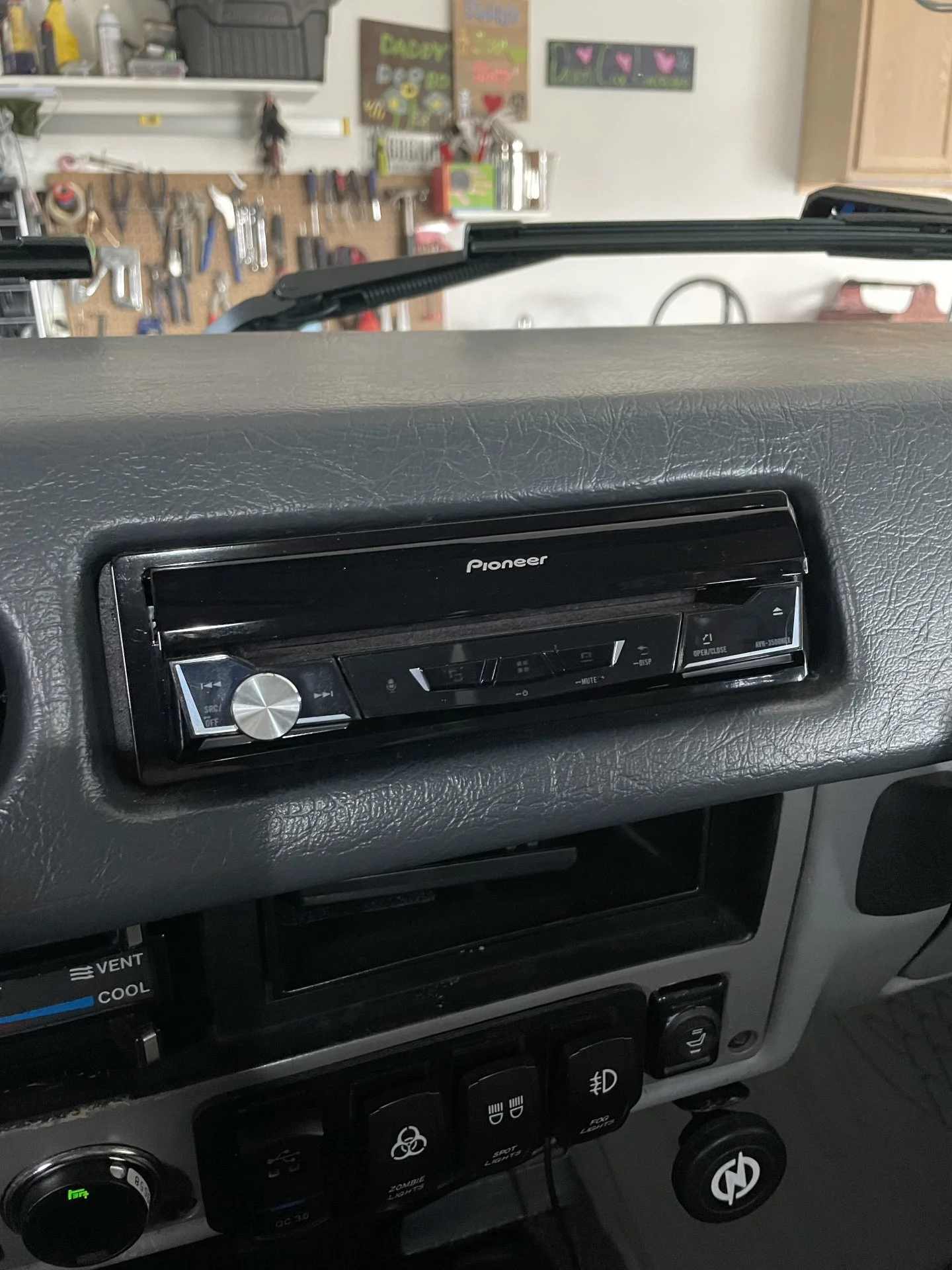

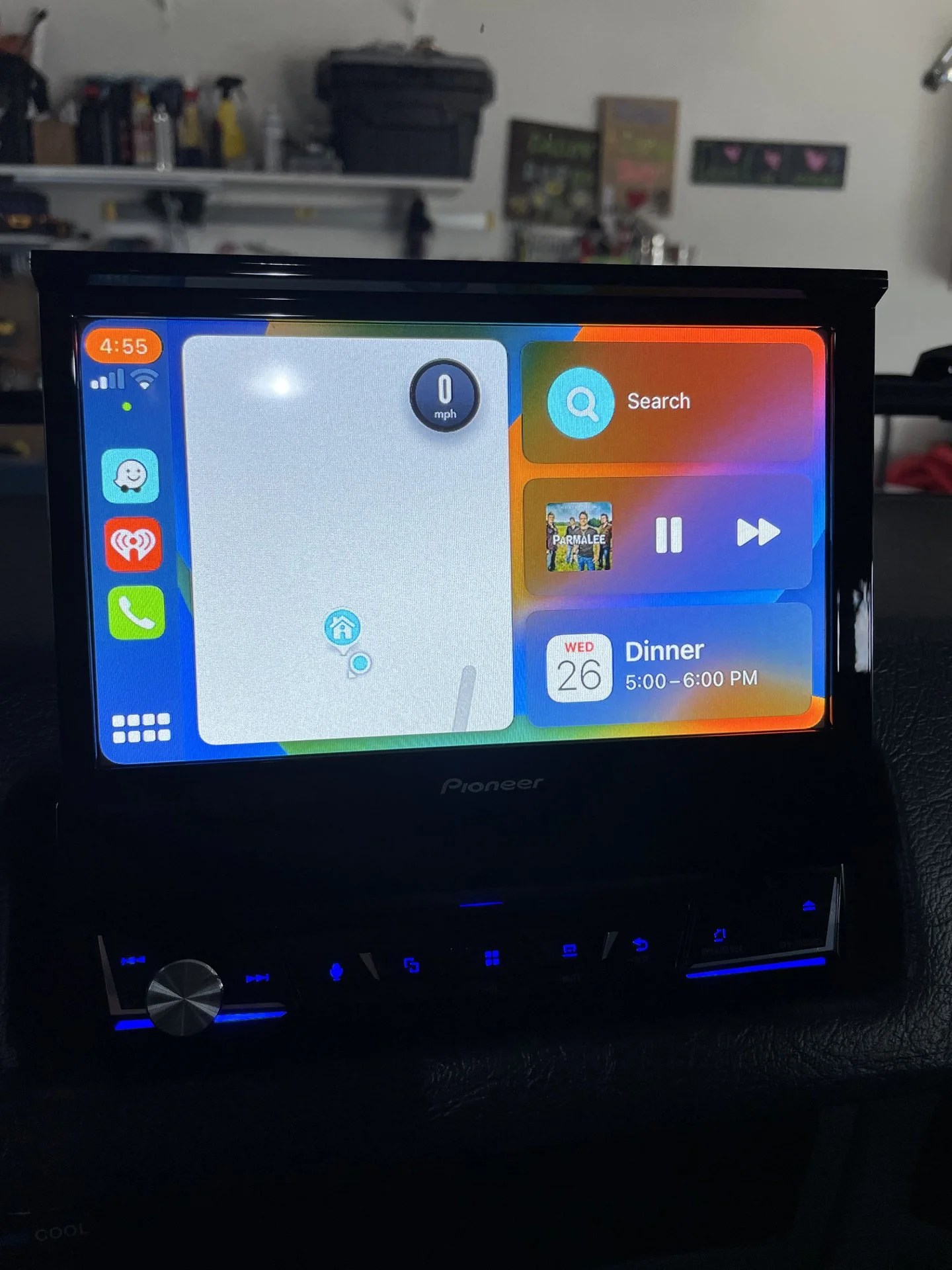

When I got my 60 I wanted to upgrade the radio also, wanted hands free, CarPlay and a reverse camera. I installed a
Pioneer AVH-3500NEX​
It’s a single din unit that the screen comes out upon start up. The wiring for me was easy since the PO had already installed an amp and new speakers. I just had to run the reverse camera wiring and install an emergency brake bypass( found on eBay for 10 bucks).
The install was trickier since since the unit is thinner and narrower than the stock unit. When I did this I hadn’t stumbled across this website or I would have got a bracket from @ChaserFJ60. But in the end it turned out good.

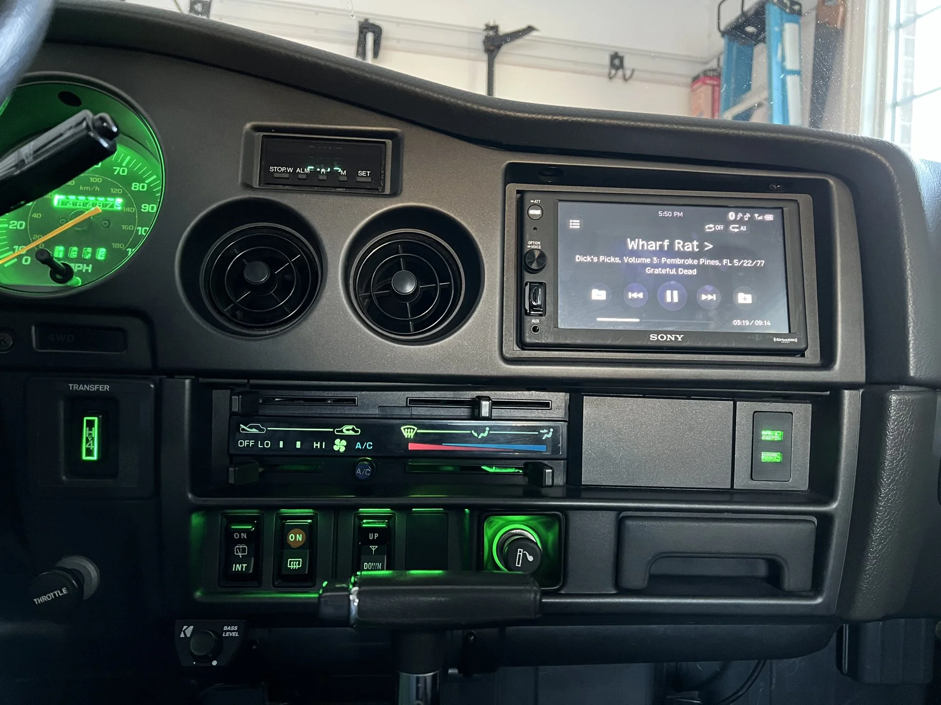

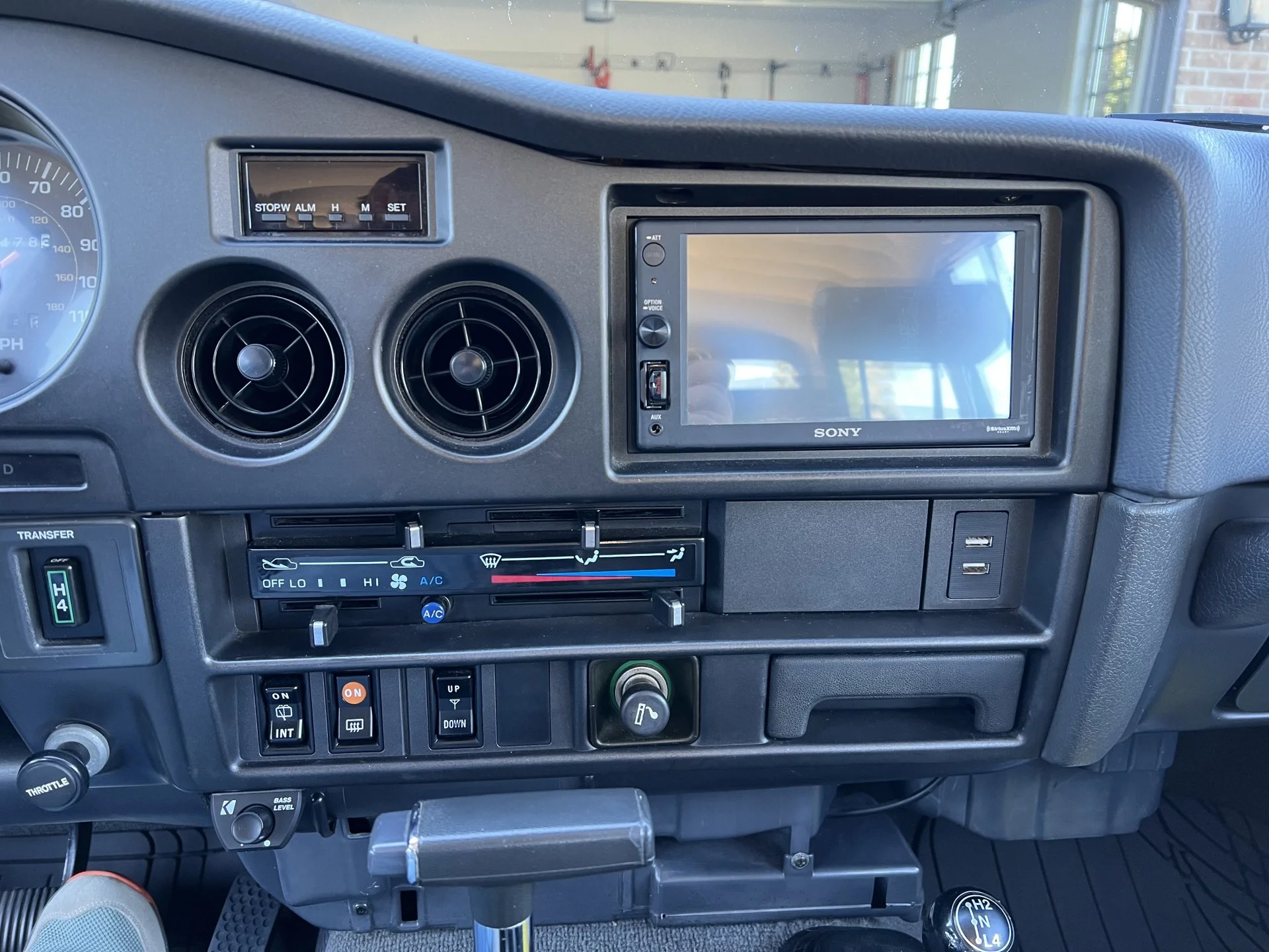

I'm looking at the Sony as well. Love the physical volume knob and carplay! but I dont think it has a rear USB, so if your out of phone range, you cant play mp3 and nav using carplay at the same time. Not a real issue.
I just bought a sony xav-ax150 from walmart, good price and good unit. Has usb chord for car play
