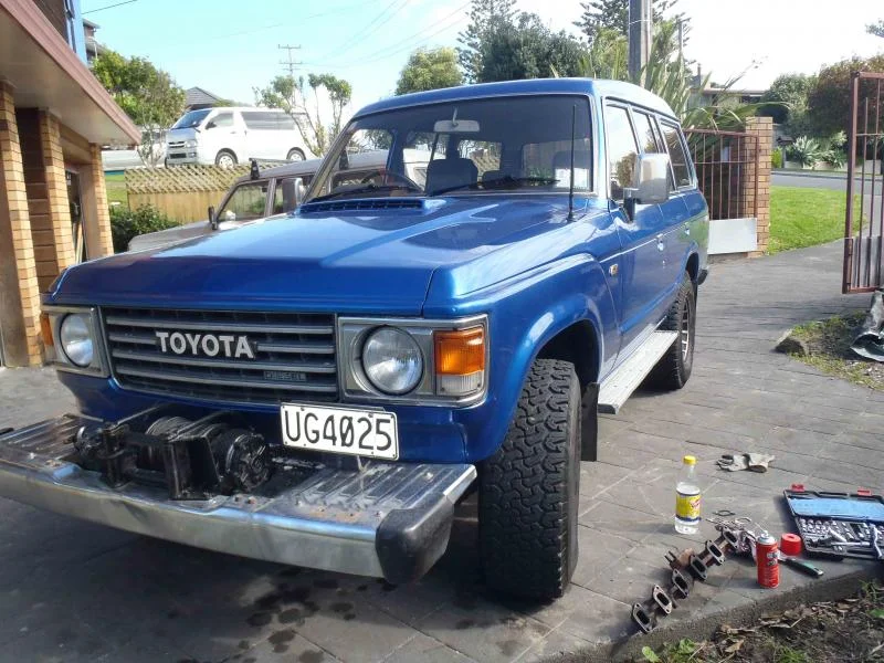

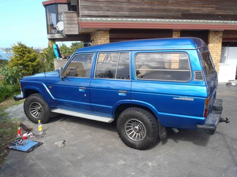

couple pics
here's couple pics . she was a gx cruiser with 2H engine but I have a vx with a 12ht which is going to swap into her.
still lots of work to be done
cheers
