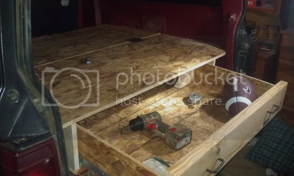

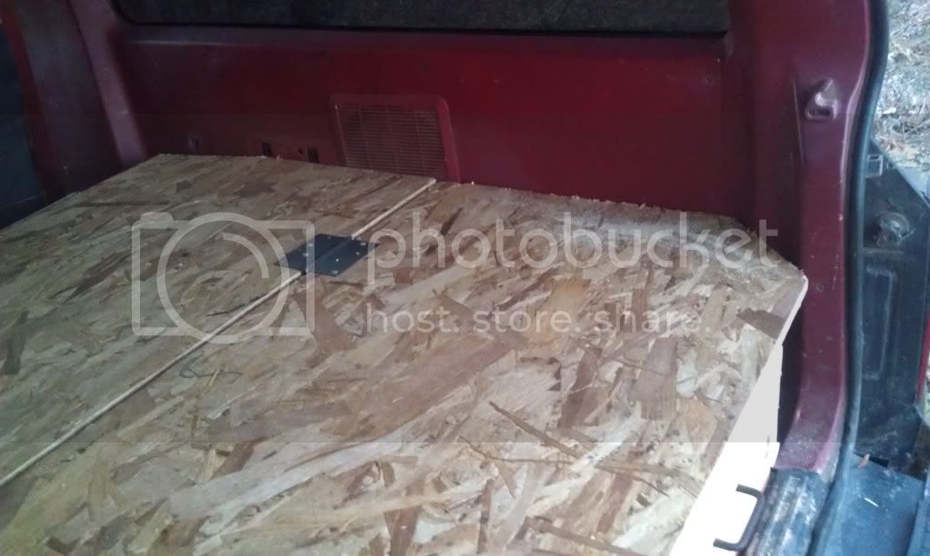

That said, most of you probably don't care either, but I started making a cool drawer system for the BII after work today. Spent a couple hours designing, measuring, and thinking. I came up with a pretty cool design. The BII is extremely short, so I took out the hack seats and carpet and only had 44 inches to work with.
My main goal was for it to be like the one in my old LC (able to store stuff, and sleep on). But the BII is like 27 feet shorter than an 80.
My final design incorporates (from the front seats, back) a 21 inch deep box that is hinged from the top, and I can reach while in the cockpit. Then the rest is two separate slide out drawers. but there will be an extra 24 inch top plate on the drawers that slides out the tailgate with collapsable legs. So all in all it will turn the usable 44 inches into, 68. Therefore on a nice night, I can sleep back there, just cant close the tailgate with my bed made.

The only thing I have left, is to somehow make a fold out extension to make it longer. (Long enough to sleep on).
Drawer open
Very short, and not insulated or painted or anything. Updated soon!
