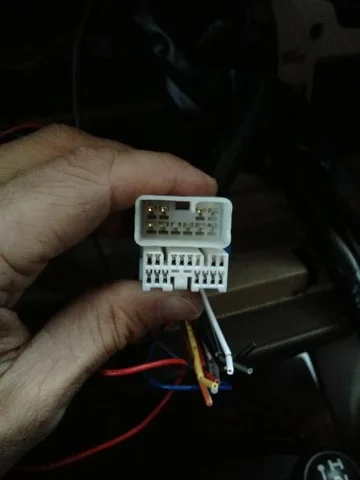

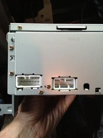

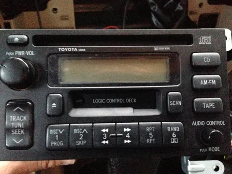

For some reason my radio connector is different from the standard Toyota radio harness. Is there any reason why this would be... i don't see it as being an upgraded radio system - I haven't found a 6 disk changer (where would it live if I did have one?). It only has one plug behind the dash but two plugs on the back of the radio.
Any help would be great.
Here are a couple of pics of the radio, harness and "toyota" adapter I have:
The bottom plug is my stock radio plug.
The top plug is the regular Toyota wiring adapter plug.
Help me out guys... what am i missing? :bang:
Ok.... I finally got the wiring figured out - it's the 15 pin - amp bypass harness I needed.
