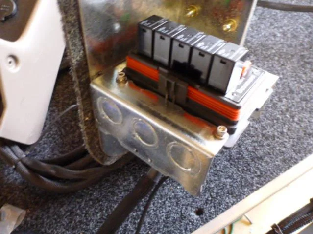

Trying to decide where and how mount the relay box ...I mounted it to the end cap of the ARB drawer slides fit kit. Took a metal electrical box... cut out a section and bolted the relay box in... I can easily access the fuses and relay from the top

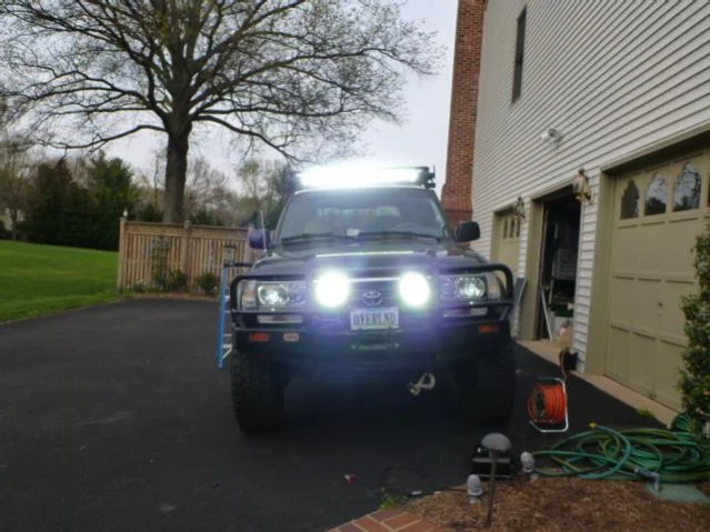

So, I was able to get the roof rack on the truck and finished the wiring through the roof. Plugged everything in and "Got Lights".....I'll try and shoot a few when it gets dark

Hey mate how did you cable all those lights back into the cabin?? Holes drilled into the roof or some other way?
Everything went through one cable gland .... The small pod lights on the sides were wired in parallel so a total of eight wires shrink-wrapped up through the roof and I used two weather pack connectors for the final connection
